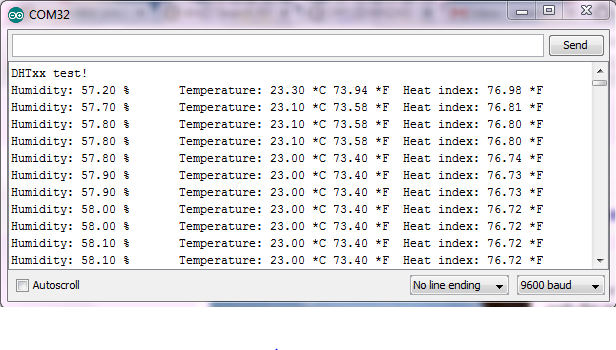

Step 2: DHT22 Temperature Humidity
This tutorial will teach you how to read temperature and humidity readings using the ICStation DHT22 Temperature & Humidity Module.Once you have those readings, you can calculate neat things like Heat Index and Dew Point, and by adding a wind speed sensor, Wind Chill.
