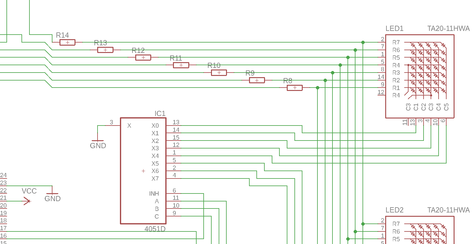

Hello for everyone!
Just uploaded a schematic on the GitHub.
In difference with my original design I added few p-channel FETs for increasing LEDs current.
I edited Arduino code for new schematic too.
