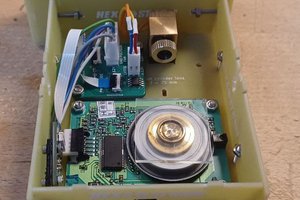

  • 1 × Nokia 5110 LCD Screen Available in surplus from most good electronics websites
  • 1 × Nucleo F401RE Development Board A nice cheap STM32 dev board
  • 3 × 680nm laser module For detecting clear plastics and glass
  • 3 × Light Dependant Resistor (LDR) For detecting clear plastics and glass
  • 3 × Infrared Diode For detecting items regardless of opacity
View all 8 components
  • Small graphics library written for 5510 LCD and Laser Progress
    Tim Hadwen07/08/2015 at 13:45 0 comments
    We have gone through a few development steps in deciding what sensors we can use to get determinate results for each type of recyclable good. A 5510 LCD Library has been written including text and bitmap images for the screen. We will use this in the final product and its super handy for debugging. We have quickly wired up a laser module and LDR in a resistor ladder configuration and are flashing the laser in a sequence to get the difference from the laser being on to the laser being off. This will give us a difference value. If the value is large we know there is nothing in the way of the laser, however if the difference is not large, we know either something clear is in the way or something non clear is in the way (given the difference values). We are yet to test this with a heap of items however in theory it seems like a good plan (however will require a lot of calibration).
