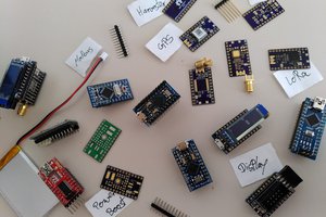

DIPDuino=(Arduino+ZigBee+OLED+SDCard+SRAM)*DIP32
Arduino compatible, breadboard friendly DIP32 package with ATMega1284RFR2, OLED display, SD card, SRAM and ZigBee on board.
DIPDuino - is an Arduino compatible board, which combines many useful interfaces in one DIP32 package.
DIPDuino is based on ATMega1284RFR2 with 2.4GHz ZigBee Transceiver. It also includes:
- 128x32 pixels monochrome OLED display;
- Micro SD card slot;
- Serial FTDI port on USART1;
- 1Mbit SPI Serial SRAM (23LC1024);
- Full JTAG debugger port (JTAGICE3);
- USB or Pin Power Supply;
- Stabilized 3V and 3.6V Power Out;
- Green and Red LEDs (PE5, PE7).
In other words, it includes almost everything I want to have on my hobbyist and professional controller. Sure, few buttons and RTC would make DIPDuino even better, however, taking in account my space constrains (DIPDuino is very tiny!) it is probably not possible.
I have few samples of DIPDuino, and working evenings and weekends to implement Arduino bootloader, headers and libraries for OLED display, SRAM, SD card, etc.
I am planning to use DIPDuino for my freelance and hobbyist projects. I have DIPDuino only for a few days, but already like it a lot! It is really convenient, to be able to plug in the controller into a socket on a breadboard and take it out when you need it. Embedded display and SD card are perfect for debugging, logging etc., and two serial ports as well.
