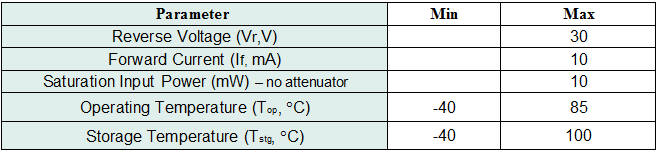

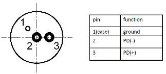

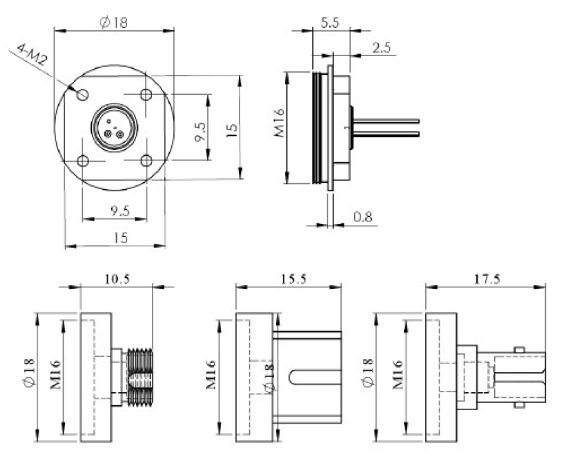

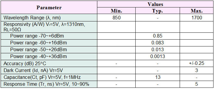

3. InGaAs PIN Photodiode for Optical Power Meter (from oemarket.com)
Short description:
