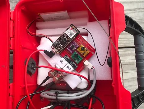

Hardware Assembly
System hardware layout
Board and probes
System wiring diagram
  1. Solar Panel | 6W, 6V (different panel is pictured)
  2. Battery Pack  | 12,000 mAh, 44 Wh (different battery is pictured)
  3. Adafruit Feather 32u4 FONA
  4. Battery Pack | 1,200 mAh, 3.7 V output
  5. Antenna with uFL connector
  6. Submersible temperature probe
  7. SIM card
  8. Submersible EC probe + circuit | K 1.0
  9. Submersible DO probe + circuit
  10. Voltage isolator circuit

It Eventually, the device's various components were all working harmoniously: taking accurate measurements, transmitting them to the cloud, sleeping regularly, and consuming very little power. Before depositing bare electronics into the East River, however, it needed to be weatherproofed and affixed with a solar panel.
Weatherproofed
Weatherproofed
