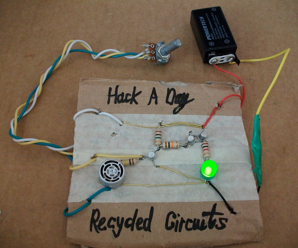

    This website is about an ultrasonic LED circuit:
    The LED can be replaced with a bright LED that emits a higher light intensity.
    You can see the circuit working in the video below:

    Step 1: Design the Circuit
    I drawn the circuit in PSpice student edition software:
    Calculate maximum LED current:
    IledMax  = (Vs - Vbe3 - Vce2sat - Vled) / Rd
    = (9 V - 0.7 V - 0.2 V - 2 V) / 1000 ohms
    = 6.1 V / 1000 ohms
    = 0.0061 A = 6.1 mA
    This current value is very small. You can increase the current by reducing Rd value to:
    Rd = 560 ohms: IledMax = 6.1 V / 560 ohms = 10.89285714 mA
    or
    Rd = 470 ohms: IledMax =  6.1 V / 470 ohms = 12.9787234 mA
    The current for the big LED shown in the photo should be 20 mA. However, if you are using recycled LED components, then you might end up with an LED that will burn at currents above 5 mA.

    Step 4: Make the Circuit
    I made the circuit without the use of the soldering iron:
    You do not need to use 1 Watt resistors for this circuit that you see in the photo above. The 250 mW power rating will be sufficient for this circuit.
    I used 1 Megohm value for Re1 resistor instead of 100 kohm shown in my circuit design to obtain a higher gain. The difference is not significant. I specified the 100 kohm Re1 resistor because most resistors came in a pack of five or two, thus eliminating the need for searching or buying another resistor (the 1 Megohm).
