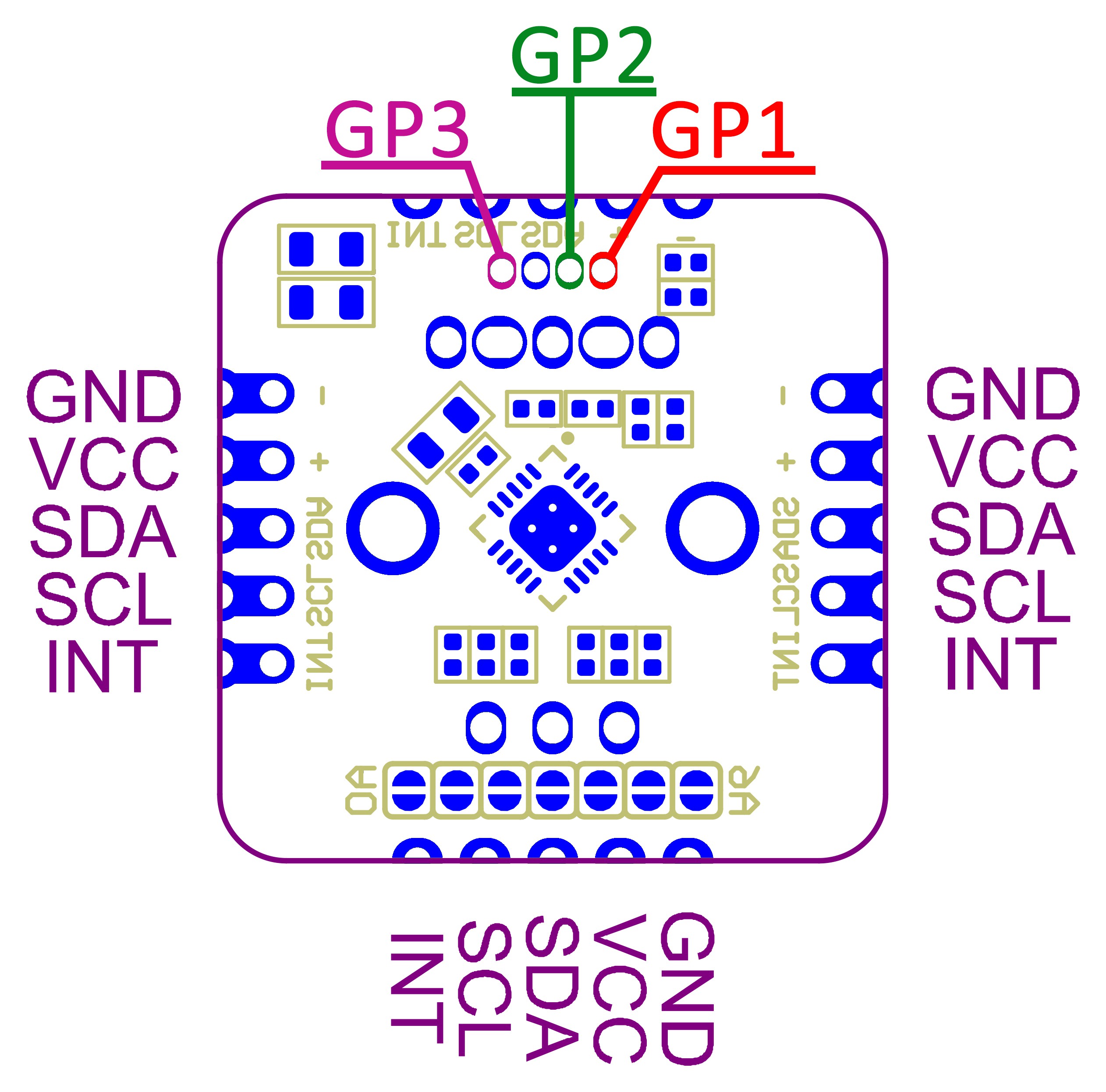

  • With the castellated holes is possible to connected several boards on the 4 sides
  • Possibility to solder the pull-up resistor on the I2C bus
  • 3 General Purpose pins. (GP pins)

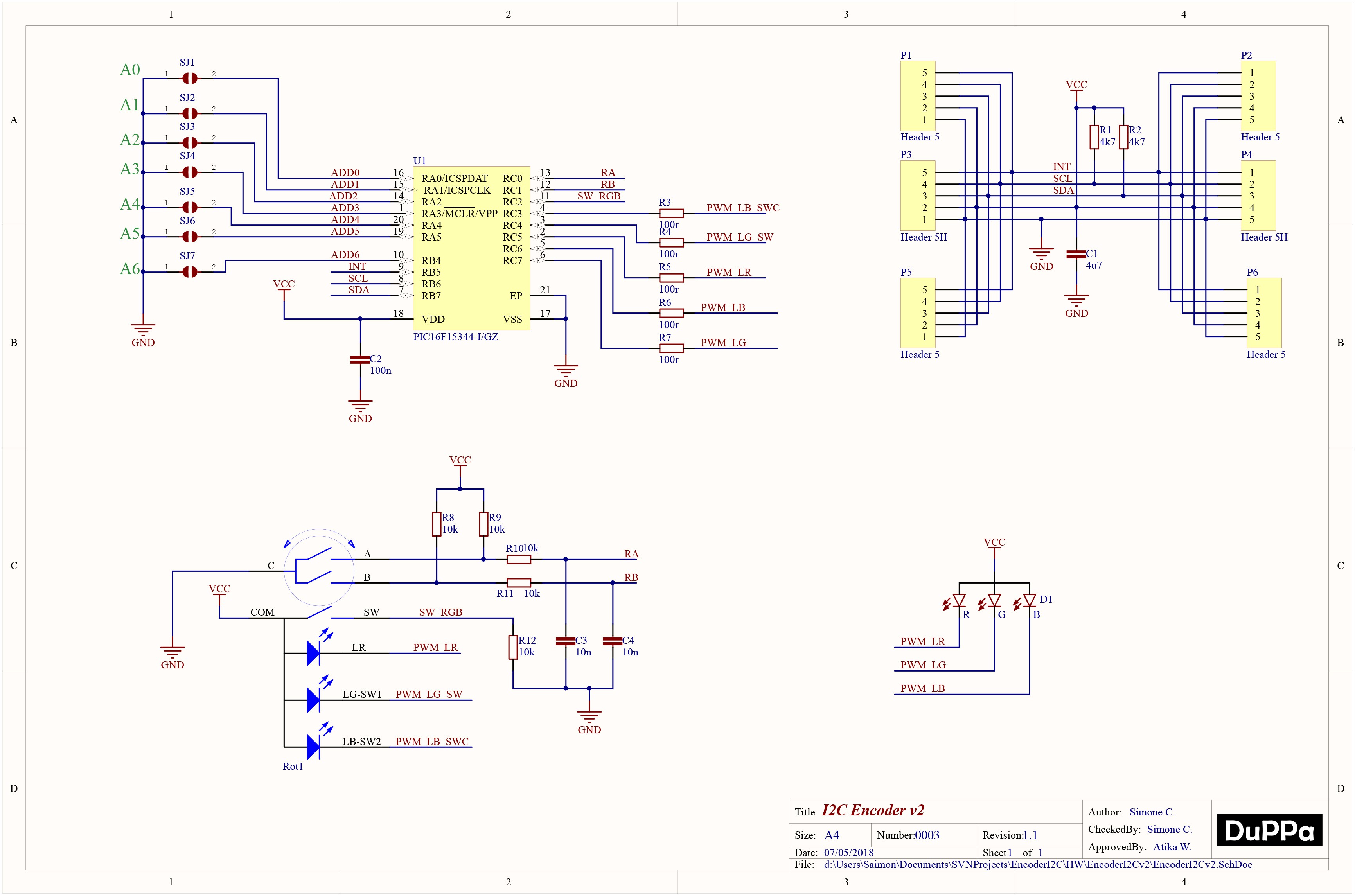

This new version is powered by the PIC16F18345. Respect to the MCU on the first version, it has more GPIO and the EEPROM memory.
The new design of the board support both the standard encoders and the illuminated RGB encoders.
Moreover, there are the castellated holes on all the 4 sides of the PCB, in this way will be possible to connect multiple board by soldering them.
There are also 3 configurable GPIOs organized with the same footprint of a RGB LED. They are called GP1 GP2 and GP3.
But in case you are using the RGB encoder, the configurable GPIOs are only 2: GP1 and GP2.

I2C Adress setting
The I2C Encoder V2 is a I2C slave, it's possible to the set 127 different addresses. All of the 7-bit address can be customized by soldering the jumpers A0 - A6 on the bottom of the board.
When the jumper is open, it means a logic 0. if jumper is shorted it means a logic 1.
The I2C Encoder V2 has I2C pull-up resistors, by default they are not soldered. It's possible to solder two resistors R1 and R2. This must be done in case that the master doesn't have these resistors and must be enabled only one I2C Encoder V2 in a chain. A typical value of this resistors are 4.7k.

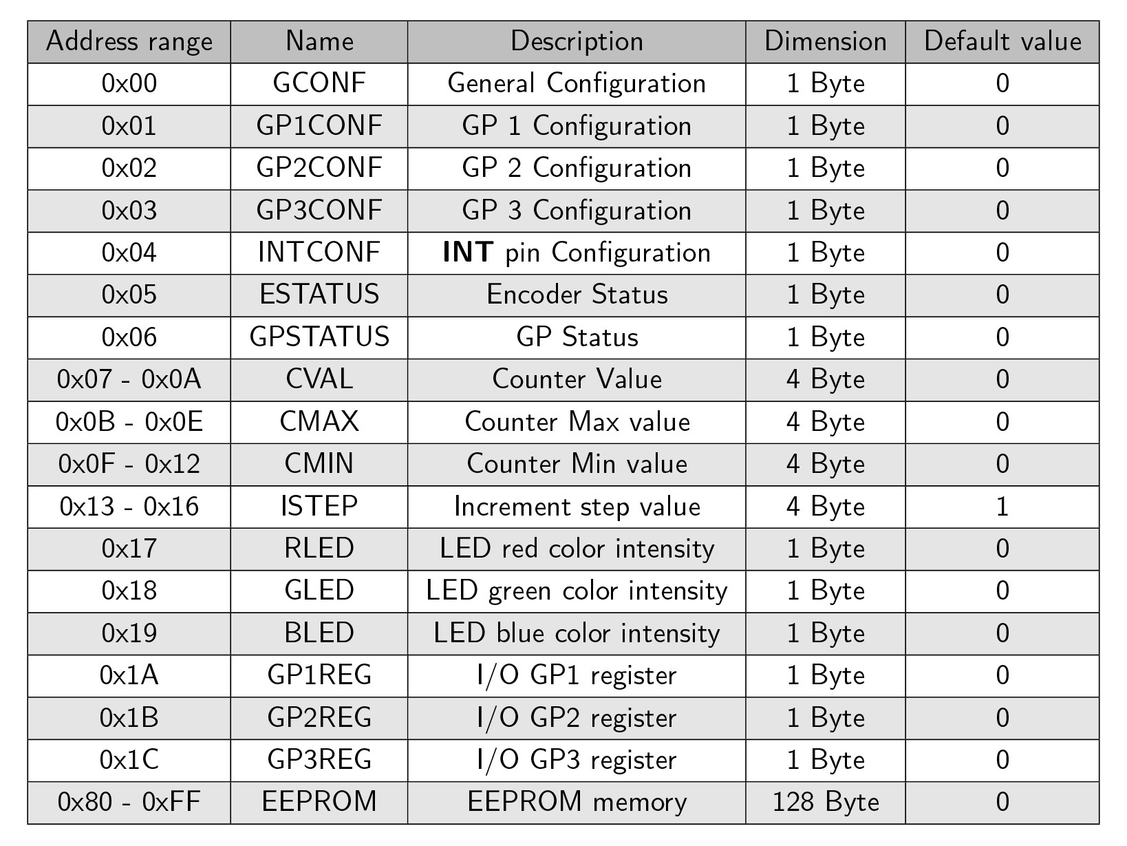

I2C registers:
This is the internal registers accessible on the I2C bus
It's possible to write those register on the fly during the normal operation.
It's possible to confgure several option by setting the registers with the I2C bus. With the GCONF register, it is possible to configure several parameters.
In the configuration, it's possible to set the polarity of the encoder quadrature signals and also to set if the outputof the encoder is X1 or X2.
For reading the rotary encoder movement, there are 4 32bit registers: CVAL, CMAX, CMIN and ISTEP.
All of these 4 registers can be configured to work as 32bit INT or as IEEE 754 floating number, this format can be set in the GCONF register.
Every time the encoder moves one step, the value of the CVAL register is increased or decreased of the value of ISTEP. The direction of the rotation decides if ISTEP is added or subtracted from CVAL.
CMAX and CMIN are used for setting a minimum and maximum thresholds of CVAL. In the GCONF register, there is WRAPE bit. This bit is used to enable or disable a wrap functionality of CVAL when it exceeds from the thresholds.
For example, if i con gure the I2C Encoder V2 as following:
  • CVAL= 0
  • CMAX = 5
  • CMIN = -5
  • ISTEP= 1
I will have CVAL is incremented of 1...

    Start to solder the passive componets
    Once the MCU is soldered, it means that  the difficult part is done.
    Now you can start to solder the capacitors and the resistors. My method is the following:
    1. Apply the solder only to one pad
    2. Solder the component on that pad
    3. Solder the other pad
    Generally i start with the 10k resistor and the 47nF capacitor.
    That components are R8, R9, R10, R11, R12, C3 and C4.

Saimon wrote 02/09/2019 at 20:31 point
Hello Philip,
For using external RGB LED, you have to use the GP pins.
First configure the GP1, GP2, GP3 as PWM, with writeGP1conf( GP_PWM )
Second write the PWM value to the GPs register: writeGP1(   ):
If you use the GP pins as pwm you don't need the pull-up
