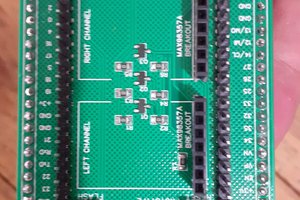

About a week ago, I showed you pictures of my second prototype which wasn't 100% functional, at the time. Since then I speed a few days trying to get the SGTL5000 to work without any success.
I could talk to the chip via I2C, but the I2S output was both weird and unreliable no matter what I tried (I get either 0x00000000 or 0xFFFF8000 if I recall correctly).
I'm thinking that my SGTL5000 could be faulty (I won't blame it on NXP, my reflow job was ghetto-ish and frankly terrible) so I bought another one... and it turned out I mistakenly ordered the QFN-32 variant instead of the QFN-20.
Hopefully I *stiil* have the equipment at home to make PCBs, I drafted a breakout board directly in pcbnew (from KiCad) and etched the PCB in an afternoon. I got the occasion to try some new presensitized material from a local shop: the results were terrible (I tried multiple exposure times, etch times, etc.) and in the end I was glad that I had Bungard leftovers (this brand seems to make good presensitized boards).
I soldered the SGTL5000 on the breakout board and I still have to replace the SGTL5000 on the prototype PCB with the one from the breakout board.
Two months ago I sent Gerber files to the fab, and a couple of weeks later I received the PCBs. I was very busy so I barely got time to solder the PCB a month ago and only started the bring-up last week.
So far I only tested SD and OLED (which needed a fix on the PCB, CS was held high). The SGTL5000 is visible on the I2C bus (btw if you are using this chip, make sure you are sending MCLK before trying to communicate with I2C, otherwise this chip will stay silent!).
