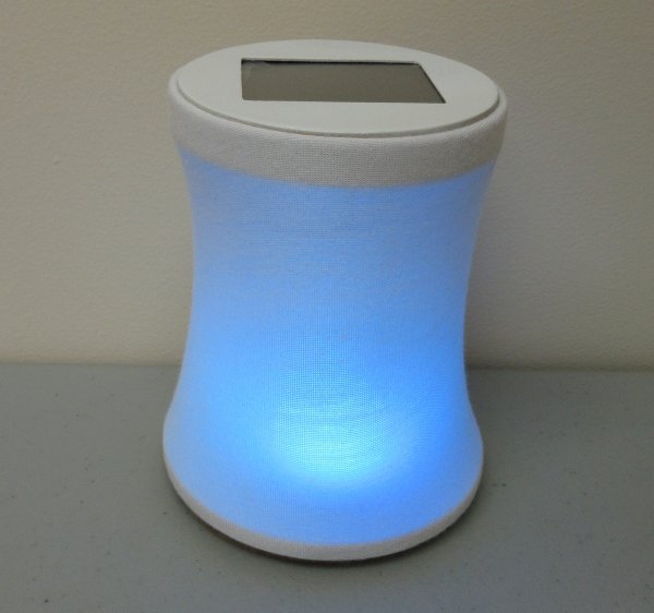

    A lot of the Integron unit is working in component parts.  It remains for me to coordinate the various internal subsystems.  Here is an image of the first cut of the desktop morphology.
    In this image the screen is present but not active, and the little ripple in its surface is just the protective plastic which I have not yet removed.  A NeoPixel is activated blue, under an internal diffuser, in front of a sound baffle and support structure joining base disk to top disk.  The fabric sleeve is an acoustically transparent speaker grille fabric.  There is some left-right asymmetry due to uneven tension, due to me assembling and disassembling this prototype a number of times.
    Still working on the mechanical fit and angle of the PIR sensors in the support baffle structure, and I have yet to test the transparency of the acoustic fabric to the ultrasonic sensor.  The infrared passed just fine, so worst case if the ultrasonic does not work I will put a central PIR in a tube to narrow the angle, and use that to indicate presence of someone standing right in front of the unit.  But I'd rather use ultrasonic ranging since then I get an actual distance.

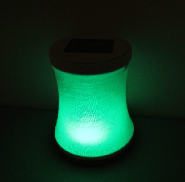

    The unit looks great in a darker setting.
    It also is effective at giving a colored light signal from a distance in normal light, though the camera does not report well what the human eye sees, which is much more even than this image shows.

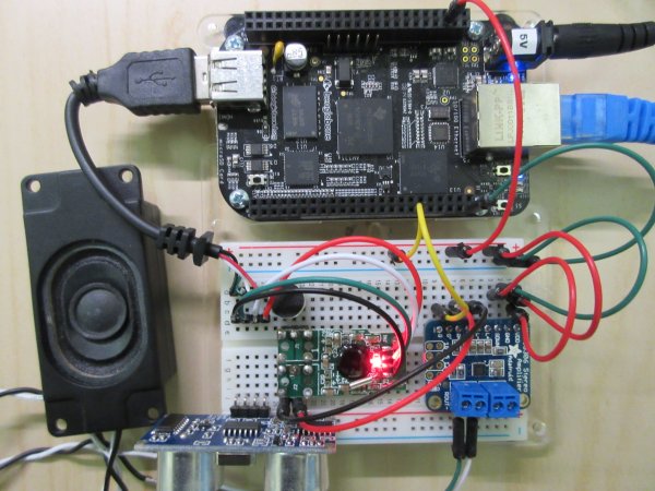

    The unit in this image does not contain the Beaglebone Black and audio components, I have that assembled on a breadboard separately for testing, but expect to be assembling it all together shortly.  (It does fit - using a proto cape on the BBB.)
    The speech synthesis and speech recognition are working.  The USB sound card is working well, but I am still working on the right microphone and audio amplifier on the output.  Currently I have a capsule electret mic sourced from Adafruit, and it works quite well close up. But I have ordered higher sensitivity ones, because I want to be able to speak to it from a distance, and it's just not there yet.  I have also ordered some adjustable pre-amplified mics, which may be OK if I attenuate the signal all the way down so that the peak-to-peak does not overdrive (!) the mic input. The sound card is apparently able to withstand abuse - I did try a sustained, full 2 volts peak-to-peak signal to see if it would fry (the sound cards are only a few dollars each, that test was worth it to find out the capability.) Terrible sound, of course, super distorted - but it didn't fry the board. We'll see if we have to go there at all. The internal baffle of the Integron unit is designed to be a sound cone. On the output side of things, I am using an Adafruit audio amp, but while it is quite excellent at what it does, it may not be the best choice for this application. I have some less expensive PAM chips on order, and some different ones I have used before in house, I will be experimenting with them soon.  I also changed the speaker to one that was less tinny. The speech output is mono, so I am just using one speaker of a pair.  This unit is really a point source so in some ways it makes sense to combine channels for any potential stereo signal sound files and just use mono.  That makes it more compact.
    The Moteino is driving the NeoPixel without issue, but I will use more than one in the final unit so that the top, middle, and bottom can be illuminated differently to give three different levels of signal.  (That is the idea anyway, we will see if it is practical.) Due to the internal baffling, there may need to be three LEDs per tier to enhance visibility from all sides, so nine total.  I am considering making the screen bezel ring out of translucent white acrylic, and adding another NeoPixel to make that a soft, power-on indicator light (overridable of course, if you want it off).  So ten RGB LEDs.  In...
