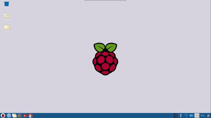

As you hit enter and all the things are correct, the Raspberry Pi Desktop will load in a new window. You can go into a full-screen mode by clicking on the options available above on the window.
1 / 2 • Windowed Mode
2 / 2 • Fullscreen mode
