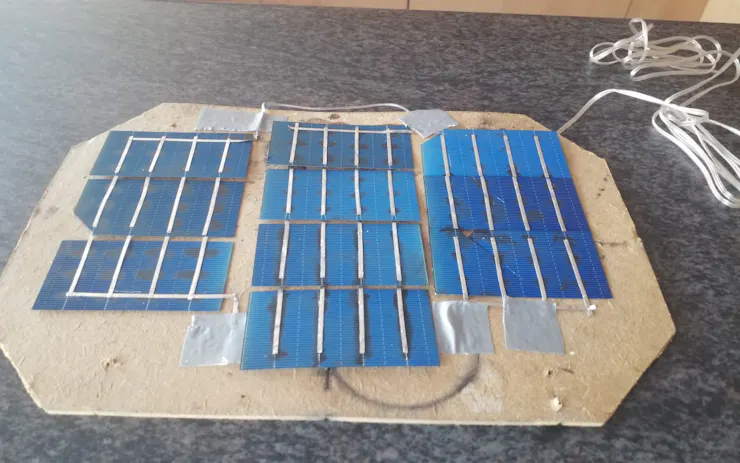

For this 1st iteration i picked up all kinds of materials i had lying around in my home to assemble my very first solar panel . I used a piece of wood as support for a total of 10 solar cell tiles soldered in series (see the photo below)
The very first assembly of solar cells in series to output 5V DC

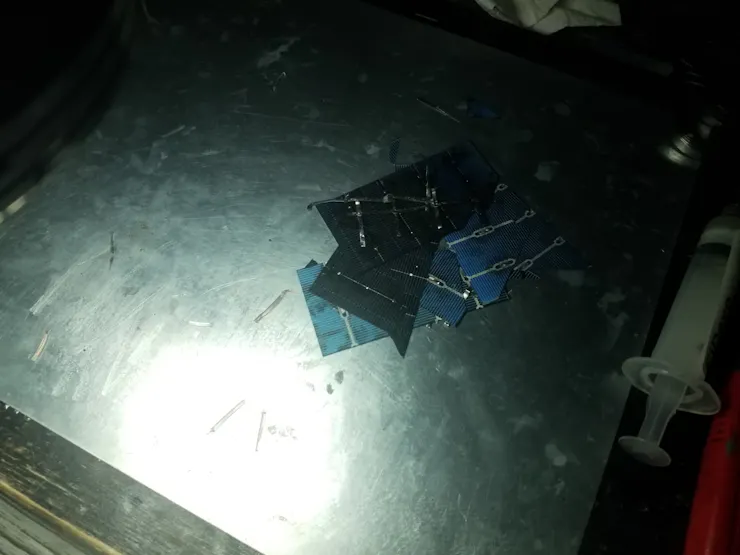

This required me to view and study many videos on YouTube on how to solder this kind of polycrystalline solar cells until i was able to assemble them without breaking. This solar cells are very fragile and break very easily. On top it requires learning the max amount of strength one can put when handling the solar tiles.
Solar Cells are very fragile and break easily

this 1st iteration my biggest "surprise" was the fact solar cells still produce electricity even when broken. The corners at where the tile is most fragile and break even without you notice it. Because of that, is important to train and adjust the amount of strength put into it for handing them.
