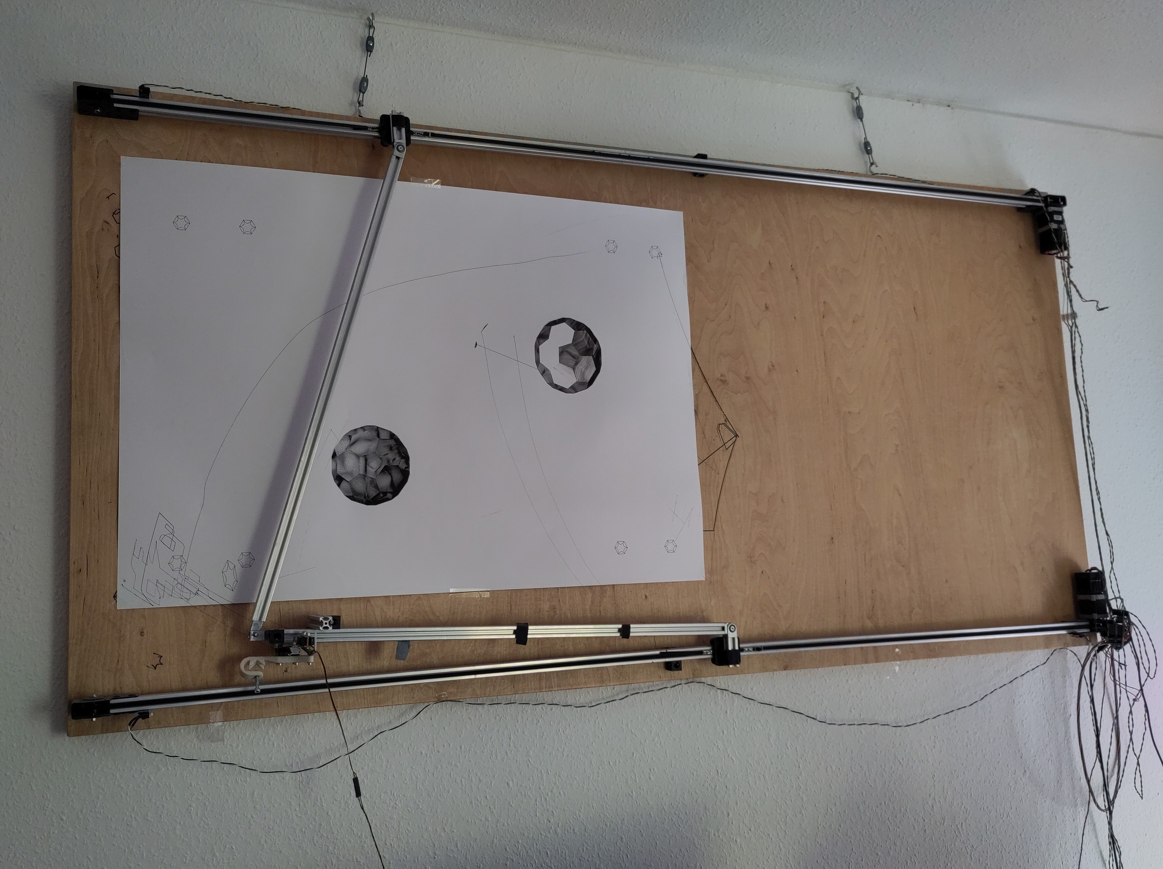

Plotting machine build to be hung from a wall. Uses a delta-arm design to save on parts and to improve elegance.
seisei
I've got a big piece of wall in my apartment which is empty, and deciding what to put up there can be difficult (at least it is for me). The solution is to hang something there that is neither boring nor to blinky (first thought of LEDs but that would probably be annoying). The easiest way would be to just draw a picture myself or buy a good one but I can't draw and I usually waste my money on useless electronics so to kill two birds with one stone I had the idea to build a plotter which will paint me nice drawing directly while hanging on the wall..
The basic construction of the plotter consists of a thin wooden plate (3mm) which is glued onto a thicker wooden frame to increase the stability while being not too heavy.
All the mechanic stuff is from http://openbuildspartstore.com/, it's not to expensive and even if it's IMHO not best quality it does a good job as far as I can judge. Also this saves on brain which is needed for the programming part.
The electrics consist of a teensy and SilentStepStick TMC2209 drivers. I guess I'll need the raw power of the teensy because efficient programming is out of my league.
The initial alpha firmware can be found at github.

    Now that the Project has successfully ripened, it is time to make some progress!
    So I made a simple frame from wood (2.5cm x 9cm):
    The frame is just glued using simple tongue and groove joints:
    The grooves were cut with a router, and the tongues were cut with a band-saw. Then I just glued a 3mm three-layer-board on top.
    Next I assembled all the parts that gathered dust for the last years:
    The frame is 2m x 1m, which I realize now is a bit over the top, but you've got to give your megalomania a treat sometimes I guess.
    Right now I'm working on the software and I probably there will be more updates in the next weeks.
