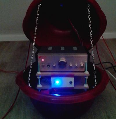

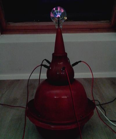

    Hey we finally finished the Jack Dispenser!
    We first had to finish the painting and add the final paint layer to give it the perfect touch. Next was to glue the plama ball circuit into the water sprayer, we wanted it to be the closer from the plasma ball to ensure the cable's contact in it. We then had to solder all of the speakers cables (4 one-end jack connector) the auxiliary input (one 3.5mm to 6.35mm jack). We used a jack to RCA adapter to plug the Raspberry Pi straight into the amplifier.
    After assembling the 3-floor structure, well... We had to disassemble it because the leadscrews were too tall. So, after re-cutting the leadscrews and re-assembling the inner structure we were ready for the big final : put the plasma ball on the top the the Jack Dispenser and turn it on with some kickass guitar sounds. The results can be seen on the videos in the details of our project. Check it out!
    It is complete ! Well...
    ...Not exactly. We still have to improve some of the features to enhance the user's experience a bit more as it is quite essential. So even if it is tagged complete as the Jack Dispenser is now fully funtionnal, things like the WebUI still need to be improved, for example we're actually thinking of a replacement for lighttpd in order not to go through the whole server configuration and its use with PHP. We'd like to find a server that could be directly implemented in the package, so if you think of one that could fit our need, tell us in the commentary section!

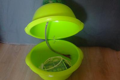

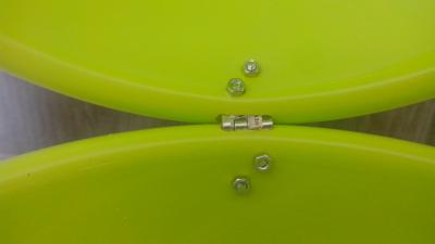

    Like we planned, we bought some hinges at the local store and we used our Dremel to drill some place for one hinge that is discretly located on the upper outside border of the basins. One hinge seems enough for us but we had to find a way to keep it opened properly and so we chose the good old-fashion chains to keep it open at certain angle without falling.
    Discrete hinge

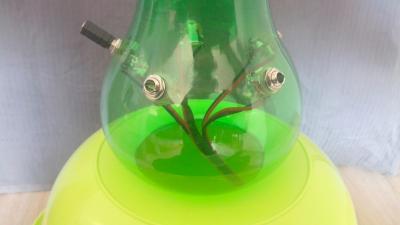

    Still with the Dremel, we drilled some holes in the water sprayer for the female jacks and cut the bottom of it so we could pass cables from the water sprayer to the basins. We also drilled a slot into the water sprayer in order to install the circuit from the plasma ball into it and have an access to the on/off switch. We will install it definitly when the Jack Dispenser will be painted.

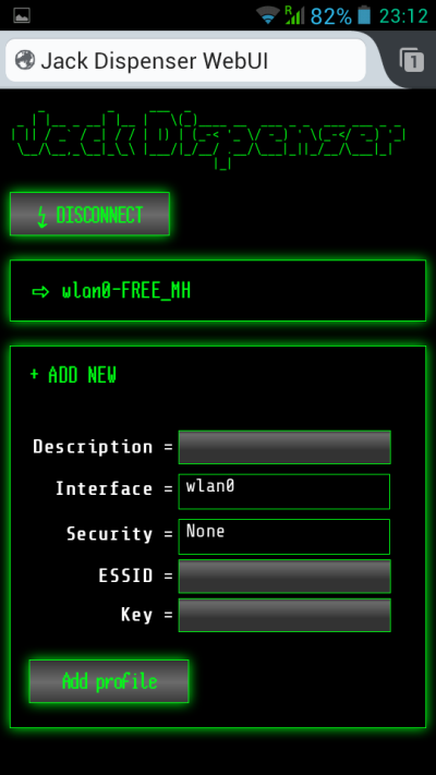

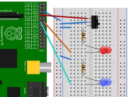

    GPIO & WebUI
    We spent a lot of time on the software side, trying to figure out a simple way to enhance user experience without having to add a display and/or a keyboard. As described in our second Project Log, we made a script that reads the input from a physical switch and switches between hotspot and client mode depending on the switch state. The script, nammed whc-switch, is also able to start/stop/restart systemd services depending on the switch state. You are able to customize this by using the configuration file which is shipped with whc-switch. Actually, we needed it for gmrender-resurrect which doesn't react really well when changing network configuration.
    More than that we have started working on a WebUI you can use to configure/add/remove netctl profiles as you wish and display the profiles specs. The WebUI is designed to receive only one connection at a time so you wouldn't actually be able to edit profiles from two computers causing troubles to happen when saving the files from two locations. It is more secure even if passwords from the netctl profiles are displayed in clear text (we will be working on encryption after the contest is finished).
    We felt that we also needed a way to communicate the wifi state to the user. We chose the simplest way: leds. One blue for the wifi state and one red that will light up if a problem occurs. The blue led will blink when the wifi is in hotspot mode (host mode) and will stay on if the wifi is in client mode.
    How to connect the switch and the leds on the Raspberry Pi (B Rev2)

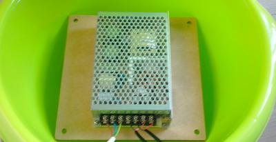

    As we showed you on the last update, we thought of a little structure for the power supply, the Rasberry Pi and the motorcycle amplifier. We chose to use the rodolpheh's CNC to cut and drill the plates in MDF and now have our internal structure almost ready (we just need the amplifier to make the last floor).

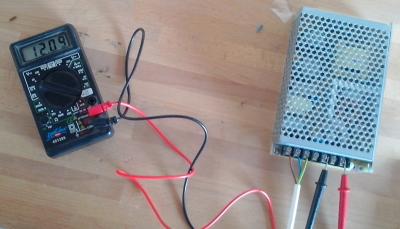

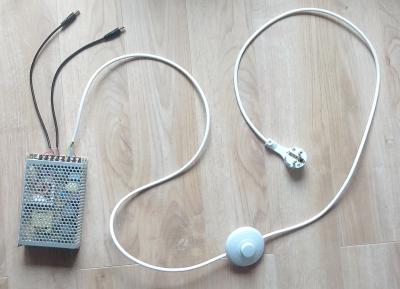

    Last week, we took a day to go to the local store in order to prepare a good power cable for the power supply. We used a flat plug with a little hook to unplug it and a foot-triggered switch. This won't looks really futuristic but hey! if you have seen "THX1138", you know that white IS futuristic! Quickly, we got into testing and adjust the power supply.
    Adjusting the power supply
    THX1138 style cable

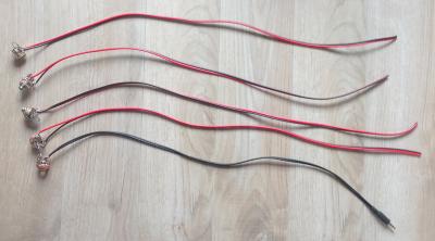

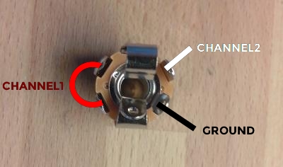

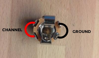

    As the jack dispenser needs jack connectors we also started the soldering part. So now our 5 female jacks are ready to be plugged on the little amp we are about to receive. We soldered one of our ø6,5mm female jack to ø3,5mm male jack for auxiliary sound input using an old audio cable for stereo. The last four of them are soldered on mono audio cable. Since the female jacks are stereo, we needed to solder it in a way it would act as a mono. We came up with this cabling:
    Mono cabling
    Stereo cabling
    The cables we made
    The cables were tested with an adapter and plugged to a laptop. It worked perfectly as we planned.

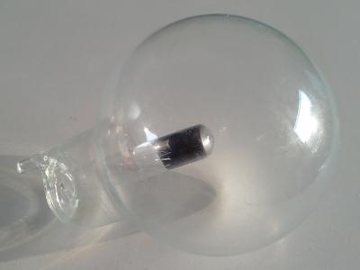

    The plasma ball has also been disassembled to see how it could fit in the whole structure. We also tried, with success, to add a longer wire to the plasma ball for when we will fit it in the Jack Dispenser. There is some kind of metal scrap inside the plasma ball and the wire should touch it in order to make a good electrode.

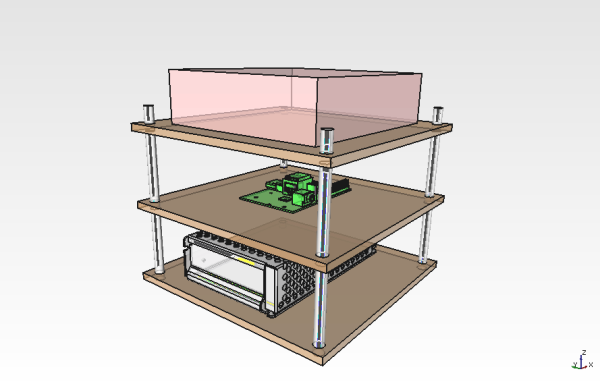

    For the same concerns we made a 3D model of a tiny 3 floor wooden structure that will be placed in the lower part of the jack dispenser. The advantage of this little structure is that it will ballast the object so we can easily open it without worrying it would fall. Opening the jack dispenser will probably be done with hinges, by leaning the upper part like you would do with a treasure chest. The floors will be held with leadscrews and nuts. It is as simple as it could be and we should be able to get it in or out easily for maintenance.
    Here is a quick model of our structure. We will probably update it as soon as it evolves.

    • The power supply should output enough power to power up the amplifier, the raspberry pi and some of the accessories you will add.
    • Having only one power supply is easier. Try to use converters if you need other voltages. Most of the amplifiers are 12V and the Raspberry Pi uses 5V, you don't need to be a genius to know that you will need a converter or another power supply, so you better make a choice. "This is your last chance. After this, there is no turning back."
    Calculating the needed power can be done quickly. For our example:
    • Amplifier: 80W
    • Rapsberry Pi: it will get as much as the converter can give: 10W (but that won't happen since we're not using power-sucking components)
    • Accessories (as the plasma ball): about 2W maximum
    This gave us 92W maximum so we took a 100W power supply.

pierrep wrote 5 months ago null point
We actually thought of a few ways to handle the lower chamber opening, but the problem was essentially to find one that would work fixed on a circular shape. We came up with the idea of the hinge as we knew we could find little ones that would allow us to open it easily, we actually had the same concerns about the hinge and thought of the chains to hold it opened not to make the hinge take all the weigh so guess it will take the use for quite a while!
Are you sure? [yes] / [no]
Mike Szczys wrote 5 months ago null point
I worry about the hinge on the lower chamber holding up. If it can take the use, this is a useful art-piece that deserves a place of honor!
RodolpheH wrote 5 months ago null point
The hinge is not the optimal solution but it works and we did took some time to test its strength by pushing it forward and back and on the sides. It doesn't seems to break easily nor the basins we used (cheap plastic is really deformable).
If we have one problem, it's for the paint that don't want to stick to the cheap plastic. We hope we will have some time between two projects to make a V2 that could be made of fiberglass. By making our own structure, we would be able to rethink the opening system and have a good paint.
For the moment, we have a lots of ideas for a better version with more features. This first jack dispenser was really a prototype but we're happy that we were able to comply with the first specifications that we have given ourselves.
