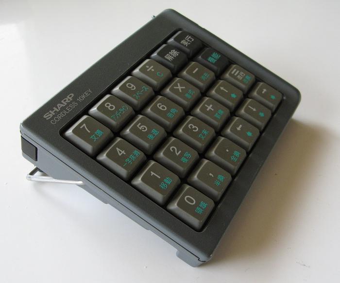

    I have also put together a remote dialer, which I introduced way back at the beginning. It's based on this wireless 10-key:

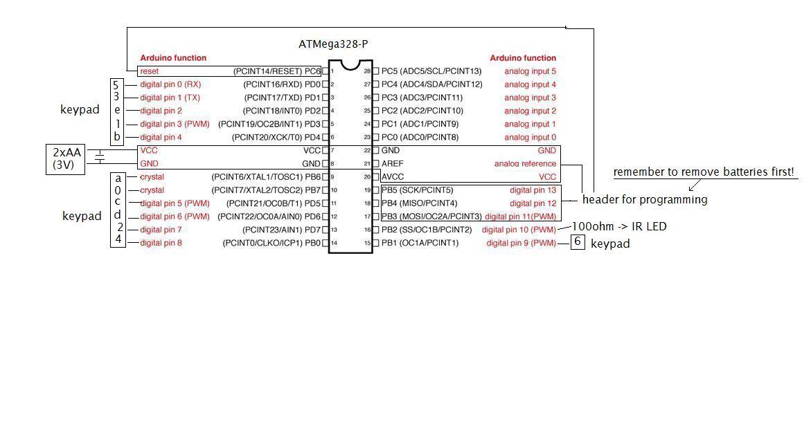

    It looks pretty much the same, but I painted the front bezel to match the gate and cover the label. Unfortunately, the electronics inside were not functional, so I gutted it and stuck in an ATMega328 microcontroller to read the keypad and control an IR LED. Here is an annoyingly small version of the schematic.
    Here is the code:
    https://drive.google.com/file/d/0B0-PE-lARnk1WWwyUGUydGx2S2c/edit?usp=sharing
