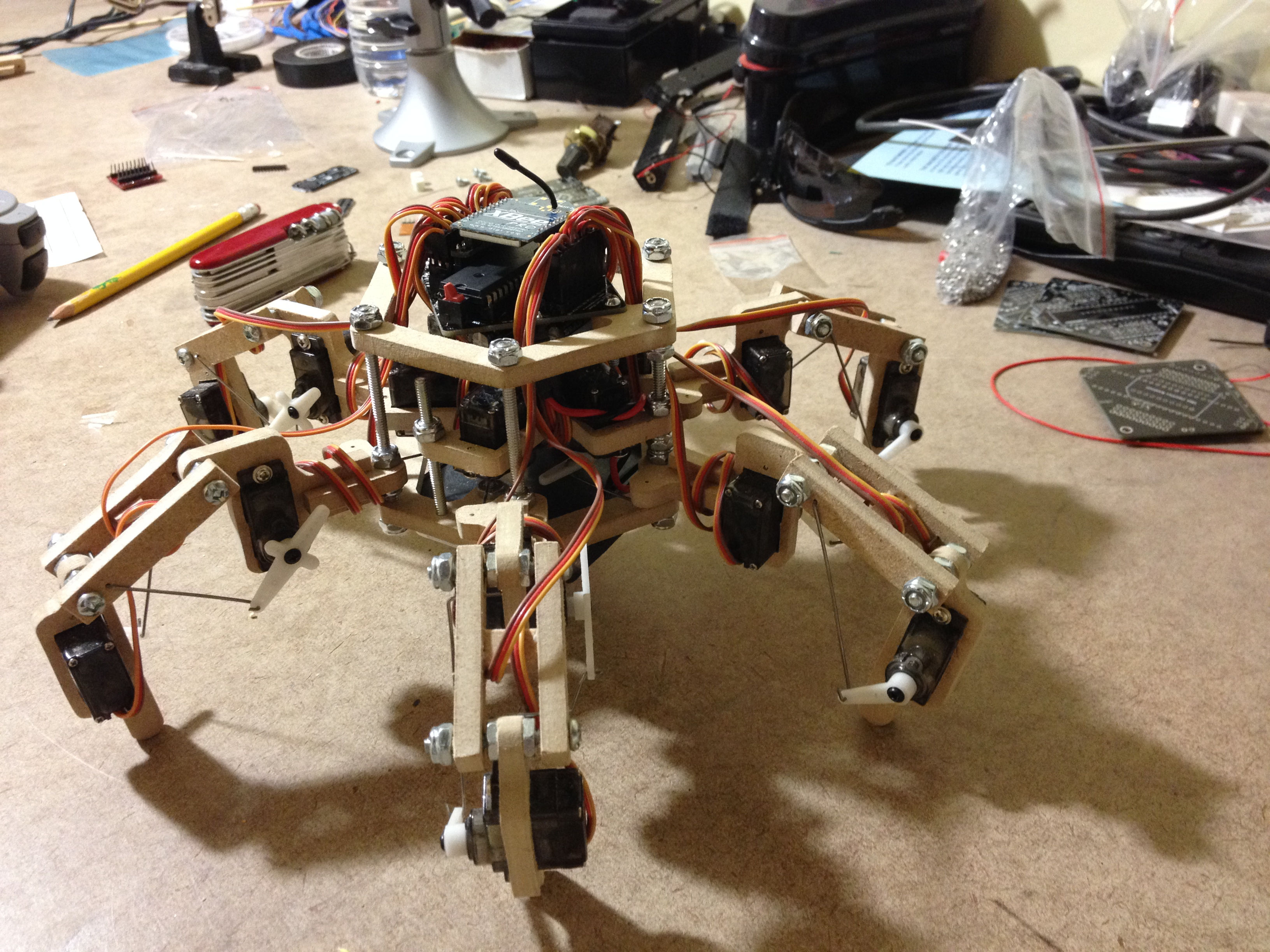

Since we started, Stubby has grown from a simple, direct-driven 2 DOF (degree of freedom) per leg frame to a mechanically-assisted 3 DOF per leg design with a full inverse kinematics engine (which allows the processor to calculate custom foot positions for each step, rather than relying on a static loop).
This video shows off the latest version, including various features of the Inverse Kinematics engine:
Originally, the concept of Stubby came from the SG-1 universe's replicators (which, let it be known, are completely awesome!).  The name 'Stubby' was coined by Princess Sparkle, after seeing the first version (with 2cm long, oblong legs), barely able to limp along the carpet.
After the interesting parts (most notably the frame design and inverse kinematics engine) were completed, I wanted to expand Stubby's abilities.  The Hackaday Prize made me think about 'connected' projects... at the same time, Princess Sparkle was expressing interest in computers and programming.  In talking with her, we came up with the idea of making an API which would allow her to issue simple commands to control the robot.

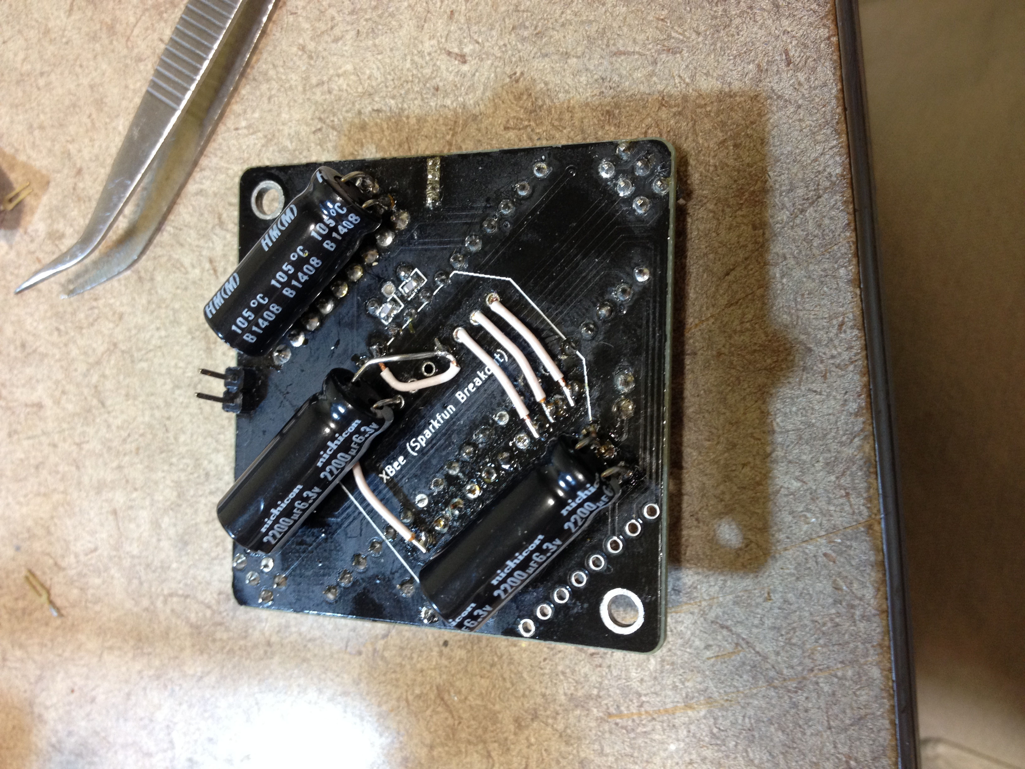

    *****ELECTRONIC BOARD ASSEMBLY*****
    Currently this is dedicated to the Revision 1.0 / 1.1 boards.  This section is almost exclusively soldering.
  • 3
    Start with the 0805 passive components, like the resistors and capacitors.
    When soldering two pad SMD components, I found that the following approach worked best for me:
    • Start by tinning (melting a bit of solder) onto one of the pads on the PCB
    • Hold the component in place with tweezers
    • Touch the component / PCB pad with the iron, to melt the tinned solder. The component should now be stuck in place.
    • Put solder on the other pad. Use enough that there is a good solid connection to the board.
    • Go back to the first pad, and add more solder, such that it is about the same as the second.

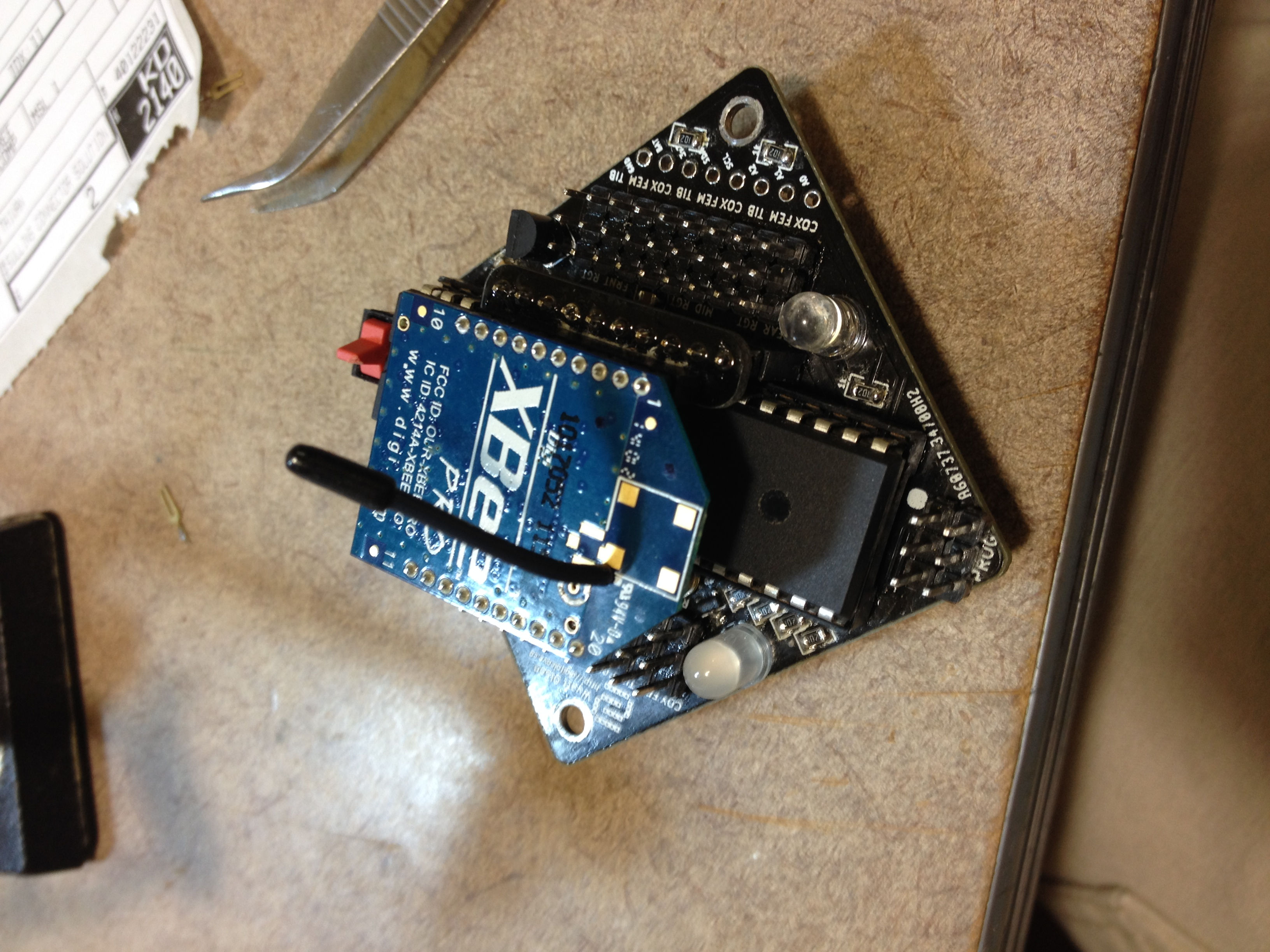

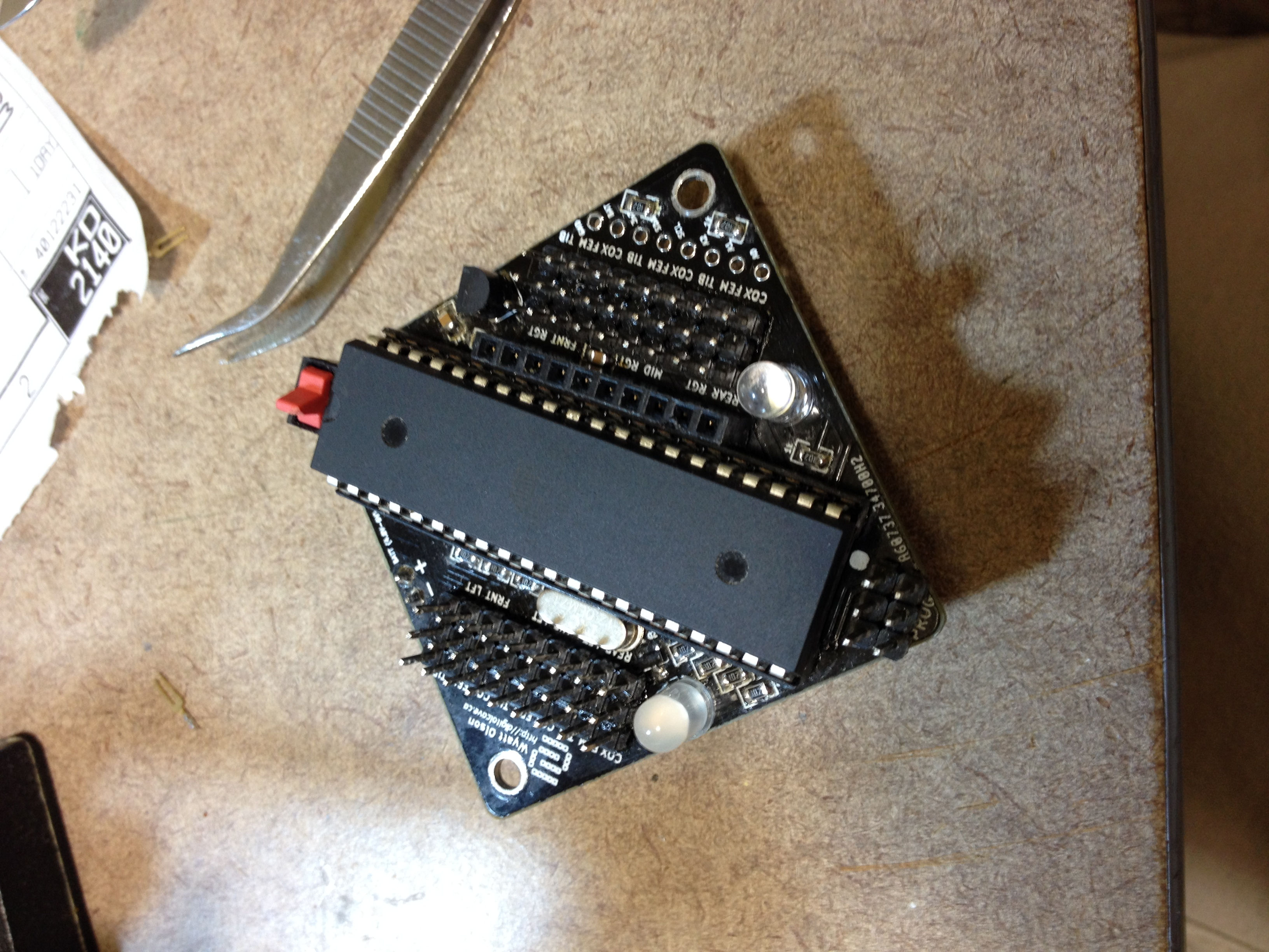

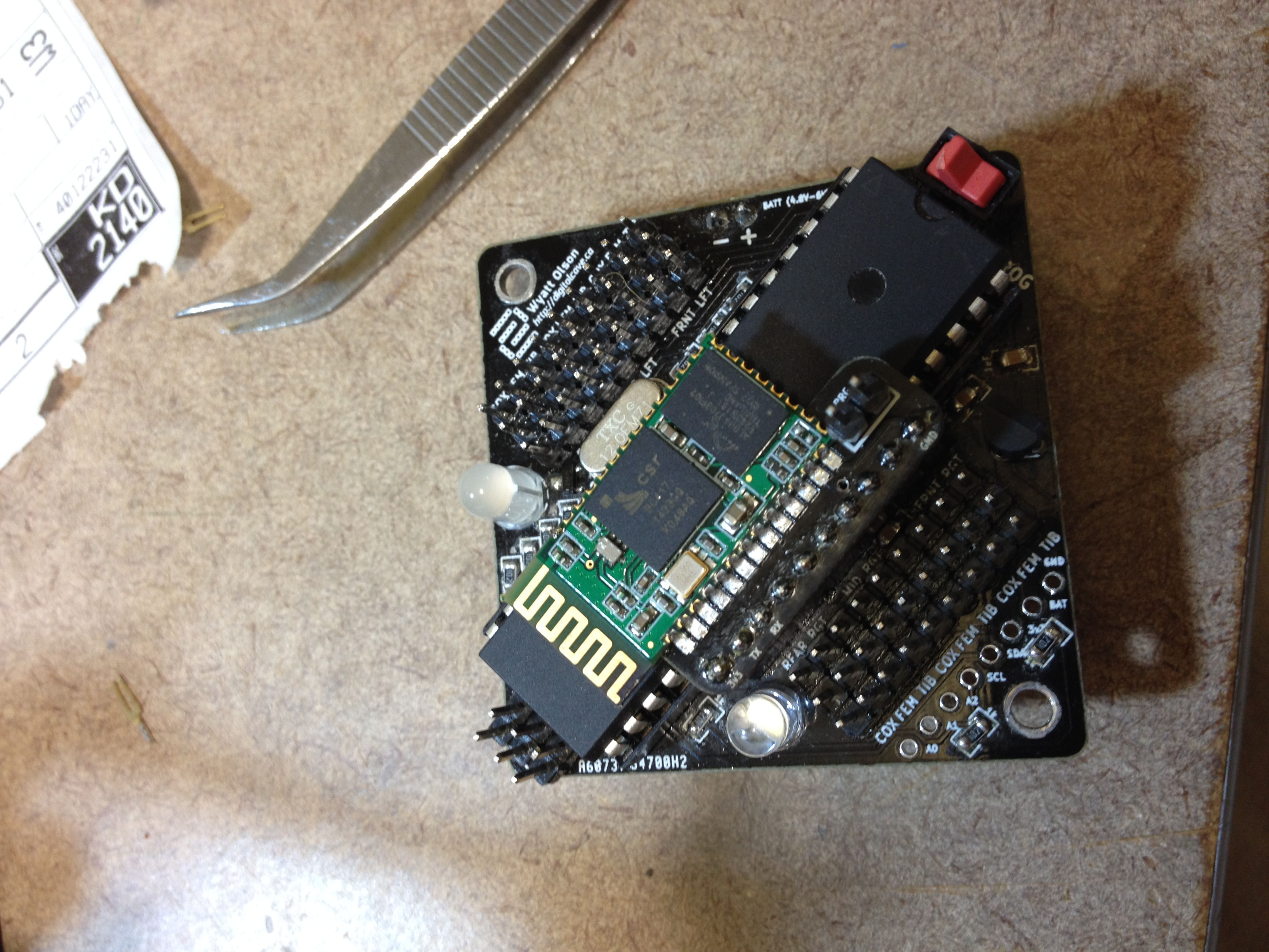

3) I currently have 3 (or maybe 4, depending on how you look at it) versions of the board:
-Rev 1.0 is the first one I ordered, and is what I am using now. It runs the microcontroller at 3.3v (and so is limited to about 12MHz). It is through hole with some larger SMD components, and can be soldered by hand with an iron (that's how I did it).
-Rev 1.1 (semi official) is identical to Rev 1.0 but with holes for a few capacitors added to help smooth power. I have not printed any of these, but I think that a few people who have printed their own have it.
-Rev 2.0 features a complete redesign of the power supply. The microcontroller runs at 5v (and so can be run at 20MHz), but there is still a 3.3v supply for peripherals. This board uses mostly SMD components, many of which are very small. I would not want to solder this one by hand with an iron; as soon as the boards arrive (I am hoping it will be this week), I plan on soldering it using a reflow method, with solder paste and a heat gun. To add a magnetometer, you will need to use an external one (I ordered one from Adafruit for $10, and it is working perfectly on my Rev 1.0 board)
-Rev 2.1 is a minor redesign of 2.0, and has a magnetometer on board. I have not ordered it yet, and have no immediate plans to do so. If I progress into the finals, this will be the board that would be used for a 'product' version.
Now, the obvious question at this point is which board to use? My suggestion is to consider whether you want to use a distance sensor or not, and whether you are comfortable doing fine pitch SMD soldering or not. The distance sensor is the only thing which cannot work on rev 1.x boards, since it requires a 5v supply. I plan on supporting all board revisions in the future (using #defines in the code), so there should be no problem with any of them.

Wyatt, I have several questions regarding your project which im already in the process to replicate and if possible to improve in order to learn something more, Here come a bunch of newbie questions, please brace yourself for my ignorance
1.- What exactly which servos did you use?, I found this “$2” 9g servos in hobby king,
http://www.hobbyking.com/hobbyking/store/__32095__Turnigy_TG9_9g_1_7kg_0_12sec_Eco_Micro_Servo.html
Assuming I replace the top of the frame with some modified MDF roof in order to make it able to carry stuff around while it moves (Increasing the weight) would higher weight servos accomplish this?
3.- This one is just to make sure I understand how to use a Xbee, if the PS2 controller has been modified like yours , I will need another module of the Xbee placed into stubby, , module, Stubby will need another one right however since I don't have a model at hand ?
4.- I have programed PICs 18F… using a pickit2, however I wanted to ask you exactly which programmer and what software did you use in order to program the AVR pic
5.- At the component list for stubby “1x Control PCB” can be found however I find this confusing
6.- Any chance you post some pictures of the assembled and soldered PCB and the connection with the Xbee?
7.- What software did you use to make the MDF designs? i tried using Corel, Ilustrator and Autocad to open them and review them with no luck until now, they do open but all messed up
8.- I just noticed you just updated the Assembly Instructions in your project page, they are very detailed, great job Any chance we can get some high resolution pictures?
Are you sure? [yes] / [no]
The Big One wrote 3 months ago null point
Hi there.
No worries about questions... 3 months ago I was in exactly the same place! :-)
1) Those are the servos which I used. (The price has gone up a bit... when I bought them, they actually were $2, not $2.25. The blue version, http://www.hobbyking.com/hobbyking/store/__9549__Turnigy_TG9e_9g_1_5kg_0_10sec_Eco_Micro_Servo_.html , is a bit cheaper and I would assume that it works too, but I can't say for sure.)
2) If you wanted it to carry anything substantial (anything more than 25g or so - it is already borderline as far as weight is concerned), I would definitely want to use larger servos. The problem with that is that larger servos will not fit in the frame I designed, so you would have to modify it. Now, this is not very hard, but would involve using a CAD program (I used QCad and can highly recommend it), and that may have a bit of a learning curve if you have not used a CAD program in the past. More specifically, the coxa servos should be fine as they are, with the smaller servos (there is not a lot of load placed on these ones), The servos driving the femur and tibia should be larger, though.
3) Correct, you need two XBees to communicate with each other. The design really only calls for some sort of serial communication, though, so you could use any module that provides serial communication at 3.3v. I am planning on putting one of those cheap serial Bluetooth modules on Stubby sometime (in which case you would control it with the computer). Other options could include various eBay serial modules, or even just a cable for testing. You would probably have to tweak the software a bit, as right now it is relying on the protocol from my Universal Controller, but that is not a big deal.
4) I am using LadyAda's USBTinyISP programmer (http://www.adafruit.com/products/46). The software is AVR-GCC (compiler) and AVRDude (to upload programs). I have no idea how to get this installed in Windows, but on Debian it is easy (install avr-libc and avrdude) and on Mac I just use Crosspack (http://www.obdev.at/products/crosspack/index.html). I know you can do it on Windows, I just don't know how. To compile everything, clone the git repo, go to projects/stubby/source and type 'make'. To install, 'make install'. To set the fuses on the AVR, 'make fuse'. You can verify that you have everything installed properly before buying a single item, by trying 'make program'. It will fail to upload, of course, but the error should be from avrdude saying the programmer is not found, rather than from the OS saying avrdude is not found.
5) The control board is a PCB which I have designed and ordered from DirtyPCBs.com (the design looks like http://static.projects.hackaday.com/images/4964341397760277202.png). I have a few extra which I can send via letter mail for $5 if you are in the USA ($4 for Canada, a bit more for international depending on the country in question). This board uses a lot of surface mount resistors and capacitors, but is solderable using a normal soldering iron as long as you have steady hands. Look for Youtube videos on how to solder 0603 SMD components by hand. Alternatively, you can wire up everything by hand using a protoboard and through hole components according to the schematics (this is what I used at first, while still designing the circuit). The schematic is at http://stubby.digitalcave.ca/stubby/schematics.jsp.
6) Pictures are at http://stubby.digitalcave.ca/stubby/assembly.jsp
7) I used QCad for the frame design. I don't have access to any of those other programs, so have no idea how compatible they are.
8) Which pictures do you want higher resolution versions of? I kept them small to conserve bandwidth on my site (and since most of those pictures don't really need great detail, as they are just showing how things attach together), but I could link to some higher resolution ones if needed. Just let me know...
Hope this helps; please feel free to ask if you have other questions.

APBurner wrote 3 months ago null point
I am new at ordering boards. Which file do I send to the board service.
Look at http://git.digitalcave.ca/gitweb/?p=projects.git;a=history;f=projects/stubby/kicad/gerber/stubby.zip;h=85ca159d7bad2bafbfc147f382d2850806c3176f;hb=HEAD . The file itself is stubby/kicad/gerber/stubby.zip. The one which I ordered is the older one (last updated 2014-05-21). I have since updated the design to include some fat capacitors on the bottom to help filter the large voltage drain that running 18 servos at the same time will do.
(Strictly speaking, you only need one of the three capacitors: the one which filters between GND and 3v3. If you don't have this one, the AVR will brown out when all the servos are moving at the same time. However, you could use the original design and just solder a cap on the expansion port, where I have already broken out GND, 3v3, VBAT, and A0-A2: this is what I have done.) I have the caps marked as 2200uF for the two capacitors on VBAT, and 470uF for the one on 3v3, although I am probably going to use a 2200uF one for all three. Currently I have a 470uF on 3v3 and that works, but larger wouldn't really hurt for something like this.
As to which one you should choose, that is really up to you. The original one is guaranteed to be correct, since it is the one which I had ordered. The new one should be fine, and has the advantage of some more capacitor holes, but I have not tried it myself.
Regardless of which one you choose, I would recommend uploading to a gerber viewing site (I use http://www.gerber-viewer.com/) and verify that things look right. (Look for things like holes not matching the solder mask, etc).
Finally, depending on where you are located, it may be easier / cheaper / faster for me to send you one of my boards. (You get 10 per order, and I only needed a couple). This would probably cost about $4 or $5 for one board, depending on exactly where you are located. Email me if you are interested. (Offer open to anyone pending interest and availability... first come, first served).
Cheers

Joshua wrote 3 months ago null point
Good work, looks very well thought out. I like the name too, fits the cheerful whirring, buzzing and clacking along. I like the idea of unloading the servos as much as possible, simply design something well and use some proper mechanics rather than just going the easy way and bolting to the servo arms.
One thing I noticed was that sometimes the servo arms in the lower leg look like they get pretty close to the ground, just thought with some roll and translate positions they might catch stuff. Also have you tried rubber feet or does the slight degree of play in footing help to keep things unloaded?
I want to make a hexapod too. At the very least I will be repurposing some of my old PS1 and 2 controllers as you have. Thanks!
Thanks!
The servo arms have not caught on anything yet, although they may if you walk in deep shag carpet or something.
Somewhat on that note, in general, I *am* pretty limited in what I can do with the Z axis. I cap the Z offsets at +/- 15mm in software; the hardware can do a little bit more, but not much (maybe 17mm if I am lucky). The limitation here is the servos: they are so small and weak that I needed to use push rods and trade mobility for torque in order to even get the thing to stand. If you have stronger servos, you could move the push rod connection point closer to the joint, which would allow for more movement distance for a given servo rotation; that would in turn allow for more height. The same torque limitation is what constrains the length of the legs: make the leg too long, and the servo is fighting against a lot more leverage.
I have considered rubber feet, and I may end up adding them, but this works pretty well already. It is much quieter in real life than it seems in the video (the problem is that the camera's microphone faces forward, and I was behind the camera when talking, so my voice is quiet and the footsteps are loud). The slight slippage does tend to help prevent overloading the servos (although that being said, Stubby works fine on carpet as well, and there is no slipping there).
I do notice that the roll math seems a bit off... for instance there is one point in the video where a leg is lifted right off the ground when demonstrating the roll. I should probably re-work that section (I am currently cheating and just doing two rotations on the XZ and YZ axis, rather than doing a single rotation on an arbitrary axis. My linear algebra is a bit too rusty to figure that out... I guess it has been too long since I was in University!)
Cheers

jfw wrote 5 months ago null point
This looks great, I'd love to use this for inspiration.
The bolts-as-bearings look pretty chunky -- how come it wasn't them bearing the weight in V1, instead of the weight being transmitted to the servos?
The Big One wrote 5 months ago null point
Version 1 didn't have the bolts / axels at all... the legs were directly connected to the servos. (This seems to be standard for most simple hexapod designs, just because it is stupid easy to assemble and program - see for instance the Sparkfun kit at http://letsmakerobots.com/node/34852).
You can see a picture of the old version at http://static.projects.hackaday.com/images/4646641397746524433.jpg
The new version is more than twice as heavy as the old one (almost 1kg, vs 400g previously), but essentially none of the weight is being borne by the servos, so it actually works out much better. The only downside is when walking on thick carpet: since it is heavier, it tends to sink in more, which means that the tips of the legs can sometime get caught when trying to lift up. Walking slowly can mitigate this, but even then I am more comfortable walking on smooth surfaces.
I currently have some el-cheapo ball bearing units on order from eBay; I am mulling over the possibility of changing the leg design yet again, to get rid of the bolts and use a real bearing assembly, plus add another joint for the third degree of freedom. Even if I choose to do this, these changes won't be for another month or so, though.
Cheers
