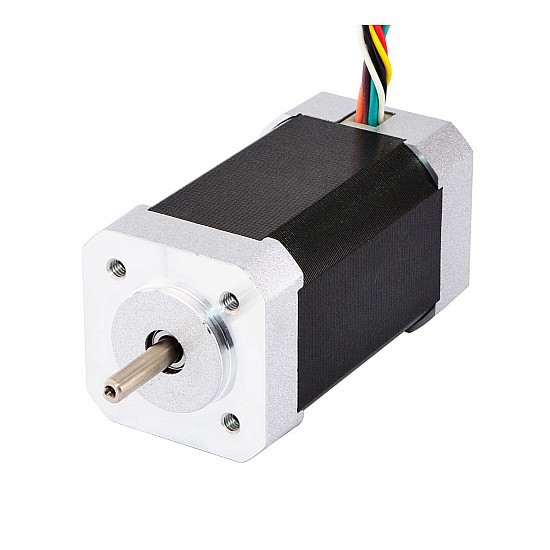

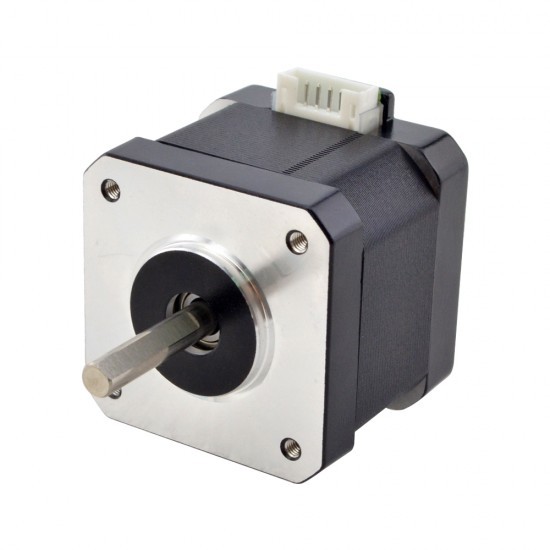

The Role of Stepper Motor Inductance and Selection Considerations
05/11/2024 at 07:20 • 0 commentsStepper motor inductance is a crucial parameter that influences motor performance. Its primary functions are as follows:
1. Energy Storage
When voltage is applied to the motor, the inductance stores energy, generating a magnetic field. Upon voltage removal, the inductance releases energy, sustaining the magnetic field's decay for a period.
- Limiting Current Change Rate
- Impacting Motor Response Speed
- Influencing Motor Heat Generation
Inductance impedes abrupt current changes. According to Lenz's law, when current changes, the inductance generates a counter-electromotive force (CEMF) that opposes the current change. This is essential for stepper motor control as the motor requires rapid current direction changes to achieve stepping motion.
Inductance reduces the motor's response speed to control signals. This is because the inductance takes time to store and release energy. For high-speed applications, choose motors with lower inductance to enhance response speed.
Inductance increases the motor's copper losses, leading to heat generation. Therefore, consider inductance value and ambient temperature when selecting motors to prevent overheating and damage.
How to Select Proper Stepper Motor Inductance
Stepper motor inductance selection involves considering several factors:
1. Motor Speed
For high-speed applications, choose motors with lower inductance to improve response speed.
- Motor Load
- Ambient Temperature
- Control Method
For heavier loads, select motors with higher inductance to achieve greater torque.
For high ambient temperatures, choose motors with lower inductance to reduce heat generation.
For control methods requiring rapid current direction changes, select motors with lower inductance.
Generally, stepper motors with inductance values between 0.5mH and 5mH are suitable for most applications. If you have any questions regarding inductance value selection, consult the motor manufacturer or the motor driver's technical support.
Summary
Stepper motor inductance is a critical parameter affecting motor performance. Choosing the appropriate inductance value is essential for ensuring proper motor operation. When selecting inductance, consider factors such as motor speed, load, ambient temperature, and control method.

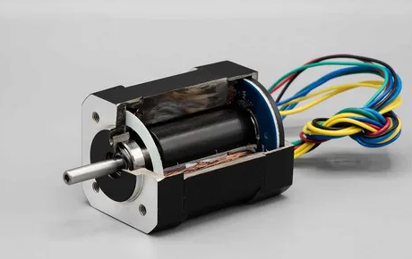

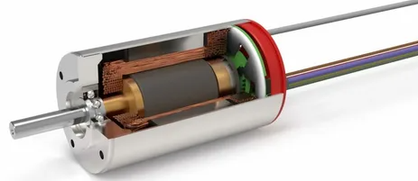

What are the components of a DC motor?
03/12/2024 at 06:48 • 0 comments1. Structure of brushless DC motor
Brushless DC motors are complex mechanical system composed of multiple parts. Its main components include the motor body, rotor, stator, bearings, end covers, magnets, encoders, drivers, etc.
1.1 Motor body: The motor body is the core part of the brushless DC motor and usually consists of two parts: the rotor and the stator. The rotor can be an inner rotor or an outer rotor, which is composed of magnetic poles, shafts, bearings, etc.; the stator is the fixed part of the motor and is composed of coils, iron cores, and motor brackets.
1.2 Rotor: The rotor is the rotating part of the motor, which consists of permanent magnets, shafts and other components. The permanent magnets of the inner rotor are located inside the rotor, while the permanent magnets of the outer rotor are located outside the rotor.
1.3 Stator: The stator is the directional component of the motor. It is composed of coils and iron cores and is the immovable part of the motor.
1.4 Bearings: Bearings are the core components that support the rotating part of the motor. Rolling bearings or sliding bearings are usually used.
1.5 End cover: The end cover includes the front cover and the back cover. It is a component used to seal the motor. It is usually installed at both ends of the motor body.
1.6 Magnetic steel: Magnetic steel is a component used to generate a magnetic field in a motor. It is usually composed of permanent magnets or electromagnets.
1.7 Encoder: Encoder is a component in the motor used to detect the rotor position and motion status. It usually includes photoelectric encoders, magnetic encoders and other types.
1.8 Driver: The driver is the core component of the motor control system. It can control the speed and steering of the motor based on signals.
2. Working principle of brushless DC motor
The working principle of the brushless DC motor is to generate a magnetic field between the stator and rotor through permanent magnets and current, thereby generating electromagnetic torque. Specifically, when current passes through the stator winding, a magnetic field is generated in the stator, and at this time, the rotor permanent magnets are subjected to magnetic forces and start to rotate. When the rotor rotates to a certain position, the driver changes the direction of the current so that the rotor continues to rotate. By continuously changing the direction of the current, the motor can be continuously rotated.
3. Advantages of brushless DC motor
Brushless DC motors have many advantages, such as high efficiency, high torque, low energy consumption, lightweight, low noise, etc. In addition, since brushless DC motors do not require the use of carbon brushes, their lifespan is also longer. These advantages make brushless DC motors widely used in robotics, electric vehicles, medical equipment and other fields.

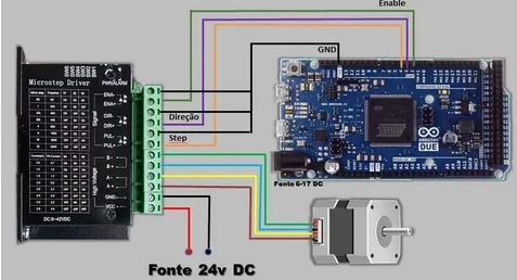

Stepper Motor Does Not Rotate After Connecting to the Driver
02/18/2024 at 07:46 • 0 commentsFirstly, you can perform the following steps to troubleshoot the problem:
1. Double-check all the wiring. You may need to refer to the manuals of both the stepper motor and driver.
Note: It's better to test the motor and driver separately instead of installing them in your production equipment to eliminate other interfering factors.Note: The wire colors in the picture are for display only. For the actual correct wiring sequence, please refer to the motor drawing !
2. Check if the power voltage and signal voltage of the driver are correct. In particular, make sure the signal voltage set by the driver matches the voltage provided by the controller. According to our feedback records, 40-50% of the motors do not turn because of this reason. Because the control signal voltage is 5V, and the driver defaults to 24V.3. Try disconnecting the ENA+/- interface if you have connected it.
4. Power on the driver without sending any pulse signals and check whether the motor is locked. If it is a closed-loop motor, you can set the driver to open-loop mode, usually by setting SW6 to on, and then check whether the motor can run. If it can run, then there is probably a problem with the encoder part.
5. Power on the driver and send pulse signals to see if the driver gives an alarm. Record the number of alarms displayed on the driver and refer to the "Troubleshooting Table" in the driver's manual to check each potential problem. Usually, you can find the "Troubleshooting Table" in the driver's manual.
6. If you have other motors or drivers, you can perform a cross-test to determine if the problem lies with the motor or driver.
7. Check whether the pulse mode setting is correct. Some drivers can be set to the type of input pulse signal (usually SW7), so you need to select the corresponding pulse mode according to the signal type provided. -

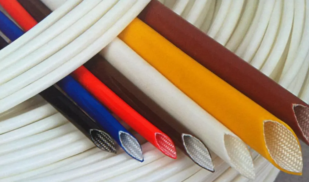

What is motor insulation made of?
01/08/2024 at 02:04 • 0 commentsIn electrical equipment such as stepper motors, closed-loop motors, and servo motors, equipment using different insulation materials has different abilities to withstand high temperatures. Therefore, general motors have a maximum allowable temperature for their operation. Now let’s take a look at insulation materials and the temperatures they withstand.
Class A insulation materials: including impregnated cotton yarn, silk, paper and other organic fiber materials, as well as enamel on ordinary enameled wires, etc., and are currently only used on transformers. The maximum allowable operating temperature is 105°C. The temperature rise of the wire group is 60℃, and the performance reference temperature is 80℃.
