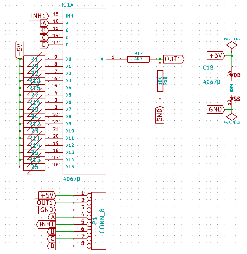

To connect the FSRs to the microcontroller I use a 16 channels multiplexer to scan through all the FSRs and which puts each FSR as the first resistor of a voltage divider; the FSR decreases its impedance with pressure, therefore I read the voltage drop across a fixed resistor which is high when fully pressed and low when barely pressed.

  • 2 × HCF4067 16 channels analog mux/demux One for each daughterboard
  • 2 × 10 K resistors These are put between the OUT of a mux and GND
  • 2 × 4.7 K resistors These are put in series between the OUT of a mux and the connector of a daughterboard

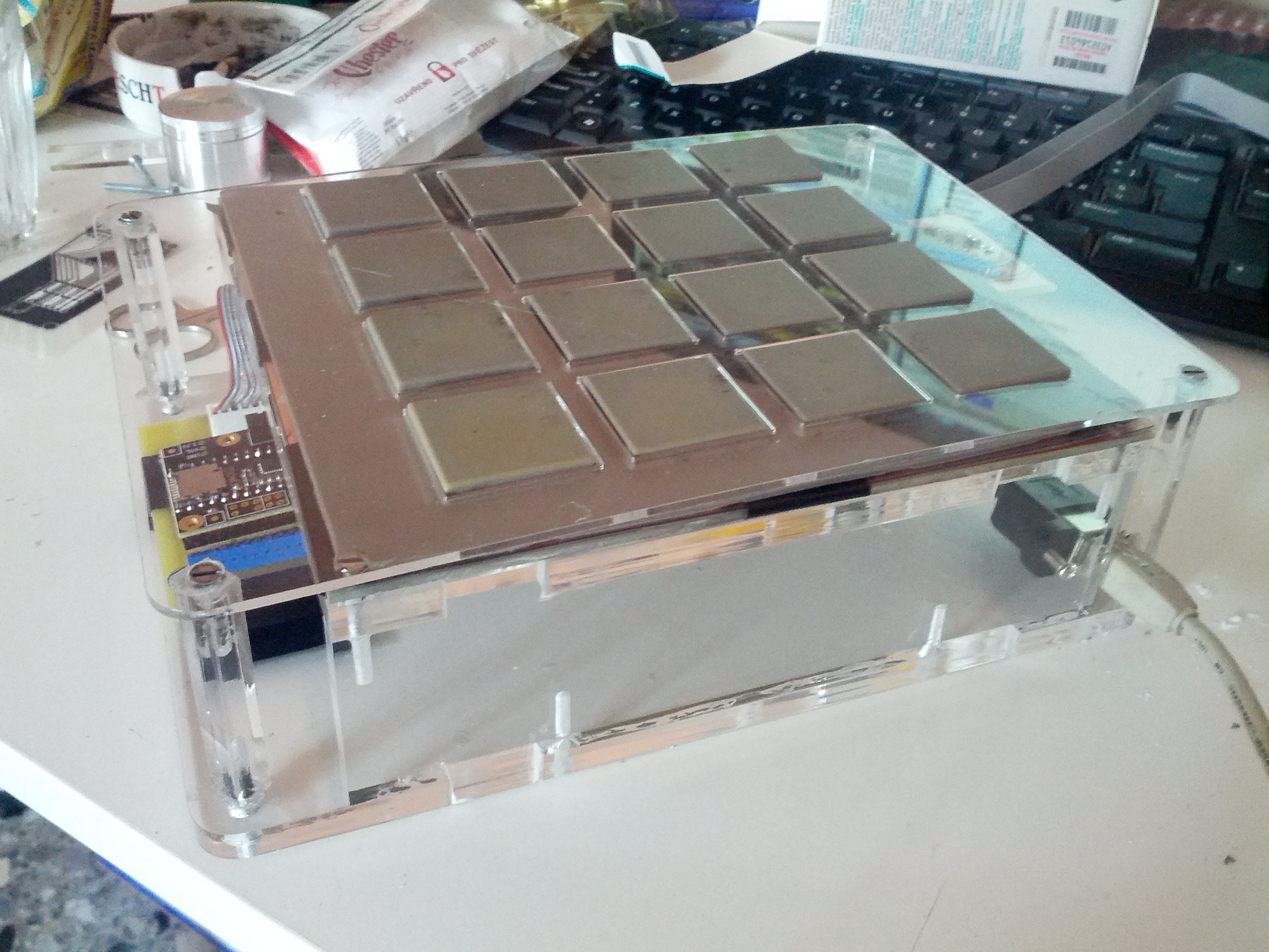

    1) I designed an acrylic enclosure which has been lasercut by an online cutting service here in Italy with very fast shipping (48h) and I managed to build it yesterday in late morning, just before setting up the expo. It is composed of 5 parts; 4 of them compose the base and the plane where the FSR PCB is sitting, all cut in 8 mm thick acrylic, while the top is made of 2 mm acrylic. It is holding up with a mix of screws and glue. I still gotta learn how to properly design enclosures, but it turned out great being my very first attempt to design one! Here's a shot:

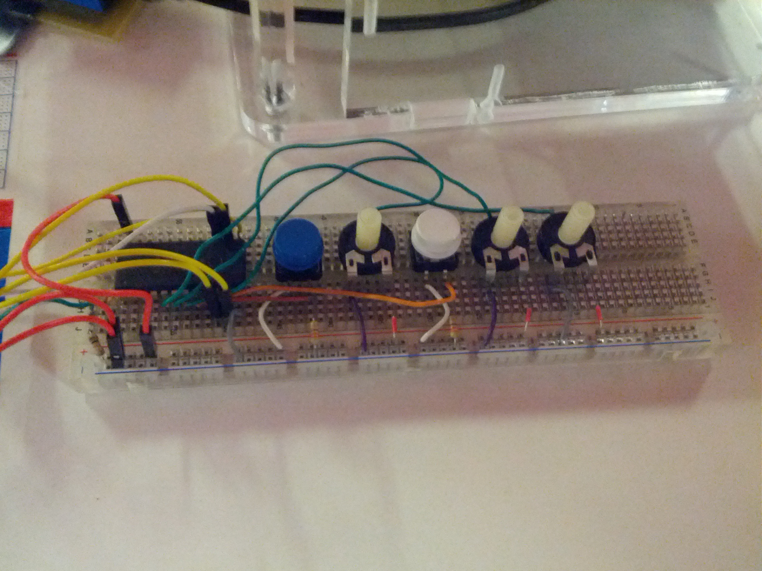

    2) I also put up a breadboard version of an expansion board which holds 2 buttons and 3 potentiometers, which have been programmed to act as follows:
    a) One button (blue) toggles between fixed and dynamic velocity control
    b) One potentiometer selects the fixed velocity value
    c) One button (white) lists through 8 different scales:
    . Chromatic (useful with MPC-like effects in Reason, for example)
    . 7 modal scales (Ionian, Dorian, Phrygian, Lydian, Mixolydian, Aeolian, Locrian)
    d) One potentiometer selects the starting playable note (from C to B)
    e) Finally, one potentiometer selects the octave of the starting note (goes from C2 to C6)

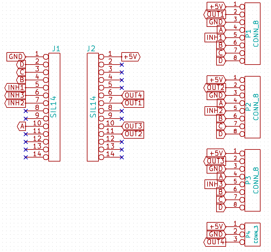

    Here are the pictures of the schematics:
    This is the motherboard:
    And this is the FSR board:
    Bear in mind that the expansion boards looks exactly the same as the FSR Board, except that there are pushbuttons and potentiometers connected to the multiplexer; in particular, one of the pushbuttons pins is put to 5 V, the other goes to the mux in and to ground through 330 Ohms to limit current, while the first and last pin of the pots are connected to 5 V and ground while the wiper is connected to the mux in.
    You can see that the motherboard has a lot of unconnected pins, and the others are connected in a strange way; the thing is that I purposely left some pins unconnected so to not interfere with the pins that should be used by a Teensy + Audio Adaptor board; in fact, I used every remaining pin on a Teensy + Audio Adaptor and it fitted EXACTLY three 16 channel mux connectors which share the same control bus, and there was also another spare analog input left; this sums up to 16x3 + 1 = 49 concurrent analog inputs; the strange ordering of the pins has been arranged to better suit my one layer PCB layout needs; this strangeness can be seen also in the schematic of the FSR board, but if you see its PCB layout you can easily understand why it had to be like that (it's easier to route the shortest path to a pin and later reassign it in software, don't you think?)

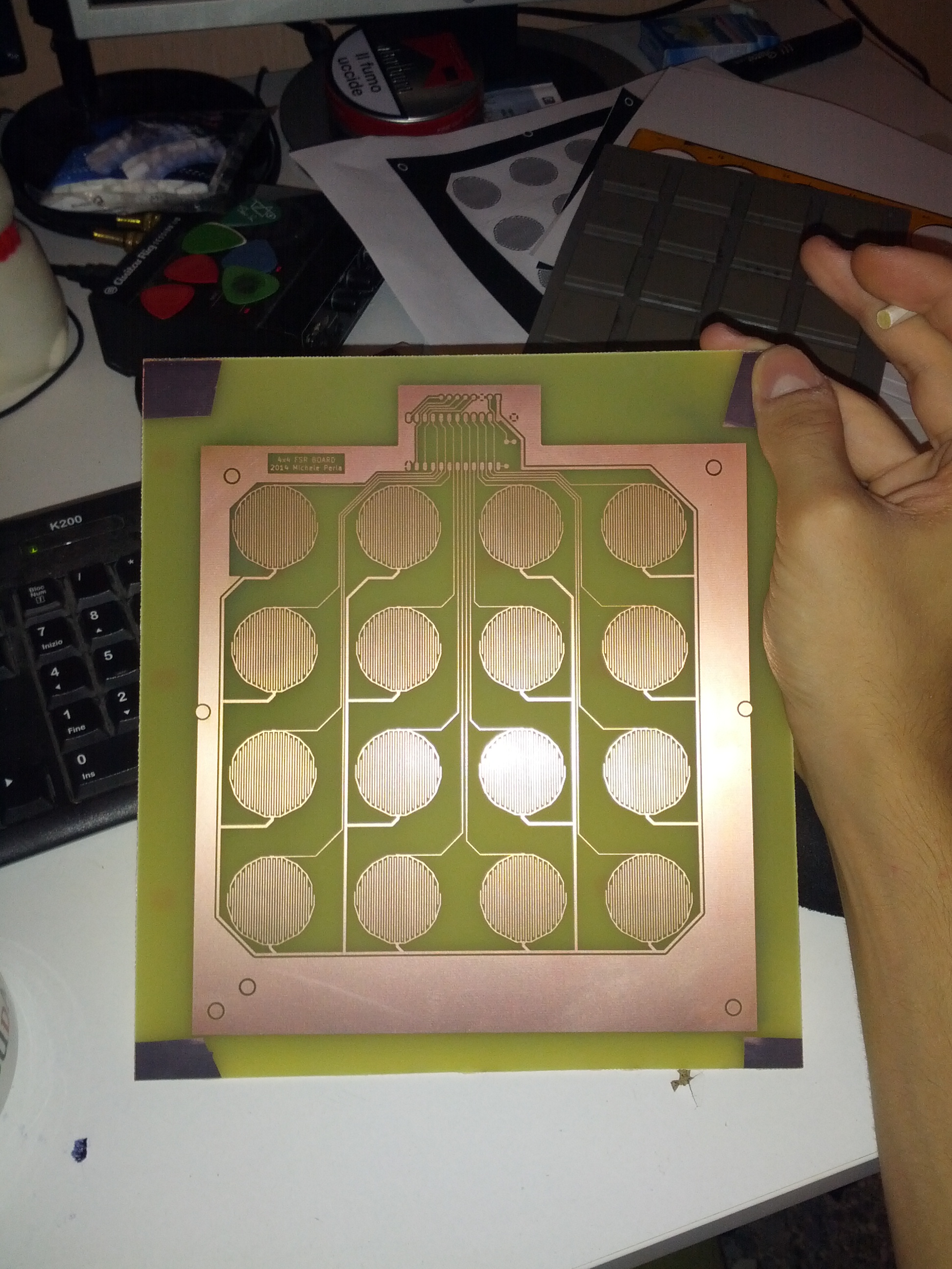

    That's why I'm actively working on Revision 2 of this project! In fact, I just printed the first working PCB of the FSR matrix! See it here below in all of its glory and copperness!

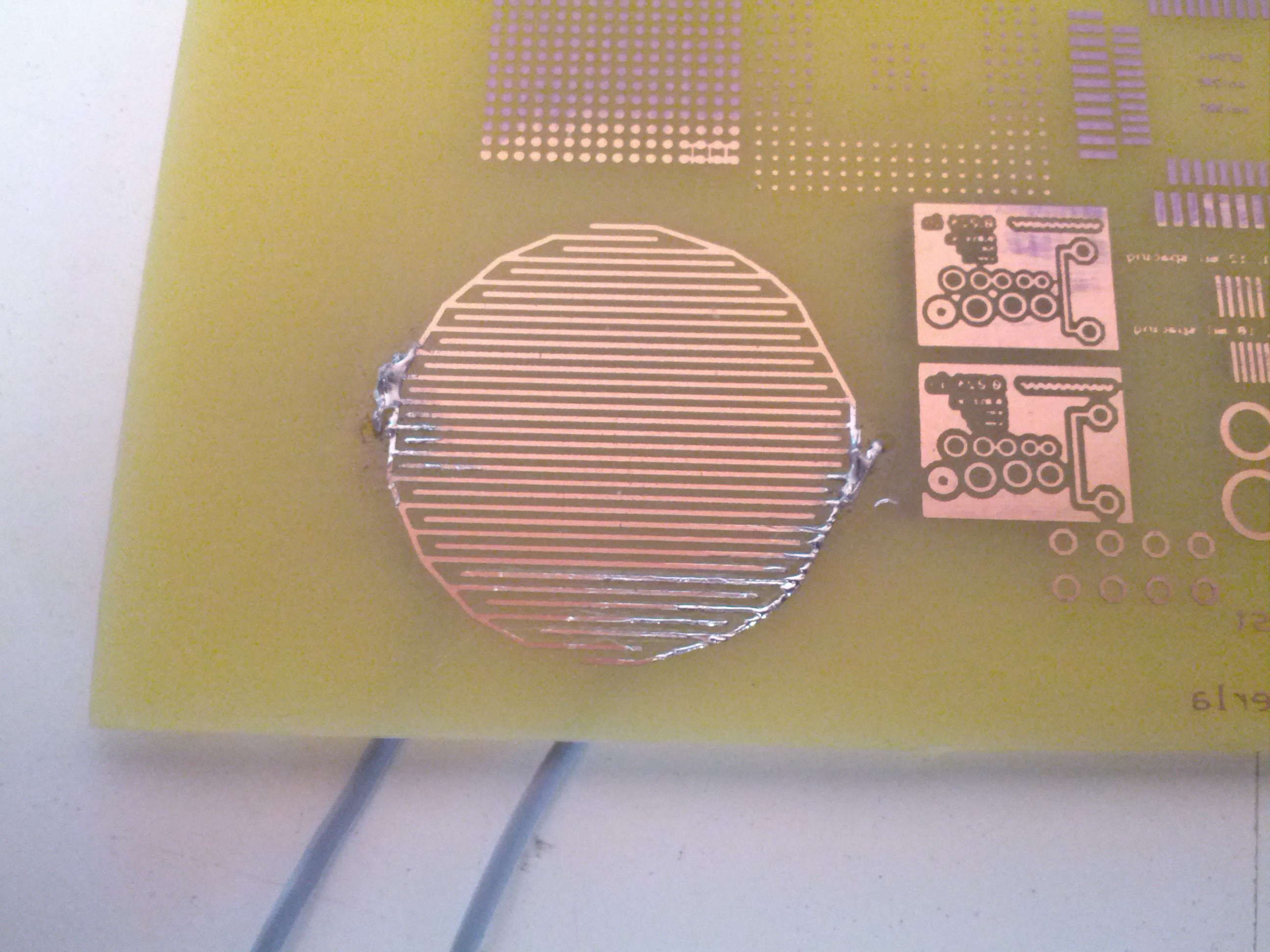

    Unfortunately I'm encountering issues with drilling holes in PCBs, mainly because it's my first time handling a Dremel and secondly because I do not have a drill press (which I will buy in the next days), therefore I managed to make two holes in a test PCB and breaking 2 drill bits, the 1mm and 0.6 mm ones, so I couldn't drill this one and I could not test it :(
    But I assure you that the pads are fully functional; in fact, the test PCB I drilled was an FSR etching test, I tried that with velostat under a pad and it works perfectly! Here's the test FSR:
    You can see cables coming out under the PCB soldered to each side of the FSR.
