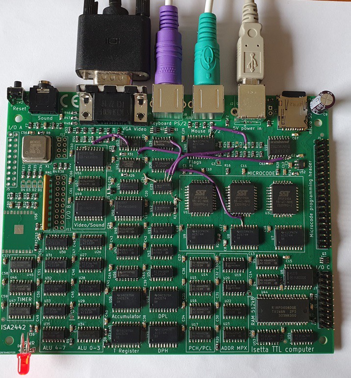

Isetta TTL computer
Retro computer built from TTL, with 6502 and Z80 instruction set. Includes video system.
For this project I decided to adhere to a wellknown instruction set. I started with the 6502 but with very little extra hardware added it also executes Z80 instructions.
The video has 320 x 200 pixel graphics with several colors, and a 80-column colored text mode. There is no microprocessor or microcontroller.
The idea for this design was born at the end of januari (2023).
While many homebuilt CPU's have their own, unique instruction set, I decided that for this project the CPU would use an existing instruction set. Also, I wanted to build the computer from parts of the TTL family. That are integrated circuits, that can perform elementary logic functions. They were first used in the 60's of the previous age. I use a modern version of these circuits, that use less power.
So which instruction set to use ? The CPU inside your laptop or cellphone is much, much too complex to build. But it is possible to use an older CPU from the time when microprocessors just became available. There were two processors that can be regarded as the Beetle and the Deux Cheveaux of the beginning of the homecomputer age.
Those processors are the MOS Technology 6502 and the Zilog Z80
The 6502 is famous because it was the heart of the Apple 1, the Apple ] [, the Commodore 64, the Nintendo NES and many others. The Z80 is well known because it was used in the TRS-80 and the ZX Spectrum.
So now, I had to decide whether to use the instruction set of the 6502 or that of the Z80. But then I thought... why not build a CPU that can do both ?
I did spend a few months searching for a good design that would give good performance while not using too many parts. I think the basic design is stable now (end of march 2023). I can now start with the details of the design.
BUILD A COMPUTER
A CPU is a nice thing, but on it's own it does nothing. It needs memory, power, and input and output devices. So I planned to build a full computer. Here are the specifications:
Specifications:
 - runs 6502 programs
 - runs Z80 / 8080 programs
 - processor speed 12.5 MHz
 - 512 kByte RAM ( 8 bit wide )
 - 24 bits wide microcode in 3 flash chips
 - programmable (upgradable) microcode
 - On-board SSD 32 Mbyte
 - video VGA 320 x 200 pixels, 64 colors
 - video VGA 640 x 480 pixels, 64 colors
 - PS/2 keyboard connection
 - Connection for ESP-01S WiFi card
 - Connection for SPI device (micro SD card)
 - real-time clock synchronized by WiFi
 - sound generator
 - blinkenlights (4)
 - general purpose I/O
 - pcb 119 x 150 mm  (4.7 x 5.9 inch), 4 layers.
 - powered by 5 volt USB input
 Components:
 - RAM memory chip
 - Three Flash memory chips
 - SPI Flash memory chip for mass storage
 - 46 TTL logic chips (38 CPU, 8 Video and I/O)
 Principles for the design:
 - No microprocessor, microcontroller, SOC, FPGA, CPLD, GAL, PAL or 74181
 - All components have good availability at the big distributors
 - Low number of components
 - No fine-pitch devices that are difficult to solder
ISETTA SYSTEM DIAGRAM
COMPUTER I/O LAYOUT
CPU TECHNICAL DESCRIPTION
Here comes the system diagram of the CPU. Most arrows and buses represent 8 wires, that means that the information flows through the processor in units of 8 bits (a Byte).
I might as well start with explaining some of the parts.
  • PCH/PCL (program counter high byte and low byte)
  • A (Accumulator)
  • T (Temporary register)
  • DPH/DPL (Data pointer high byte and low byte)
  • IR (Instruction register)
  • CGH Constant generator, generates only 0 (mainly for zpage addressing)
  • CGL Constant generator for small integer values
  • MBANK Bank selection system
You will miss the 6502 registers S (stack pointer) and the index registers X and Y. And you will miss the long list of registers that are inside a Z80 CPU. Those registers are in memory. A special memory section (outside the normal 64K range) is used for the registers.
The control section will use microcode to run the whole show. The microcode has 16 pages, 1 page is needed for the 6502 and 5 will be needed for the Z80, and the software can switch between 6502 and Z80. The microcode has room for one or two more...
boot backup 240508 - 47.31 kB - 05/09/2024 at 07:01
Download
z80 - 38.46 kB - 05/04/2024 at 15:11
Download
Isetta Z80 instruction cycles.pdf
Number of cycles for each instruction, compared to the number of the classic Z80
Adobe Portable Document Format - 114.83 kB - 05/03/2024 at 09:49
Preview
Download
Isetta 6502 instruction cycles.pdf
Number of cycles for each instruction, compared to the number of the classic 6502
Adobe Portable Document Format - 91.32 kB - 05/03/2024 at 09:48
Preview
Download
z80 - 31.82 kB - 05/02/2024 at 17:28
Download
View all 16 files
  • Moving Z80 binaries to Isetta and run them
    roelh4 days ago 0 comments
    Next step is the loader program. It will be a Z80 program, running on Isetta, that uses the console char I/O, so now it is controlled from the RPi console but in the future it can be controlled from PS/2 and VGA.
    This loader program will be in the microcode ROMs, and some microcode will download the loader into the RAM soon after reset, and then start the Z80 loader.
    What must the loader do ?
     - download program files from RPi into the Isetta memory, through the 'keyboard interface'
     - start a program
     - inspect memory and change bytes in memory
     - read a file from serial flash (to automatically start software in the future)
    Need an assembler !
    I found a nice online Z80 assembler:  https://asm80.com
    Written by Martin Maly, Prague: https://hackaday.io/adent
    It can also assemble for the 6502, that can also be useful in my project.
    The assembler generates Intel format binary (.HEX), like this:  (spaces added)
    : 10 E000 00 31FEFFC325E04FD3317928FAC9DB3128 2F
    : 10 E010 00 FCC97EB7C8CD06E02318F7CD0DE077FE 2A
    : 10 E0E0 00 20202020202020202F72756E20617420 97
    : 10 E0F0 00 68686868000D4973657474612070726F 98
    : 0E E100 00 6772616D206C6F61646572002A00     A9
    : 00 0000 01 FF
    So the structure is: <:><nr-of-bytes><address><record-type><byte-sequence><checksum>
    See: https://en.wikipedia.org/wiki/Intel_HEX
    The Javascript microcode generator has now the ability to read this intel hex format, in order to include the loader/monitor in the microcode.
    Another change to the Javascript simulator was giving it char I/O according to new KB, TX standard.
    Now came File transfer from RPi to Isetta, to load the Isetta memory with a Intel Hex file. In the Isetta loader you have to type a "Load File from Host" command, "F" followed by filename. Isetta then sends %Dfilename%  (D is the command: download). So '%' is used to introduce the file name and start the download. For just sending a plain '%' to be displayed, it must be doubled to "%%".
    The data has to travel over the link to Isetta, and that is not very fast. So I did a simple change, replacing every two hex digits by a single byte. In this new format, it uses '=' instead of ':' at the beginning of a line.
    RPi will now send the file.  Since the values 00 and FF can not be transported over the link, they are escaped with '['. And because values 00 and FF can occur quite often in machine language, all bytes are first XOR'ed with 0x40, so:
    Sending from RPi:
      - xor with 0x40
      - if 00 replace by <[><A>, if FF replace by <[><B>, if [ replace by <[><[>
      (send it)
    Receiving at Isetta:
      - if [, get another byte, if A then -> 00, if B then -> FF, if [ then -> [
      - xor with 0x40
    This transformation does not apply to the '=' at the start of the line. and to the 0x0D at the end.
    The record type, 0 for a normal record and 1 for the end, has many unused values, so that can later on indicate if the bytes must be loaded into another memory bank. TBD.
    And the recordtype could be used to store target cpu 6502/z80/... (but it is more practical to define that every program is a Z80 program. A program for 6502 should simply start with an instruction that switches to 6502). Recordtype 0x99 indicates 'file not found'.
    During transfer, Isetta transmits readable progress messages on the console: at every 128 transferred bytes it displays the current address. It can also terminate the transfer with a special %X sequence (in case of error).
    So, now it is possible to assemble Z80 programs online, send the binary to Isetta, and execute it there !
  • The real hardware runs Apple 1 Basic !
    roelh04/19/2024 at 19:07 0 comments
    A major milestone was reached today ! The original Apple 1 BASIC, programmed by WOZ, is running on the real Isetta hardware ! It runs on the intended 12.5 MHz (80nS cycle time).
    For character I/O, there is a synchronous serial link with a Raspberry Pi. The screen and the keyboard of the Raspberry Pi are used to communicate with Isetta.
    Here you see a screenshot of the RPi screen.  After the ">>" (generated by the RPi) the RPi reads a full input line, echoing it on the screen. Then, after a CR (return), the line of characters is sent to Isetta Apple Basic, and Basic again echoes the characters to the screen. Then the output of the Basic interpreter follows, and the Basic prompt ">". Note that there is an "*** END ERR" because there is no END statement at the end of the program.
    PROGRAMMER
    Quite some work had to be done after the prototype was soldered. I had to make a Python program on the Raspberry Pi to program the microcode into the three microcode flash chips. On the programmer board  (described in the previous log) a small change was needed. This Python software can also execute arbitrary microcode on Isetta, and run a test program that tests hardware functions.
    The programmer can grab the clock of Isetta, by putting the first 74AC163 clock divider into LOAD mode, and providing a new clock (SW generated by RPi) to the first two preset inputs of the 163. The transistor that transferred this clock was, unsurprisingly, not fast while switching OFF, and I suspected that was the reason that I sometimes got a bad working instruction during singlestepping. This transistor also did the 3.3V to 5V translation. I replaced it by a simple diode with a 1N5 cap in parallel. It's a poor man's level converter. At the high RPi 3V3 level, 0.7 V is added by the diode so the ac163 sees around 4V on its input. That worked, errors now occurred rarely, and could be handled by a retry mechanism in the programmer.
    How does the application program (the 4K Basic interpreter) get into the main RAM ? I could modify the programmer such that it writes to RAM instead of microcode flash. But I already had a mechanism in place that would also work with a fully stand-alone power-on and reset. A certain part of the microcode copies the BASIC interpreter program from the microcode flash to the main RAM, soon after reset.
    COMMUNICATION
    Next thing was communication (characters in, characters out) between RPi and Isetta. It should also work when Isetta  generates VGA output, so we are handling a single bit directly after the horizontal interrupt. (That is generated by a simple hardware timer).
    The bit handling should always take exactly the same amount of cycles, independent of the data send or received, otherwise there will be jitter in the generated VGA output.
    When the VGA output and keyboard are working, we still need this interface to the RPi to transfer files to or from Isetta. We could also use the RPi screen as debugging output while an application runs on the VGA screen.
    Since it should also be possible that a PS/2 keyboard is connected to Isetta, the choice was made to use the same receiver hardware and software for the keyboard as well as for data coming from the Raspberry Pi. Since it uses open collector outputs, both clock and data signals can simply be tied together. This combination was not foreseen when the PCB's were designed, so a few wires had to be added.
    Communication RX receive driver
    The keyboard has two lines, KB_CLK and KB_DATA. Both lines are driven by a open collector output on a standard PS/2 keyboard (pullup resistors in Isetta). If no information is sent, both lines are high. The keyboard receive driver will be able to receive scancodes that are sent by the keyboard. It has the following states:
    • Wait for startbit. If the clock line has a falling edge, and the KB_DATA line is low, the startbit is valid and we proceed to the next state. If the data line is high...
  • PCB and parts arrived !
    roelh03/11/2024 at 14:16 0 comments
    I received the PCB's ! These PCB's were sponsored by the kind people of PCBWAY. As always, they are of a very good quality.
    And I also received a big bag of parts:
    Warm up the soldering iron !
  • PCB finished, Logisim simulation, and programmer
    roelh02/22/2024 at 20:25 0 comments
    LOGISIM simulator
    The design was only tested on the logical level, in the Javascript simulator. Before making a PCB I wanted some form of confirmation more on the hardware level, so I entered the design in the good old Logisim.
    Nowadays there is a further developed version, called Logisim Evolution. I tried it by loading one of my old designs in it. It became a big mess with long hex-sequences appended to my net names, and many shapes not displaying correctly. And indeed, Evolution is no longer compatible with the old file format. That's a pity, because I had quite a lot TTL devices converted to Logisim circuits.
    So I stayed with the old version, 2.7.1, so I could use my library of TTL components. And I found a few mistakes in my design. Also found a way to save a chip on the generation of the horizontal sync pulse.
    But it is slow. At it's top speed (Logisim says it is 4100 cycles/sec), when you type a short line of Apple Basic, you have to wait one minute before the prompt reappears !
    PCB Finished
    I finished PCB design. Here is the nice 3D preview of KiCad:
    It is 119 x 150 mm  (4.7 x 5.9 inch), 4 layers.
    Microcode Programmer
    I also needed a programming interface. Previous projects used the Raspberry Pi for that. The Pi has enough GPIO pins to accommodate the 8 or 16 bit wide Flash memories of those projects. The interface was not much more than a small universal board, with resistors for 5-to-3.3 volt conversion.
    But in the Isetta the microcode flash memory is 24 bits wide. That is almost all I/O that the Pi has, not leaving enough for control signals. So now I use 8 bits I/O from the Pi. The data going to Isetta is first transferred to three HCT574-type registers (the HCT will also translate 3.3V to 5V), and then it can be transferred as one 24 bit value to Isetta. For data going to the Pi, there are three LVC244 chips to convert 5V to 3.3V. Only one of the LC244 is enabled to transfer its value to the Pi. There are two more LVC244, one for the databus and one for control signals from Isetta to the Pi.
    The new RPi programmer is only required once, to program the microcode. The program for the 6502 or Z80 can reside in RAM, and can be programmed in BASIC or any other convenient language.
    The Raspberry Pi has the following control outputs to Isetta:
    • Disable the data output of the 3 Flash chips
    • Give a programming pulse to the 3 Flash chips
    • Take control of the Isetta CPU clock signal
    • When it has control, send a clock to the Isetta CPU (to single-step it).
    The RPi also has a few serial lines to/from Isetta, intended for character read/write so you can use the RPi as a terminal as long as Isetta has its video and keyboard interface not yet working.
    Here is how it looks. Isetta connects to the left side, and the RPi to the right side. It also has LED's for the 24 microcode signals (with explanation on the pcb), and LED's for the databus and the instruction register. The LED's will also work if the RPi is not connected. It is a 2-layer board.
  • PCB design progress
    roelh02/14/2024 at 14:22 0 comments
    Here is the current state of the design, it's almost finished. The Flash chips had to change from DIL to PLCC, because the required 55nS speed is not available in DIL.
  • Re-started PCB design, in SMD
    roelh01/28/2024 at 09:20 0 comments
    Since I last worked on the PCB design, there have been many changes.
    And after looking at the availability of the chips, I found that several of them were not in stock (in DIL version). And since the design has become faster, it is not as easy any more to switch between the TTL logic families, because for many chips, the speed is critical.
    This made me decide to switch to SMD devices. Only the microcode flash chips will stay in DIL, so they can be easily taken out to program them (although there will be a system to program them while they stay on the board).
    Here is a preview of the new design:
    Dimensions are 12 x 15 cm ( 4.7 x 5.9 inch). It will be a 4-layer board. It is designed to fit in a Hammond RM2055S enclosure.
  • Less parts and higher speed
    roelh12/04/2023 at 20:36 0 comments
    It's been a while since I wrote a log. In this log I will tell you what happened to the design in the past months.
    BYPASS
    The design has a few buffers that implement the "bypass". This can place the address registers on the databus, so we can inc/dec them, or store them to T and then to memory. This is also the path to store the program counter (pch/pcl) for a CALL instruction. And it is used to add the offset to the PC in case of a branch.
    As always, I was looking for components to remove, to get a low-component-count design. And indeed, we can do without the buffer for the low address bus ! We can simply put a 1-to-1 table in a zero page of memory, and an access to this table will give us the register value on the databus. The high address bus must be 0 to access this table, that it is already an existing function.
    We have 8 memory banks, so there is a maximum of 8 zero pages, enough space in zero page. One of the zero pages already has a table for right-shift.
    For the high byte, this is less useful, since the table would be scattered through memory, occupying one byte in every page. That is not a good idea.
    But...  the only register that we need from the high bus is PCH. And the PCL bus is not loaded from the result bus, but from the DPH register (in this picture, that is. It was later changed to come from the T register).
    If we modify it, and load the PCL register from the PCH register, we can access the PCH contents by loading it into PCL first ! In fact, when we write a new value to PCH we will at the same time (with the same signal) write the old PCH contents to PCL.
    For doing a jump, first write the LSB to PCH, and then write the MSB to PCH (that will move the LSB from PCH to PCL). And for a CALL, first save the PCL address through the 1-to-1 table, via the ALU, to T. T is then stored to the stack. After the LSB of the subroutine address has been written to PCH, the old PCH is in PCL and can now also be saved to stack.
    The control signal for the bypass is obviously no longer needed. Used it later to double the amount of RAM-based registers.
    The 1-to-1 table in RAM is built by microcode, directly after reset, in the same loop that fills the right-shift table.
    Changes for this were done in the simulator and the microcode generator.
    SPEED
    In october I did some timing calculations, using the typical values for 74AC logic. (These typical values are only in Fairchild datasheets, not in the Texas Instruments datasheets).
    I was a bit surprised to see, that with some measures, the clock speed could be doubled to 12.5 MHz !
    We would need a 10nS RAM. Circuits in the address bus needed a few changes to make it faster. One of the address signals (for the CGL register) came from a 74HC238 1-to-8 decoder that had a quite big delay. It was used to extend the number of memory-based registers. This way of extending the number of registers was dropped (replaced by a directly available microcode control bit). This HC238 also delivered a signal to select SUB and a signal to select  DEC in the ALU. This could be changed to a single signal for both SUB and DEC. Other functions in the HC238 could also be solved in a different way. The HC238 could be removed.
    The circuits for the flags had to change, in the design the CY-out of the adder sometimes had to pass four devices before a flag result could be clocked-in in its register. The flag system was changed such that the adder-cy-out is used at only a few places. The condition-selector can choose it, and in a group-1 instruction it can be put into the C flag. The adder-cy-out now only has to pass 2 devices. The last of these is a 74HC4053 analog switch, that is slow in switching to the other channel, but relatively fast to pass a signal. Since the switch channel can be setup at the start of the cycle, it is expected to be fast enough.
    The adder-cy-out signal is called TC (temporary carry) in the microcode. For group 1 instructions,...
  • Colors
    roelh08/24/2023 at 18:34 1 comment
    This computer will have 64 colors (2bits red, 2 bits green, 2 bits blue).
    I was curious what the colors would look like, so I made a kind of three-dimensional plot with dimensions red, green and blue. It became a cube, built from 64 small bricks. If we look at the cube with the black brick pointing to us, we see this:
    So, starting from the black brick going to the right, we see increase in the red component. To the left, we see increase in blue component, and from black going down we see increase in green component. At the circumference we see the bright rainbow colors, and the remaining colors are darker versions of the colors.
    At the opposite side of the cube (unvisible in the above picture), we have a point where the amount of all primary colors is maximal. That is the color white. If we look at the other side of the cube we see this:
    At the circumference we see the same bright rainbow colors again. The remaining bricks are the lighter versions of the rainbow colors.
    But we did not see everything ! At the inside of the cube, there are 8 bricks that we didn't see yet. These are light-grey, dark-grey, and a grayish version of the primary colors:
    So here we see the eight hidden bricks, shown from both sides.
    The following table shows these colors, numbered from 0 to 63, and also with their hexadecimal web color. The first column has the grayish colors, and black, white and the two greys are at the bottom:
    So this table will be a help if I ever come so far to program colored stuff for my contraption.
  • Video system
    roelh08/22/2023 at 18:51 0 comments
    The Isetta video system will now be described.
    GENERAL
    The generated signal is a VGA signal with a maximum resolution of 640 x 480 pixels.
    The timing is:
      25.175 master clock
      approx. 40nS per pixel (for 640 pixels/line)
      approx. 32uS scanline
    A whole scanline has a width of 800 pixels (only 640 pixels used)
    A whole frame has a height of 525 scanlines (480 scanlines used).
    Exact values can be found here.
    The isetta can work with maximum or reduced horizontal resolutions:
    • 40nS per pixel (for 640 pixels per line)
    • 80nS per pixel (for 320 pixels per line)
    • 160nS per pixel (for 160 pixels per line)
    In the vertical direction, scanlines can be repeated (to keep the pixels almost square, also when a lower horizontal resolution is used), giving:
    •  480 lines, or
    • 240 lines (480 divided by 2), or
    • 120 lines (480 divided by 4)
    There are 64 colors (but the color can not be freely chosen for every pixel).
    HARDWARE PRINCIPLE
    The Isetta processor runs with a cycle of 160nS (6.25 MHz). The video output is directly generated by the processor, so during every instruction, one or more pixels must be generated:
    • 1 pixel/instruction (for 160 pixels per line)
    • 2 pixels/instruction (for 320 pixels per line)
    • 4 pixels/instruction (for 680 pixels per line)
    Isetta contains a hardware timer that triggers an interrupt at the beginning of every scanline. At the beginning of the visual part of the screen, this interrupt transfers control to the microcode that has the video instructions to give screen output. It can also initiate the generation of the frame sync pulse (the line sync pulse is generated by the hardware timer). If the interrupt is outside the visible area, the interrupt code will only increment the line counter, and return to the interrupted program almost immediately.
    A video instruction will get a single byte from the RAM, and gets color information, pixel information, and sometimes control information (flags) from that byte.
    The microinstruction fetches this byte from the indicated RAM location.
    The RAM is normally addressed with the (PC++) mode (Of course this requires that the PC that was used in the Z80 or 6502 program was saved when the interrupt is entered).
    The color information is 6 bits. The instruction can store the color in register T (foreground color) or in register A (background color).
    Information about a pixel is only 1 bit. If that bit is 1, the color of the pixel comes from register A. If the bit is 0, the color comes from register T.
    We now come to the basic byte formats that are used for the video system.
    • Color definition:
    Byte format: -cccccc-
    The 6 color bits 'cccccc' can be transferred to the T (Foreground, FG) or A (Background, BG) register.
    • 320 pixels/line :
    Byte format: a------b
    Two pixel bits 'ab' select the two pixels to be used in 320 pixels/line mode. These pixels are placed in the 4-bit 'pixel register' as 'bbaa'. The pixel register is loaded at every instruction, so the information is only available in the next cycle.
    • 160 pixels/line :
    This format is the same as the 320 pixels/line format, but in this case the bits a and b simply have the same value.
    • 640 pixels/line :
    Byte format for 4 pixels: --pppp--
    Four pixel bits 'pppp' select four pixels to be used in the 640 pixels/line mode. These pixels are transferred to the DPH register, and the output of this register is connected to a multiplexer that selects the correct pixel to be displayed. The 'pppp' bits are in bit5, bit4, bit3 and bit2 of the byte. The pixel register is connected to other inputs of the same multiplexer.
    Byte format for 2 pixels:  ab-----1
    This 2-pixel byte must be loaded with a SHL (shift left) instruction, while shifting a '1' into bit0. That will put the bits in the 4-bit pixel register as '11ab'. The '11' section defines background color (in register A).
    • Select pixel register or DPH register:
    One of the bits in the microinstruction ( ctl_reg1...
  • Started KiCad layout
    roelh08/06/2023 at 10:49 2 comments
    This is the first project where I use KiCad (version 7.0.2).
    Schematic entry was quite smooth, but with the pcb layout I experienced some problems. It was difficult to arrange the components on a 0.1" grid. And since I do everything on a 0.1" or 0.05" grid, it is annoying that KiCad displays things like cursor position only in millimeters. [ Edit. You can set this to inches, see comments ].
    Routing is not very difficult, but I miss certain functions. But it is possible that I do not yet know all commands for routing.
    But don't get me wrong, I think the KiCad developers did a great job !
    Here is the current state (you can click on the picture to get more detail) :
    The lower part of the pcb is routed. For the rats nest I use several colors:
    • red, VCC
    • blue, GND
    • light blue, databus
    • green, address bus, micro-address bus, internal ALU signals
    • magenta, microcode bus
    • yellow, operand bus
    • orange, result bus
    • white, several control signals
    This is far from finished, especially I/O components must still be added.
View all 19 project logs
Con Cunningham wrote 04/21/2023 at 21:11 point
Just  been reading your square inch TTL CPU - great work. Did you publish your microcode, or is that proprietary ? Curious how you managed such a rich ISA with so few control signals!
roelh wrote 04/22/2023 at 18:08 point
Hi Con, the microcode can be seen when you scroll down on the simulator page:
http://www.enscope.nl/simas_nac/
Did you read the logs ? If you also look at the schematic,  ( https://hackaday.io/project/161251-1-square-inch-ttl-cpu/log/154913-schematic-of-the-cpu ) you should be able to understand how it works.
Con Cunningham wrote 04/21/2023 at 20:51 point
I honestly don't know - perhaps when I get to wire-wrap some of it, and it starts to operate I might do so. Yes indeed, I use the 74181 as a 16 bit address incrementer, and of course, for all of the other 6502 arithmetic and logical ops.  Keep up the good work.
Con Cunningham wrote 04/20/2023 at 21:03 point
An ambitious project. I know this because I have been working on something similar (When work allows) for some months. I am on my 3rd iteration. This time I have based my design roughly on Tanenbaum's "Structured Computer Organisation" , see https://csc-knu.github.io/sys-prog/books/Andrew%20S.%20Tanenbaum%20-%20Structured%20Computer%20Organization.pdf
I am using 74LS TTL, and have opted to make life easy by using 4 x 74181 as a 16 but ALU. I hope to implement all of the 6502 ISA, with the exception of Decimal Mode.
Have you begun to use a simulator, such as Logisim or Digital yet?
I wish you the very best of luck with your project, keep the updates coming!
Con
roelh wrote 04/21/2023 at 20:03 point
Thanks Con !  I'm curious about your project. Will you publish it on Hackaday ? I suppose you will use the 4 x 74181 as address incrementer ? Yes I will soon start simulating.
