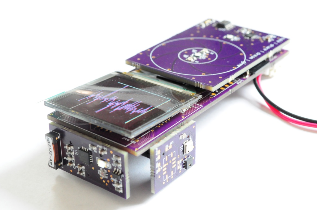

The Arducorder Mini is an Arduino-compatible handheld sensing device, and the next iteration of my open source science tricorder-like device project that's designed to be easy to use, have a large array of sensors, and easy to share sensing discoveries. The Arducorder Mini is designed to foster a community of open source users and development, and is ChipKit MAX32 compatible, which is a port of the Arduino platform to the much more powerful PIC32 family, and makes use of a PIC32MX795F512L with 128k of RAM, 512k of flash, a zippy 80Mhz processing speed, and a fantastic set of peripherals for interfacing to sensors.
The current prototype is designed to use a 1.5" OLED with 128x128 pixels and 16-bit colour, a touch interface, and connectors for 5 modular sensor boards that each contain several sensors. The sensor boards are designed to be interchangeable and upgradable, so that a large number of configurations are possible with different sensing capabilities and price points.
While the Arducorder Mini is being designed with a wide array of sensing capabilities off-the-shelf, it's also designed to be easy for folks to tinker with and upgrade. Accessibility is a central goal of the project -- If you're familiar with Eagle CAD and have ever made an Arduino shield, it should be easy to design your own sensor board. Using OSHPark and Digikey, the parts cost for a new sensor board (PCB and header, not including sensors) is about $5, which is even less than most protoboards!

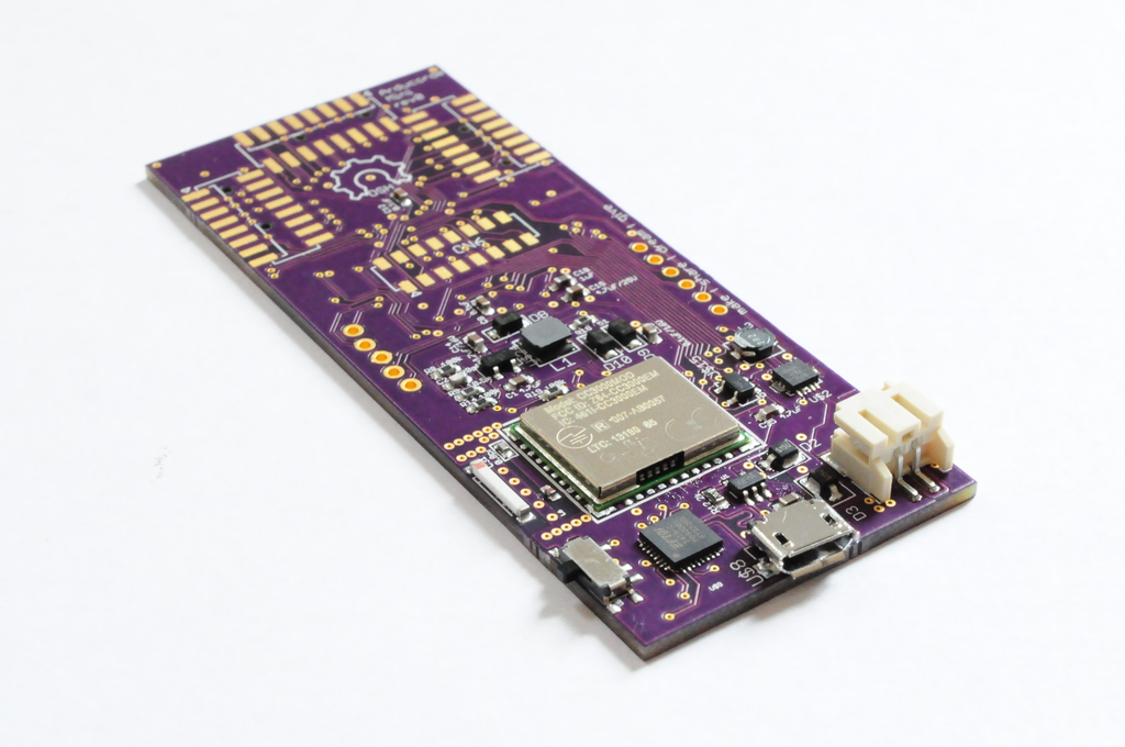

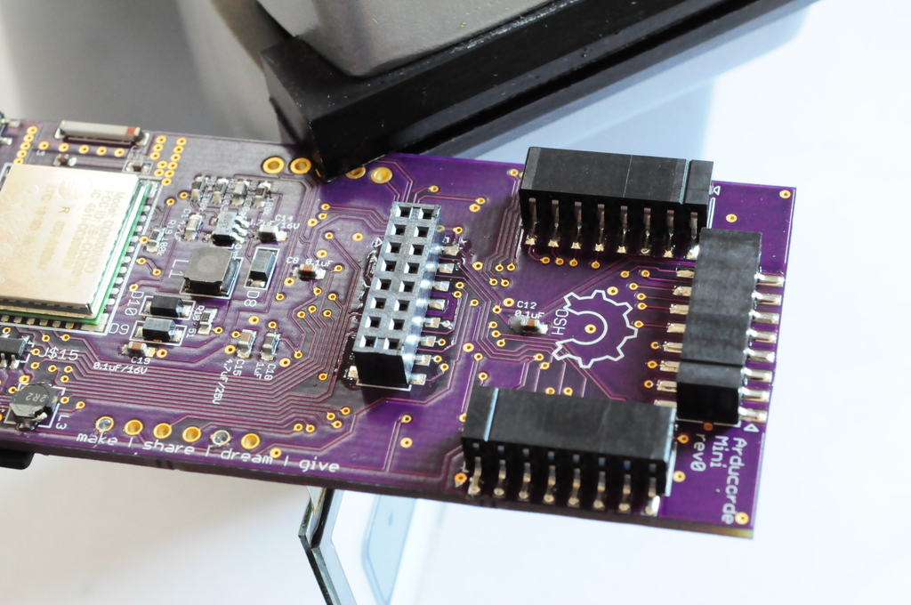

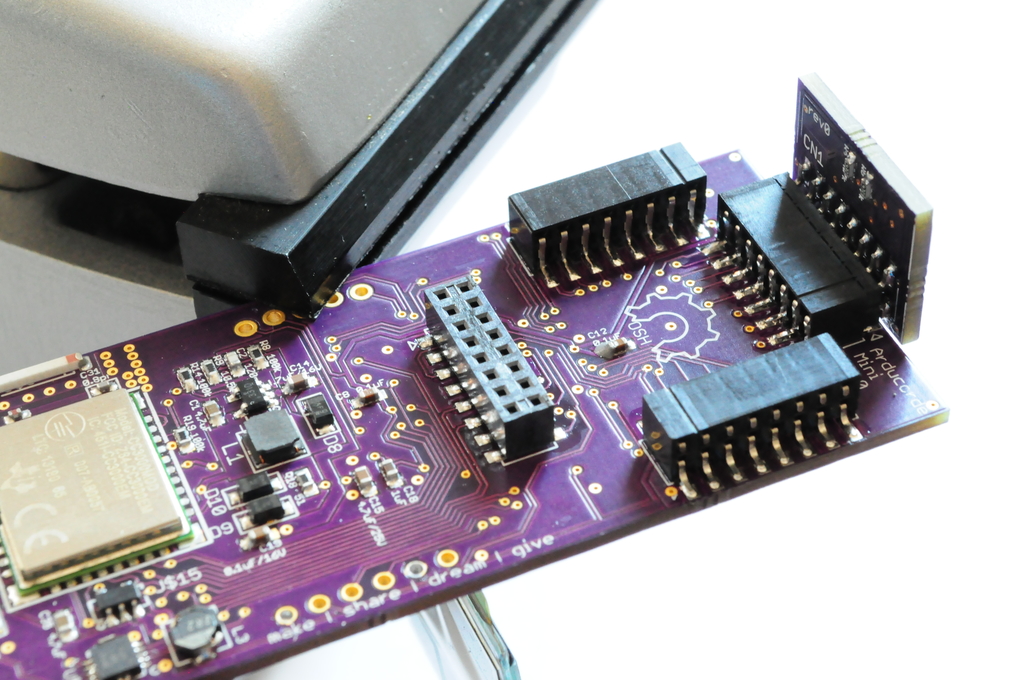

    Motherboard
    I confess that when I designed most of the first revision boards, I failed to include mount points on the motherboard and capacitive touch board that would allow the whole thing to be placed in an enclosure! This was a bit of an issue, since the motherboard is only 2-layers, and so densely populated that I had to increase the size a small amount (4mm in both width and height) to accommodate four M2 mounting holes. If I was willing to increase the PCB specifications to 4-layers the board would have been significantly less dense and made mounting much easier, but I'd like to keep the specifications as low as possible so that the boards can be made inexpensively, and the open source community can easily modify the designs with the free version of Eagle CAD. I remember years ago reading that when Stephen Hawking was writing A Brief History of Time, his publisher told him that his readership would be halved for every equation he placed in the book. I feel the same about open hardware -- for every barrier I place on people easily modifying the hardware -- expensive software, 4 layer boards, etc -- that it will reduce the reach by at least an order of magnitude. So I'm trying to keep it simple and accessible.
    Other than mechanical considerations -- the four mounting points, and switching to a connector for the capacitive touch board itself with mounting holes -- there are a few minor schematic changes for the motherboard:

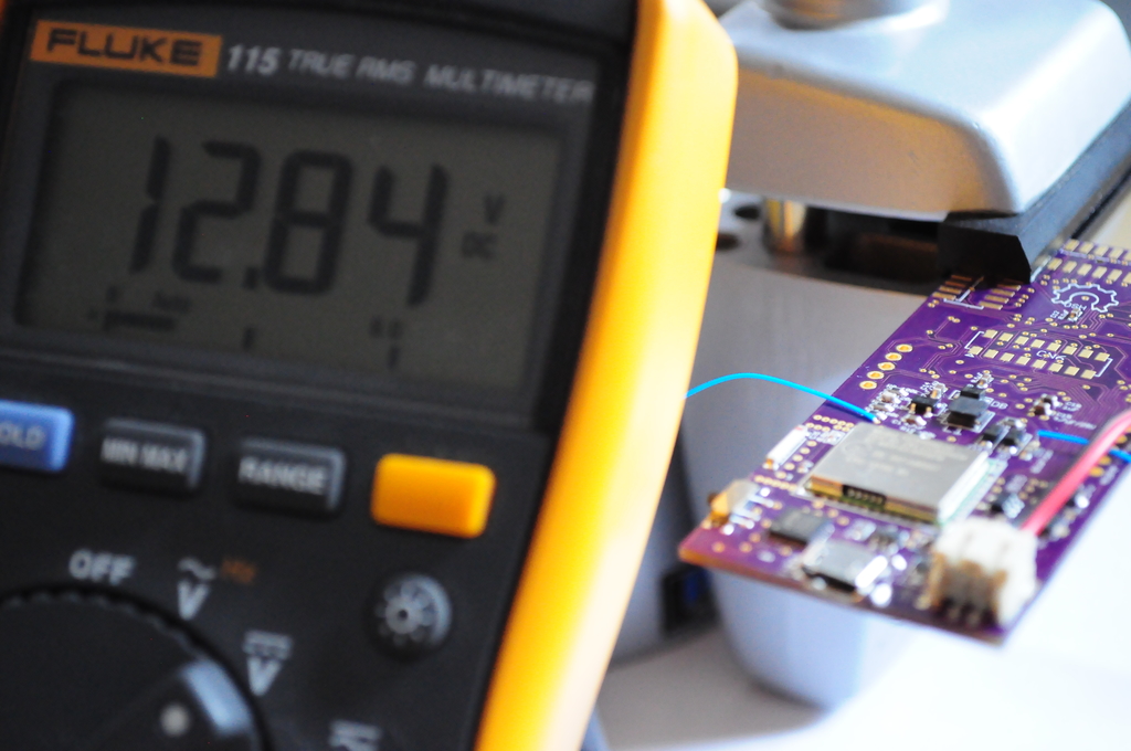

    • Added I2C pullup resistors on motherboard
    • Fixed VCC/GND pin swap on two sets of the PIC32 pins
    • The OLED 13V booster VIN is now sourced from the 3.3V regulator instead of the battery. When sourced from the battery and the booster was disabled, the OLED 13V line would be equal to VBAT, causing a few pixels to stay on, and draining the battery a bit.
    These are largely minor changes, and the technical challenge is largely in rerouting big chunks of an existing board for the modifications.

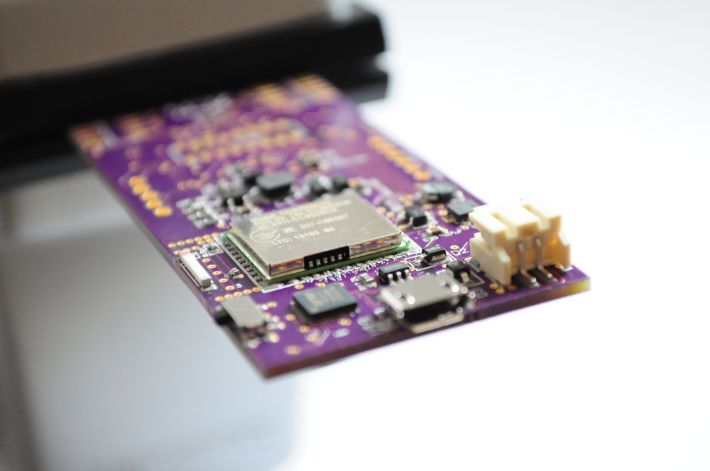

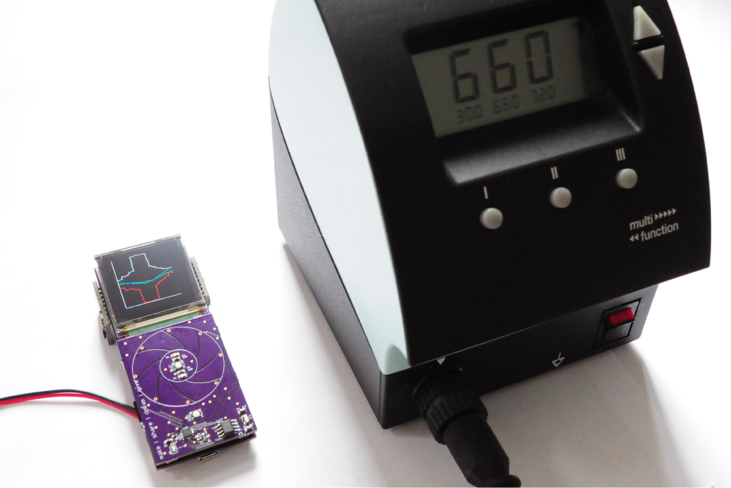

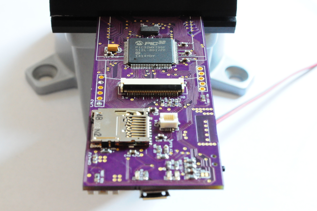

    Step 1: Motherboard Assembly and Programming

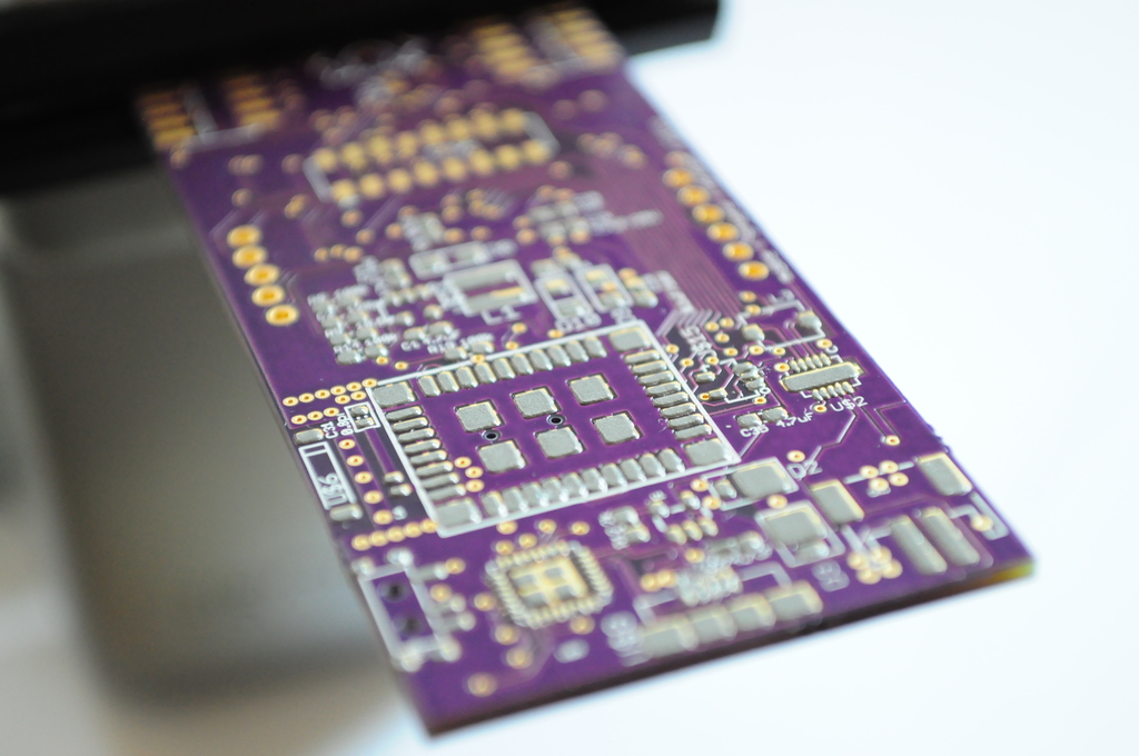

    I designed all of the boards to be hand solder friendly, with leadless QFNs all on one side (that can be reflowed). If the other side has components, these are usually larger and easier to hand solder.

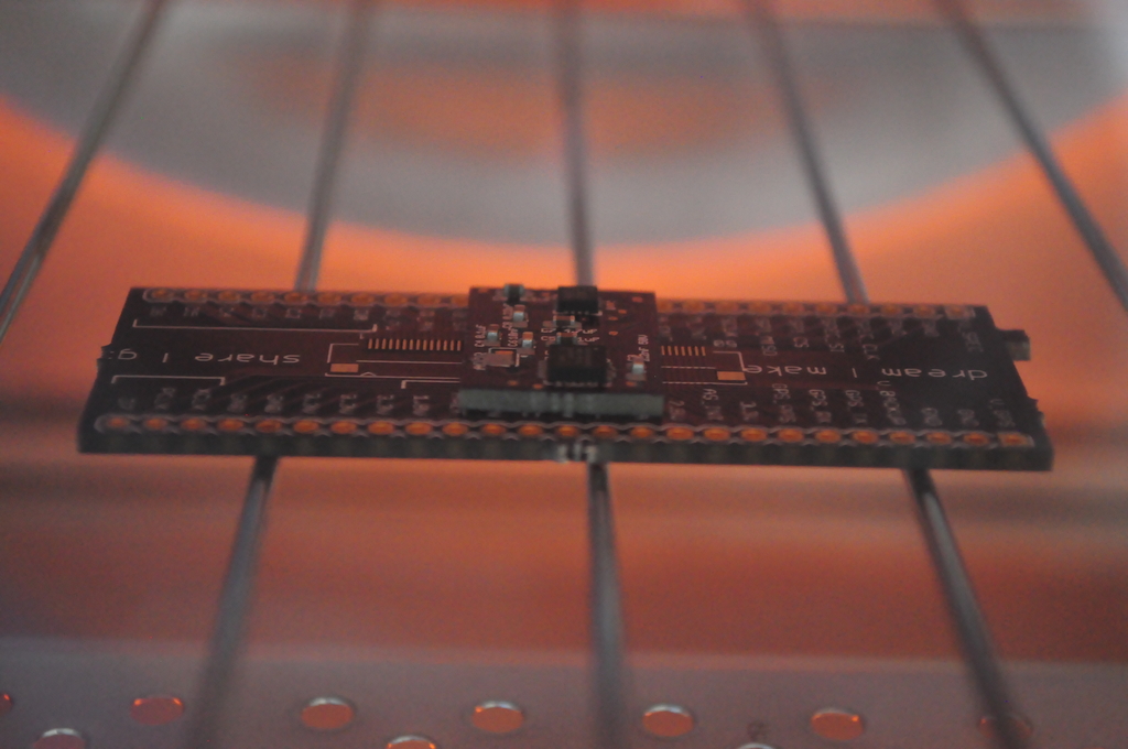

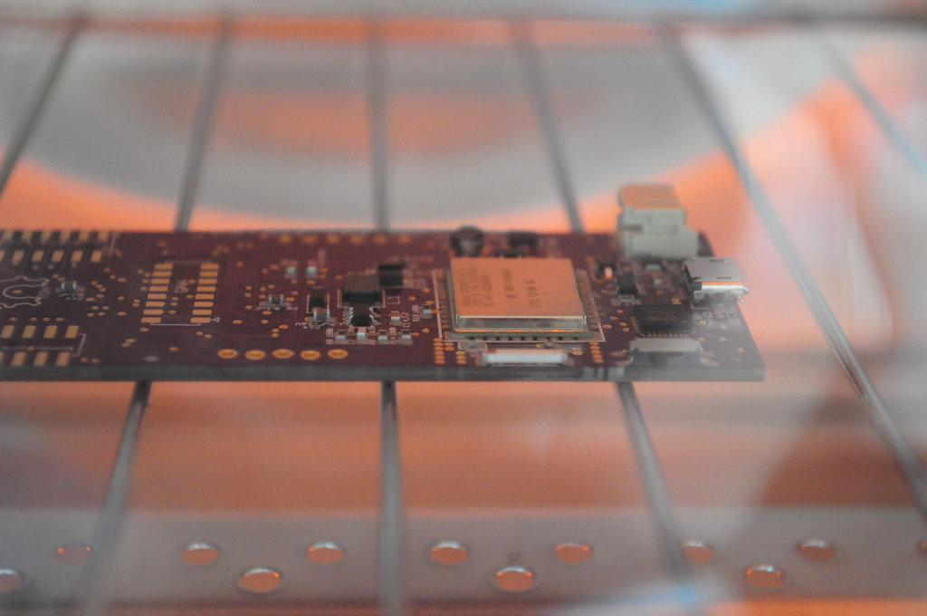

    Step 1 is to use your stencil to apply paste to the CC3000 side of the motherboard. Note that we'll occasionally switch between Revision 0 and Revision 1 motherboard pictures, but you should be using revision 1 (or the latest release, if a later revision exists at the time of reading).
    Populate the back components. I recommend leaving off the sensor headers until the end -- it'll make it easier for the board to fit into a holder while you solder the top components later.
    Reflow the bottom side. You may wish to pre-solder at least the mechanical mount points on the USB connector and battery connector to make sure they don't move (and end up angled) during reflow.
    Next, solder the top components. I do this by hand, starting with the PIC32, moving to the OLED connector, and then if everything looks good, stenciling the bottom of the board for the passives. Please take your time, it's not a race -- and if you bridge the connections it will make a mess of the board to clean up. For reference it takes me about an hour to solder all four sides of the PIC32, going slowly with very small amounts of solder paste. The OLED connector is similarly fine pitched, and the capacitive touch wheel connector is VERY fine pitched, so take it slow. The crystal will require a quick reflow with a hot air station to be properly hand soldered.
    Do not solder on the programming (ICD3) connector -- This is a one-time use connector, so the pins are offset such that the tension will let you quickly program the device, then remove the header so it's not in the way.

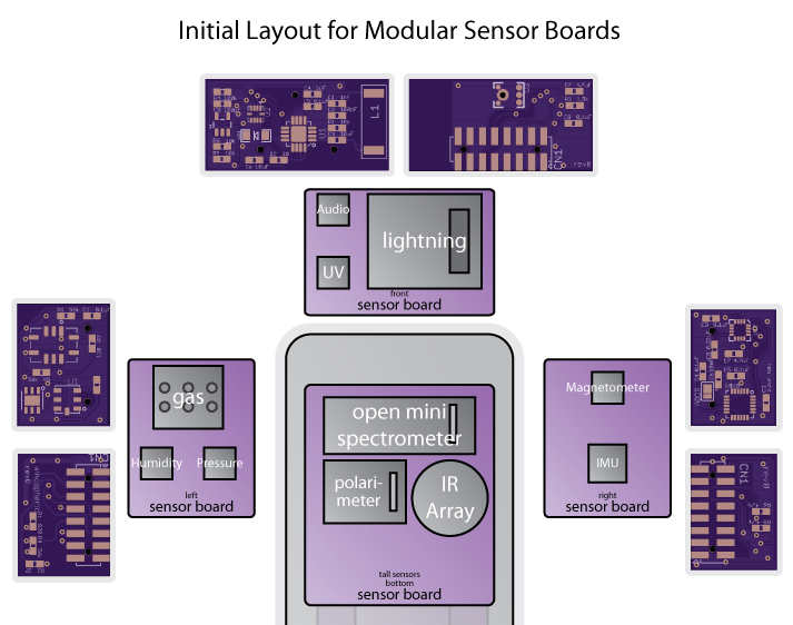

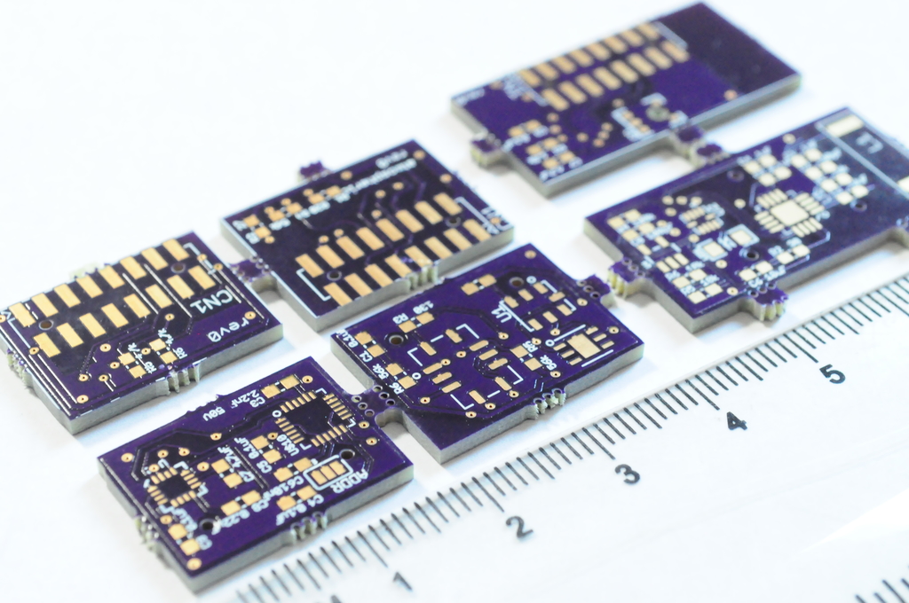

    Congratulations -- if you've successfully soldered the motherboard, then you'll likely have little issue putting together the sensor boards. They're very tiny, and about a 2 hour build per board. Because the process is similar for each board, here we'll just highlight any deviations to keep in mind. All of these boards have been designed to be relatively easy for an experienced surface mount solderer to put together -- one side has most of the parts and can be easily reflowed, and then the other side (usually just a connector, and perhaps a few passives) can be quickly hand soldered.
    The six sensor boards are: (1) the capacitive touch board, (2) the magnetometer/IMU board, (3) the atmospheric board, (4) the lightning sensor board, (5) the spectrometer/thermal camera board, and (6) the radiation sensor board. Of these, only the spectrometer board and radiation sensor board have special instructions.
    Spectrometer Board
    The spectrometer/thermal camera board houses the most high value sensors on the entire device, and individually represents most of the BOM. Ensure that you take care when assembling this board, and verify the voltages (both 3.3V and the 5V boost for the Hamamatsu micro spectrometer) before soldering the thermal camera and spectrometer.
    I very strongly recommend placing squares of kapton tape (or another non-conductive tape) under both the spectrometer and thermal camera before soldering. Their cans are conductive, and this will help avoid any of the other pins accidentally bridging with the case.

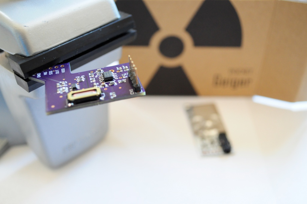

    Radiation Sensor Board
    The radiation backpack board allows the Radiation Watch Type 5 connector to the Arducorder Mini. This sensor board also contains an external comparator that allows the radiation sensor to be much more sensitive. You can experiment with different values for the calibration resistor, but a 2.7k 1% seems to have a good balance of signal-to-noise for me.
    In order to make the Type 5 extra sensitive, you will have to solder a piece of wire wrap to one of the test points. I recommend making a tiny loop at the end (with some tweezers), bending it 90 degrees, then hitting it with some solder paste. This connection has a very low voltage signal running through it, so be sure to do a good job soldering.
    The short piece of wire wrap solders to the backpack at TP1, which should be directly above the appropriate location on the Type 5.
    Congratulations! Feel free to connect this board up to an Arduino/Chipkit to test it out separately with the example firmware before continuing, if you'd like. The folks at Radiation Watch also have some Arduino-compatible Type 5 firmware that should work with this board (and takes the noise pin into account, if you're planning on vibrating the sensor).

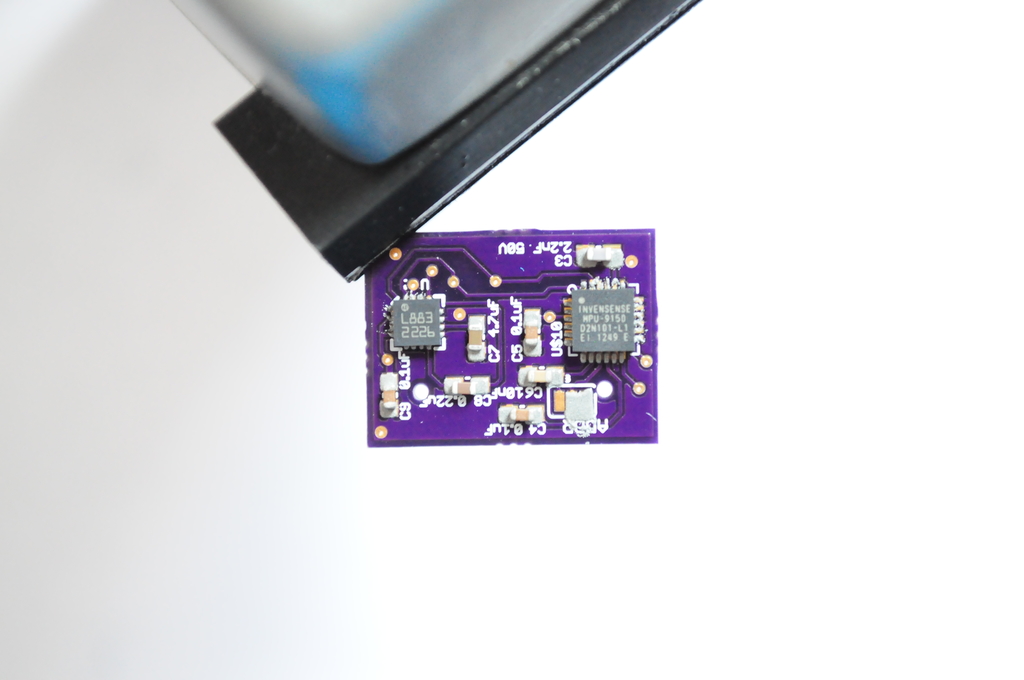

    Magnetometer/IMU Board
    This board includes an I2C address solder junction for the MPU9050. Ensure that it's shorted as above (otherwise it may conflict with the MPR121).

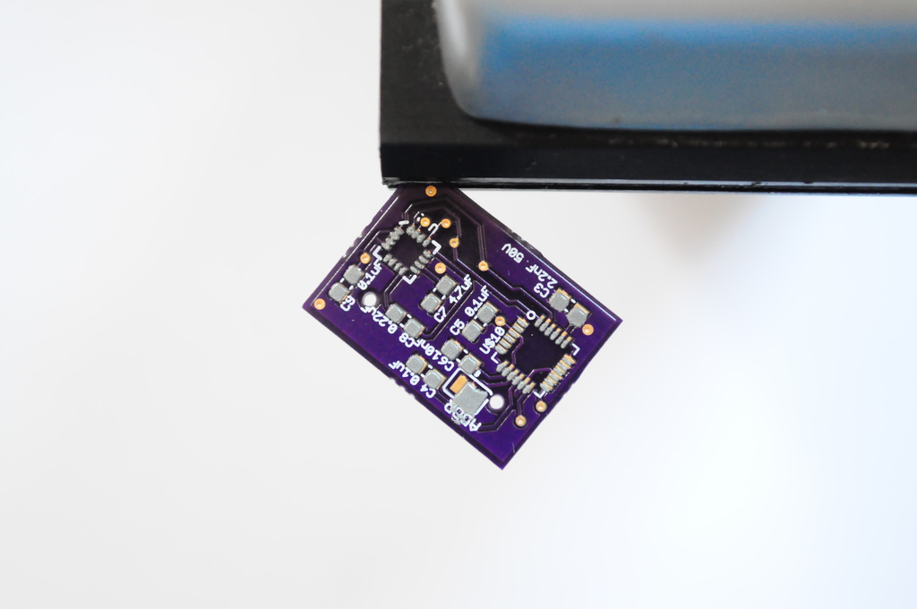

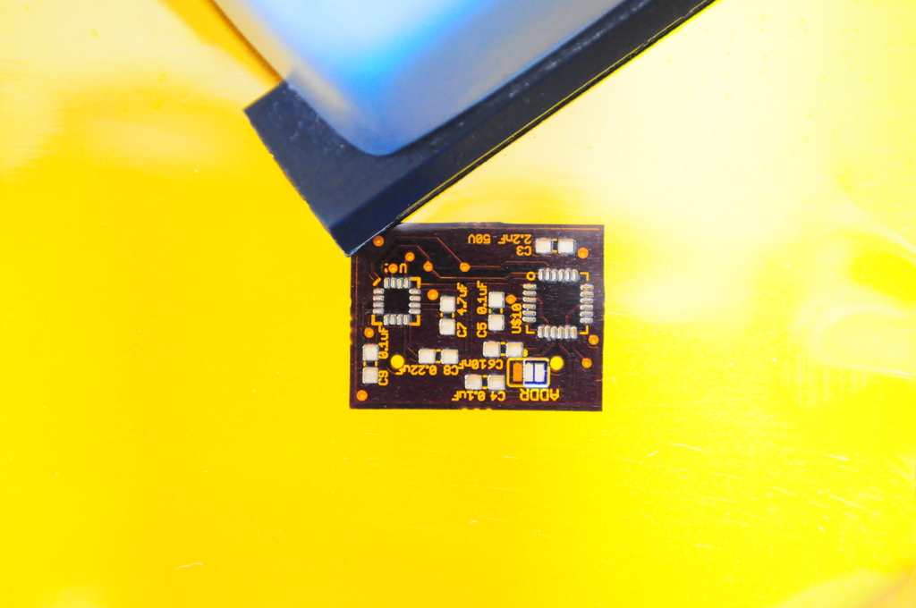

    This is the first revision of the Atmospheric board -- you'll want to put together the second revision, with the mosfets for the gas sensor.
    Lightning / UV board
    You'll need to use hot-air reflow or reflow the board twice to properly reflow the tiny microphone on the back.

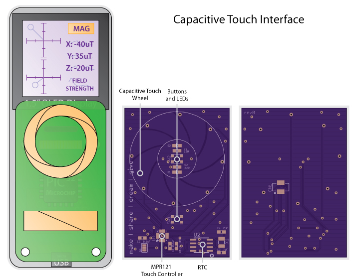

    Capacitive Touch Sensor board
    The latest revision of this board moves all the components except for two pushbuttons to the bottom side of this board. The whole thing can be easily reflowed without issue. The two LEDs/resistors beside the button are "do not populate" -- they're included incase you want to have a fancy glowing OK button, but are untested.

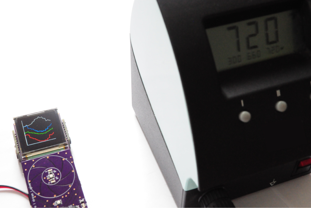

    The firmware will display this splash screen during boot up. It should be on the screen for a few seconds while all the sensors are initialized.
    After booting, your Arducorder Mini should begin to display the tile interface. Go explore the world, and share your discoveries with your friends!
