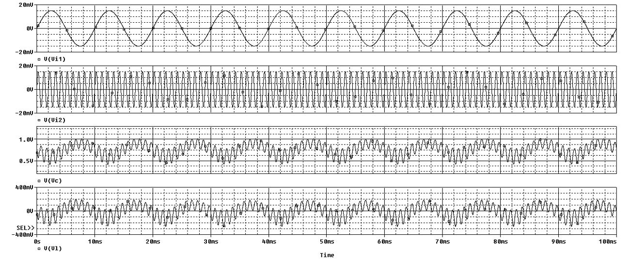

Step 2: Simulations

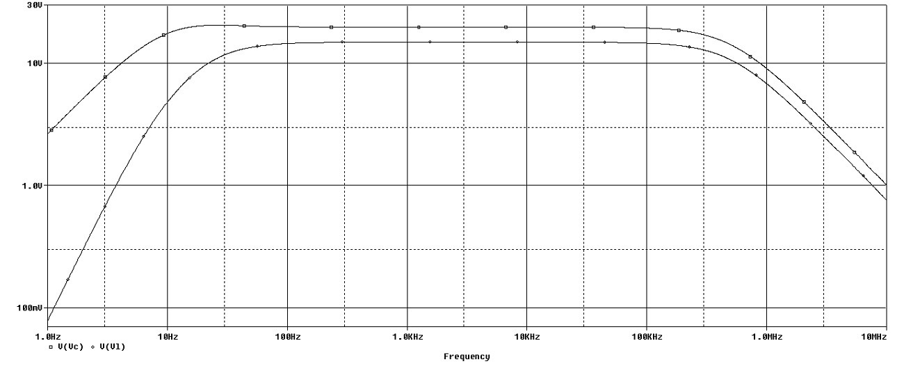

Simulations show that the transient response is amplified:
Frequency response:

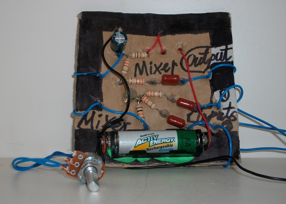

Step 3: Make the Circuit
I made the circuit on a piece of cardboard to avoid purchasing a matrix board:

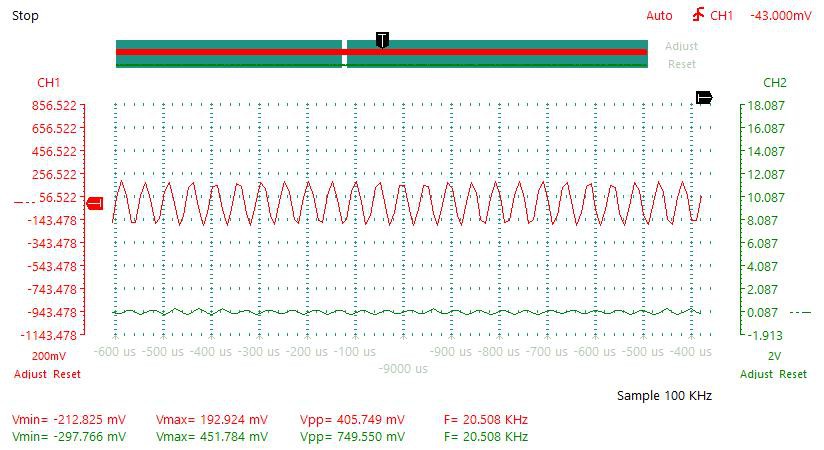

20 kHz Input:

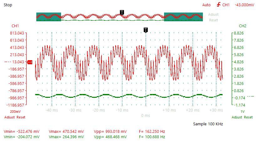

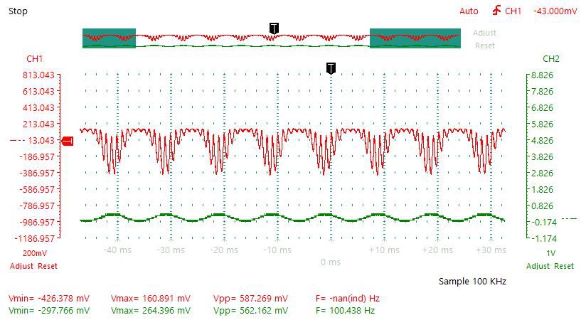

I varied the variable resistor to create distortion effect:
Distortion 2:
Summation:
