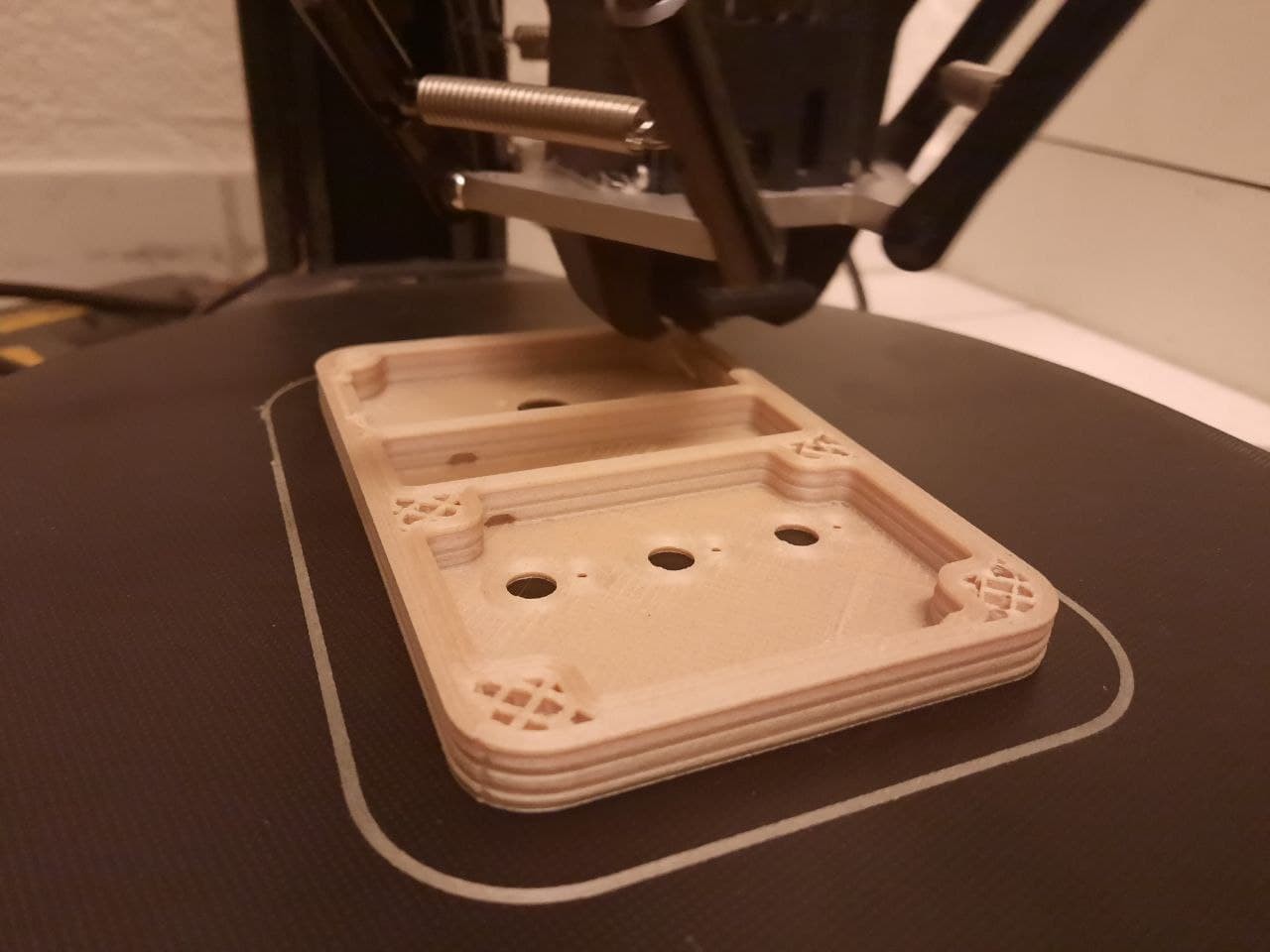

Printing
Once you print your object, it should look somewhat like this:
You can see there are visible grooves which are also darker. If you decided to use Blender or ZBrush to create the wood texture, the color will be more uniform, but what matters is that the surface has these grooves we will color darker with the wood stain and sanding.

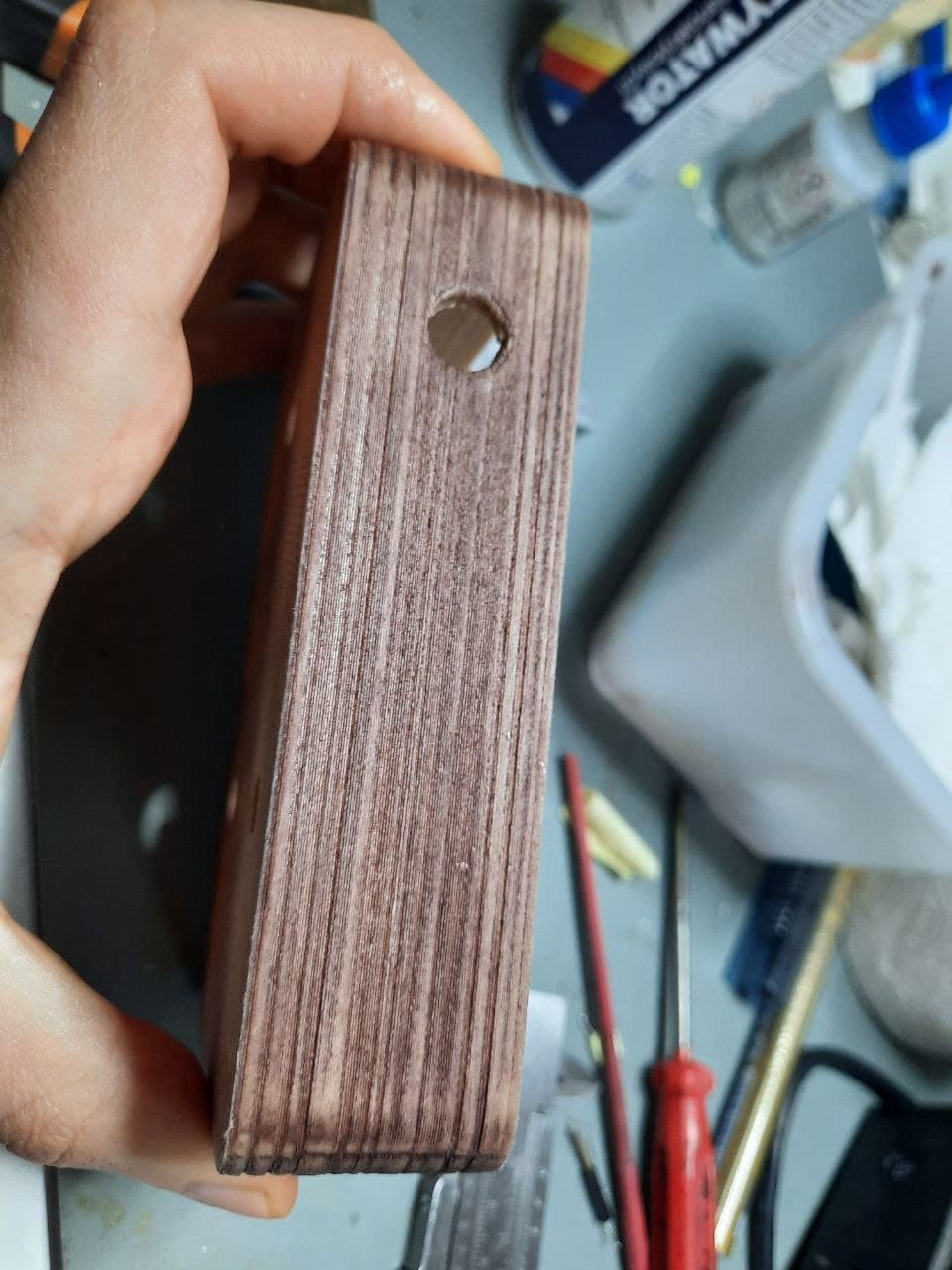

Once the wood stain dries up, you can sand the print to make the concave part brighter (it will remove the wood stain from the concave parts and leave it intact in the convex parts). In my experience it works best with 200 grit sand paper, although if you have lots of details, you can also try 400. The result should look somewhat like this:
If you want a more contrasty look, you can repeat sanding and staining several times which will get the grooves darker with each repetition. Be careful not to overly sand the corners as I did above. If you do that, as long as the grooves remain to be convex, you can reapply the wood stain and sand delicately again.

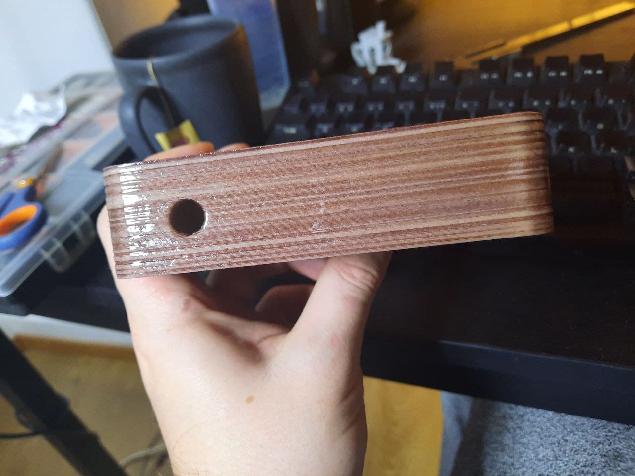

The result will be shiny, but uneven and not pretty:

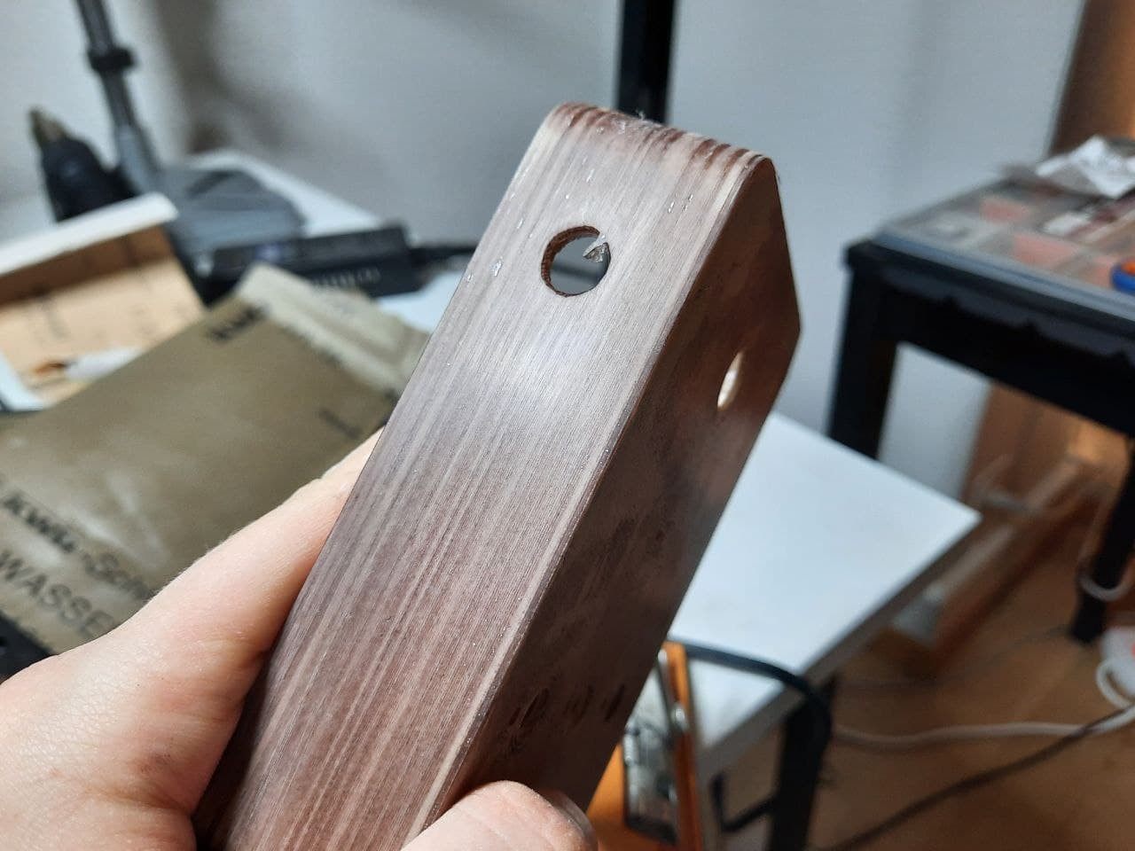

The semi-gloss result will look like this:
