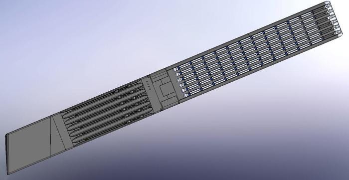

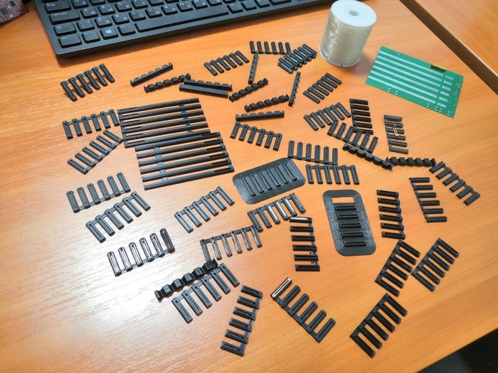

Let’s go ahead — strings on the soundboard. For the first concept, I decided to print plastic reeds, attach them to potentiometers with springs and measure deviation angles.
That’s how 3D-model looks like:
And that’s in reality:
It feels pleasant. It should work.

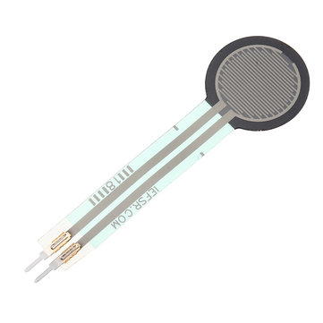

For frets on the fingerboard, I’ve ordered on AliExpress such tenso-resistors.
Unlike different buttons, they don’t click. It is also possible to define the strength of pressure, which means that I can play complicated techniques like slide or vibrato.
I also need ADC to read the info from sensors and transmit it to the controller.

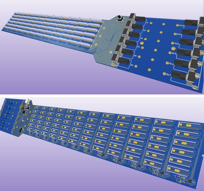

While I was waiting for sensors from China, I made a PCB layout:
Before ordering board printing, I decided to wait for tenzoresistors. And, as it turned out, it wasn’t in vain. Of 80 sensors, only a few were working, and even they had different parameters.
To put it mildly, it doesn’t look the way it was declared. But what was I expecting when I bought the components on AliExpress?

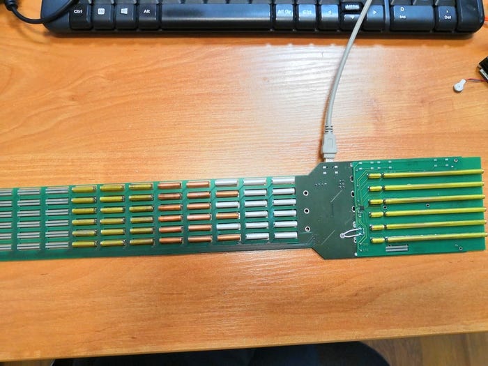

Well, let’s do away with the piezoresistors! For sensor elements, this time, I took small copper cylinders sawed from a wire. For capacity measuring, I could find an affordable 12-channel universal capacitometer. It measures capacity in picofarad units, which should be enough for a scheme of strength measuring, which I’m going to implement in the following modifications.
Additionally, just in case, I’ve hanged a seat for a button or something of the kind on each element of the fingerboard, and made cuts in the board so that I could not only touch the cylinder but also press on it inside. I’ll try to experiment with different playing techniques.
Having solved the question of connecting a lot of chips of capacitometer to the controller, I’m starting the board wiring.
This time I could order the board and even wait till it is ready.
After the components, copper cylinders, and potentiometers are soldered, I understood that construction with plastic strings is too complicated. So for a while, I decided to hang the same sensor cylinders on the soundboard, but a bit longer.
Two little wires in the lower part — I’ve connected a plate with cylinders to the board. It is a temporary solution.

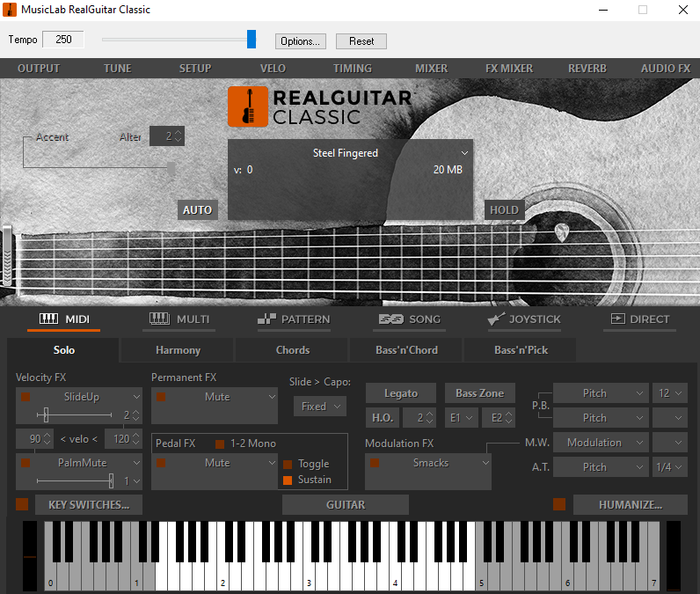

I found quite a lot of virtual synthesizers for Windows with midi support. I tried Ableton live, RealGuitar, FL studio, and Kontakt. I stopped on RealGuitar because it is easy and designed especially for guitar. It can even imitate the imperfection of human play — fingers sliding along the strings, randomized parameter of note production.
To connect my app to the virtual synthesizer, I emulated a virtual midi-port which is connected to the input of the virtual synthesizer RealGuitar via an emulator of midi-cable — such as a multi-level emulation.

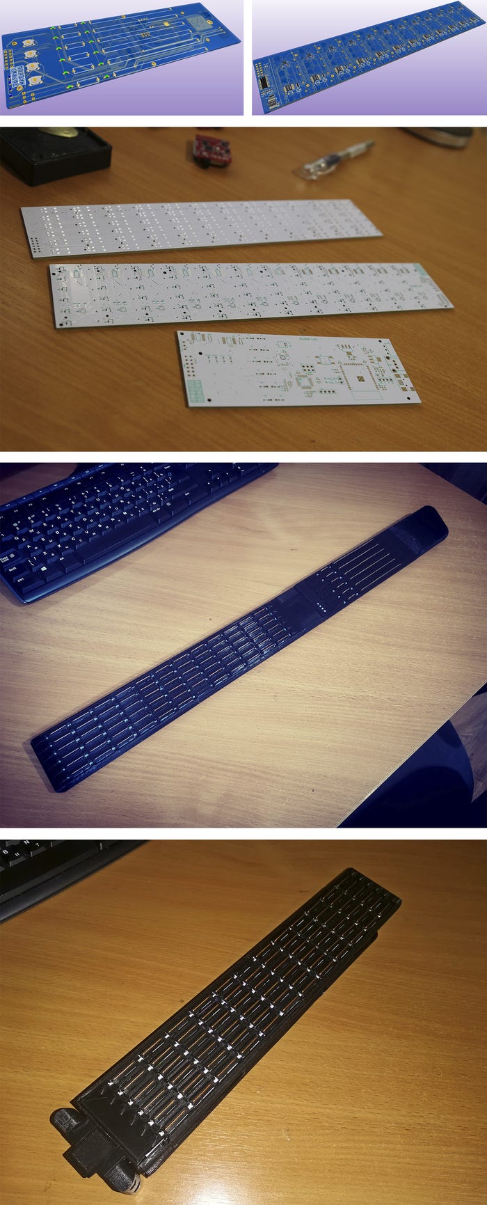

I did a lot of experiments with tactile elements of the fingerboard and diffusers for LEDs. I’d like the whole surface of the element to shine evenly, but at the same time, there should be a possibility of touch detection and pushing the buttons.
There are some of these experiments here:
I also consulted with a friend of mine, an expert in industrial design. We invented the construction of guitar folding, after which he projected and printed the body prototype.
I’m creating the final variant of the board and assemble the guitar:

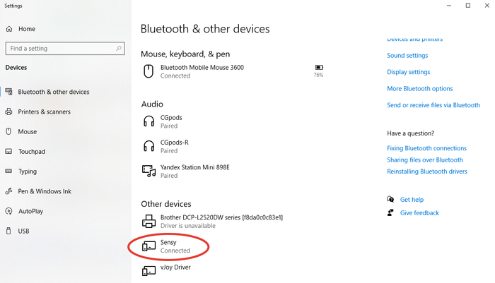

Turning the guitar into a midi-device
In the new version, first of all, I’d like the guitar to be defined as a midi-device without unnecessary programs when connected via USB.
I found that it was not so difficult to do it. All the specifications can be found on the official website usb.org. But all the algorithms performed on the part of python-app had to be rewritten in C to the controller.
I was surprised that it started to work on all the devices: Windows 10, MacOS, Debian 9, Android (via USB-adapter). You can only insert the cable, and a midi-device named Sensy appears in the system and is read by all the synthesizers. I couldn’t test it on the iPhone yet because I’ve got no adapter. But it should work the same way.

Now it is time to get rid of the wires. The right solution hasn’t come to me because I was too lazy to properly lookup on Google. But, as a result, I used the BLE MIDI protocol, which is supported by all the new OSs and works without any drivers, just like via USB MIDI. However, probably, the solution will fail on older OSs because there is no support for BLE MIDI. But all the tests with available devices were successful.
Rewritten app functions, that is, translation of sensor data into midi-data, occupied the whole controller memory accurately. Only 168 bytes left unoccupied. Evidently, the silicon gods were gracious to me, which meant that I was moving in the right direction.
Sure, it can be optimized, but I’ll leave it for the next version. Though, it is better not to waste my time and just take a bigger controller. The difference in money is five cents. We’ll see, anyway, I’ll need a space for new features — for instance, processing playing techniques. First of all, I’d like to implement a slide. It is when you start playing a note with a certain pressed fret and slide with your hand along the fingerboard jumping from fret to fret.

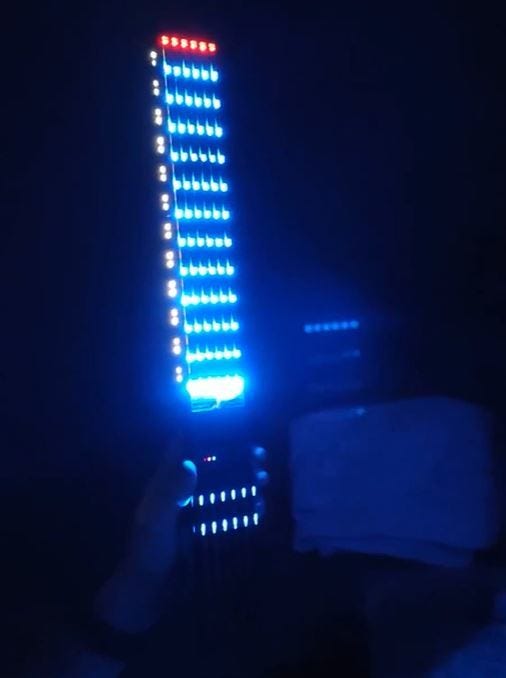

Now we can check how it works wirelessly:
When all the LEDs are on, you can use the guitar if you get lost in a dark cavern.
