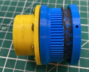

Currently the data is looking promising however we have hit significant issues with the pulleys. The original pulleys were 3D printed from PLA. A significant amount of heat is generated form the belt resulting in the PLA melting. To overcome these issues, we are looking into chain connections or modifying commercially available metal pulleys to fit the motor and alternator shafts. Alternately we may adapt the dynamometer to act against a brake however this reduces the programmability of the load.
Melted Pulley
