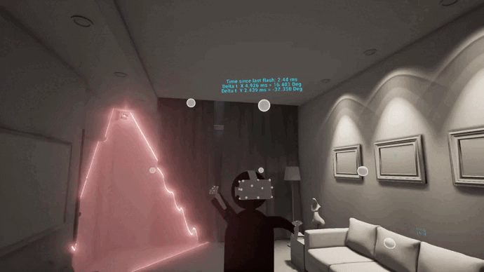

The next significant development in tracking systems was made by HTC in collaboration with Valve, revolutionizing everything by embedding a photodiode array into the headset instead of LEDs. Unlike all previous solutions, the new system introduced in 2015 as SteamVR Tracking does not use cameras, and the PC does not process any data. It was designed from the outset to provide room-scale position tracking without needing to connect sensors to the user's PC. The growing popularity of this system was also helped by the fact that the documentation for this system is open, as is some of the software.
Instead of stations based on IR cameras, new devices called, quite logically and succinctly, "Lighthouse" was introduced. If you want to learn more about their design and history, I suggest paying attention to Brad's video: “Valve's Lighthouse: Past, Present, and Future,” and here I will try to briefly explain their working principles. Positioned at opposite corners of the room, the lighthouses emit wide-angle two-dimensional IR laser beams throughout the room, doing this one axis at a time, meaning from right to left, then from top to bottom. Before each sweep, they emit a powerful IR light flash to synchronize. Each tracked device, whether it be a headset or controller, contains an array of IR photodiodes connected to a microcontroller (MCU), which measures the time between the flash and the laser hitting each photodiode. The tracking system uses simple trigonometry to calculate the position of each sensor with a fraction of a millimeter accuracy.
Fig. 2. Lighthouse tracking.
One of the main advantages of this approach is that now an unlimited number of devices can be tracked in the room, as long as the laser beam reaches at least a few photodiodes. A little later, the first Vive Tracker was introduced, featuring a standard 1/4 inch thread mount, meant to be attached to almost anything, whether it be a camera to track its position in the studio or a baseball bat to capture the trajectory of a swing. But the most logical solution seems to be – if our virtual character has a flying head and hands, why not add other limbs?

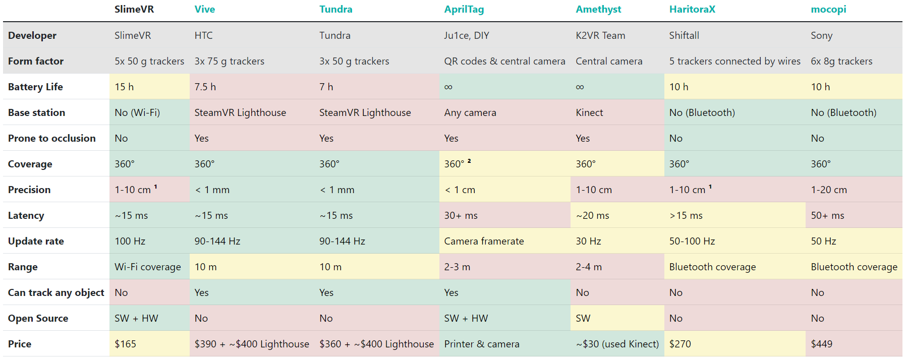

What solutions already exist? Today, many FBT systems differ both in fundamental working principles and in the quality of implementation. On the SlimeVR project page, there is a good comparative table. While I have questions about some of the data in it, overall, it well reflects the differences in popular tracking systems:
Fig. 4. SlimeVR comparison table.
From it, we can identify three main groups:
- Tracking with base stations (Lighthouse): Vive, Tundra. This method is still the most accurate today, but with the industry's rapid shift to inside-out tracking (using cameras built into the headset), not every VR user has base stations, which require at least two for reliable coverage. Also, you won't be able to wrap yourself in a warm blanket in the cold winter.
- Camera-based tracking: AprilTag, Amethyst, Driver4VR. Probably the most accessible method for the average user, special software captures the image from a regular camera and, using a neural network, finds the position of the user's limbs, or Kinect, which also uses a camera with an IR dot projector. The main disadvantage is accuracy, and while standing in front of the sensor you likely won't have problems, just take any non-standard position or even sit on a chair, and the model twists randomly.
- Inertial trackers: SlimeVR, HaritoraX, mocopi. Each tracker monitors its rotation in space, and the software uses your proportions and the coordinates of the VR headset to calculate joint angles and estimate limb positions. Speaking more technically, the technology relies on absolute orientation sensors, a calibrated skeleton model, and forward kinematics.

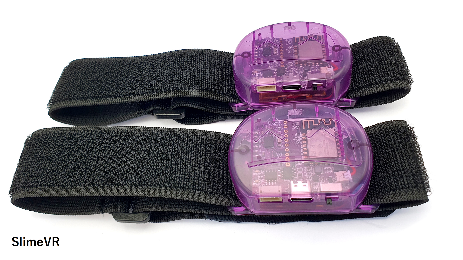

A good example of the implementation of this technology is the small Estonian startup SlimeVR, which gained significant popularity in the VR community thanks to open-source software and easy assembly.
Fig. 5. SlimeVR serial model.
The base uses the ESP8266/ESP32 module, which connects to WiFi. This is both good and bad. On one hand, you have good coverage, directly dependent on your router, as well as a device limit in the network. On the other, this method is much more energy-consuming than, for example, BLE. Also, in the pursuit of universality, you can lose unique features that a certain sensor might offer.

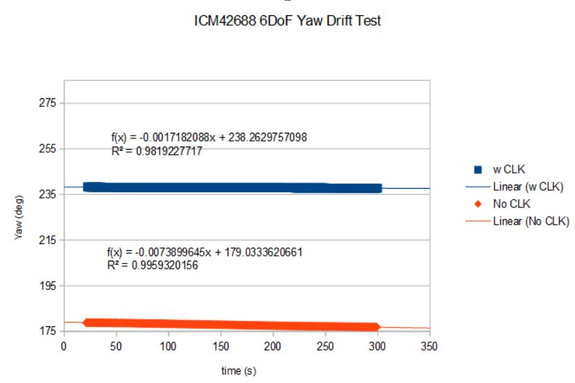

Jumping ahead, let's try to at least estimate the accuracy. First, we open the first library for the 42688-P that comes to mind, where the author immediately presents his measurements of drift in a calm mode using the Madgwick filter and basic calibration:
Fig. 6. ICM-42688-P drift.
To increase accuracy, the manufacturer recommends providing an external clock signal, and indeed, with an external quartz generator, accuracy increased by four times! The drift is 6 degrees per hour, which is quite good for relatively cheap MEMS.

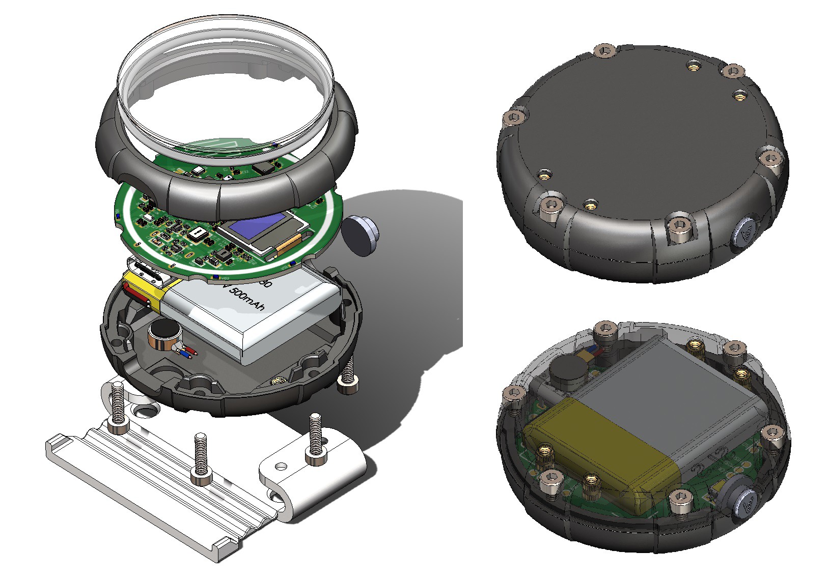

Design. I had a certain image of the design in my head by this stage, it remained only to transfer it to 3D using SolidWorks and see how technological it is for production. I would like to note in advance that I do not plan to print the case on a home FDM printer, but prefer to outsource such work to JLCPCB. For just $3, they can print all the parts on an MJF printer with excellent quality.
Without wasting time, let's move straight to the result:
Fig. 7. Prototype design render.
Fig. 8. Prototype assembly.

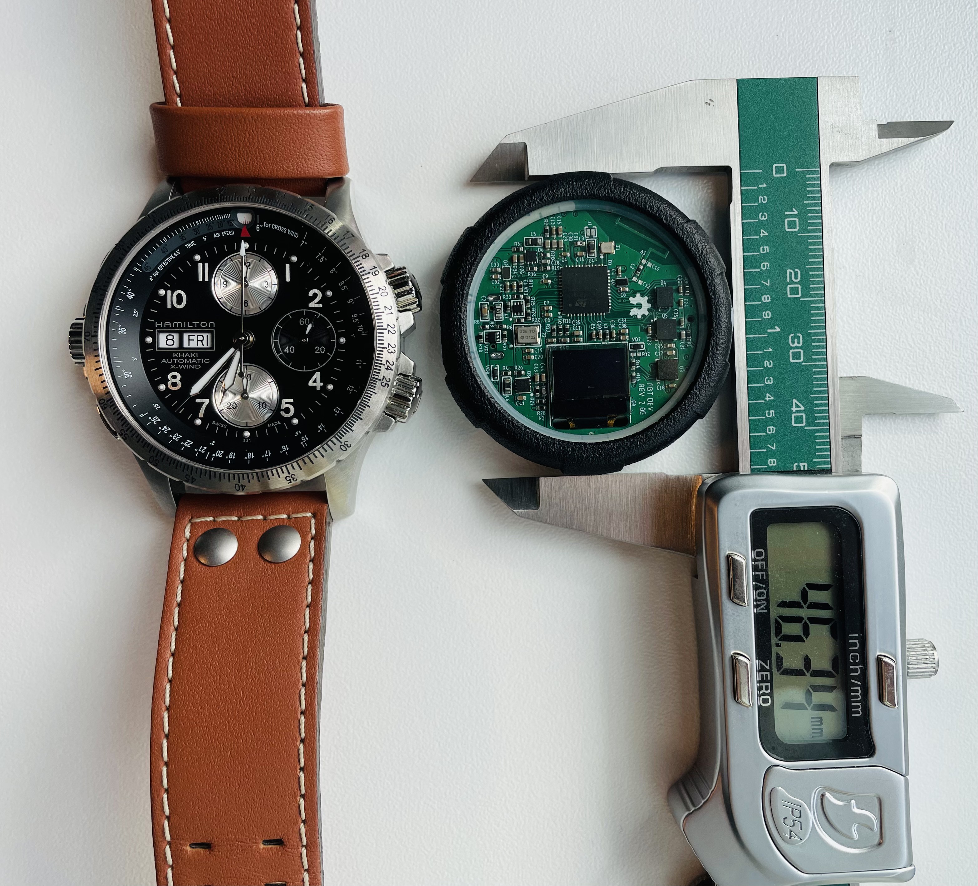

The design turned out to be practically in the form factor of a wristwatch. The maximum diameter of the case is 46mm, and the thickness excluding the strap mount is 11.6mm. The structure has four printed parts: the lower and upper halves of the case, the strap buckle, and the button. I wanted to make a "geek" design, so the printed circuit board (PCB) is located under transparent mineral glass, sturdy enough not to be easily broken, and in case of a strong impact, it will not shatter into small fragments, like most watches. The pressure to the upper part of the case and the gap between the glass and the PCB is provided by a silicone sealing ring with a cross-sectional diameter of 2mm, when designing the board, it will be necessary to ensure that no component is higher than ~1.6mm. Also, the ring is semi-transparent and will partially diffuse light, so we can play with the backlight around the perimeter (for example, add battery charge indication). In the lower part of the case, four insertion M2 brass nuts were added for mounting the belt buckle or any other attachment. The battery thickness was chosen so as to position the USB and button approximately in the center, and it is 6mm, with a capacity of 500mAh. As we can see, the layout turned out to be quite compact, and all details can be easily ordered from China.

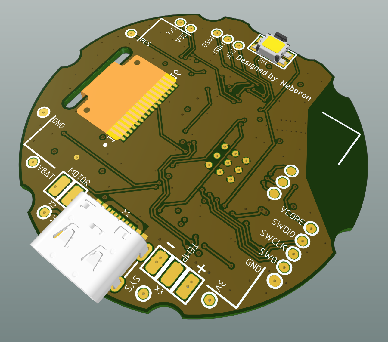

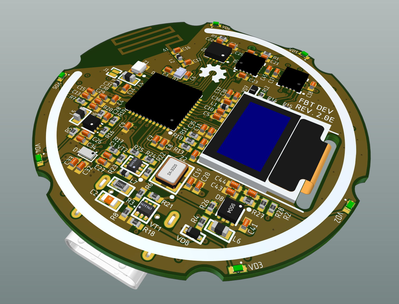

Designing the schematic and PCB. Here everything is quite simple, we have several sensors, DC-DC converters, a charging controller, etc. Just remember, the device is powered by a battery and we want to save as much charge as possible, so even for the resistor divider for measuring the battery voltage, I put MOSFET switches. Carefully study all datasheets, interesting lines for us: quiescent current, sleep mode current, etc., this will give some idea of consumption in different operating modes and about what can be put into sleep mode and what will have to be turned off completely. The Altium project will be published later. A week of evening work in front of the computer monitor and here is the actual design of the board:
Fig. 9. PCB top layer.
Fig. 10. PCB bottom layer.
The round board with a diameter of 40mm accommodates all components including the antenna, a tiny OLED display with a resolution of 72x40 was added more for the sake of convenience in debugging. All DC-DC converters and the charging controller are located on the side of the USB. On the opposite side, away from theoretical sources of noise and magnetic parts, sensors were placed. We can see that there are now three, another footprint was added for a more accessible magnetometer, it's not much worse than MMC5983, but at the same time, it's available in large quantities in JLC warehouse. On the back, there are the USB type C charging connector, the tactile button, and place for the LiPo battery, which is glued with double-sided tape.

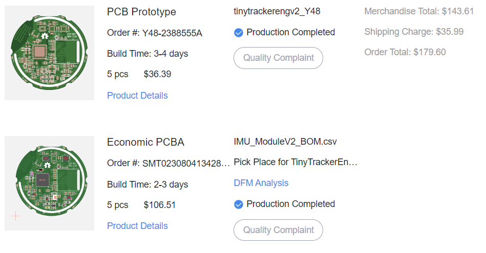

Time to assemble everything. I made a final review for mistakes, prepared gerbers, CPL, BoM, and sent it to the factory. As always, I'm too lazy to prepare a proper BoM with LCSC/JLC component codes, so some I need to choose manually. The boards are more expensive than usual because I specified increased accuracy for the vias, but usually, there will be no problems even with the standard configuration of the order.
Fig. 11. JLCPCB order.

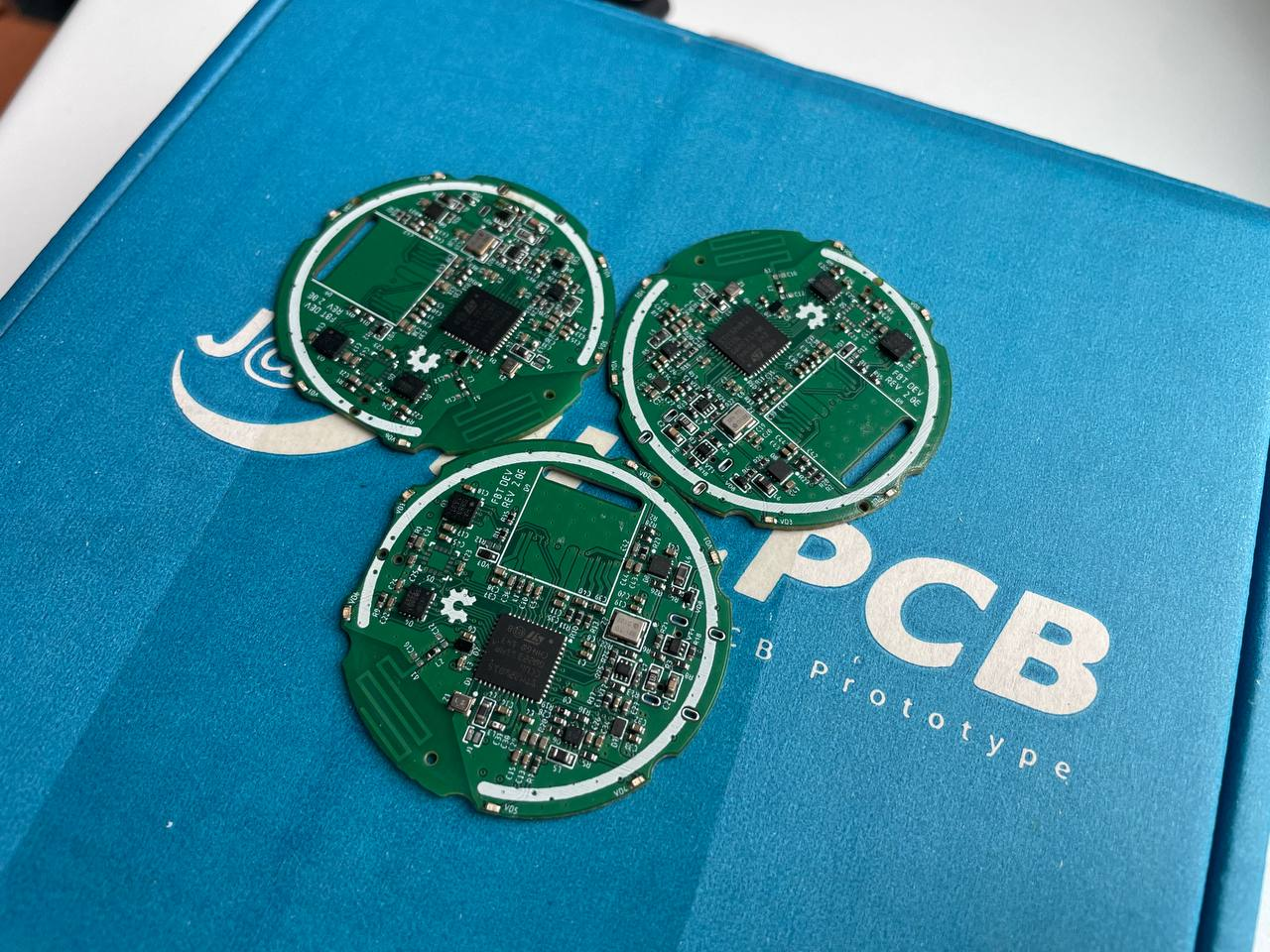

Assembling the first five prototypes cost only $106.5, but with not all components installed, to save money assembly was one-sided. USB, button, and display I can solder myself. It's clear that for a larger quantity, the cost of one tracker noticeably decreases. A preliminary calculation showed that for a batch of 100 trackers, the cost of one would be ~$25, including all plastic parts and the strap.
Approximately a week for production and another week for delivery, and here they are in my hands:
Fig. 12. Assembled boards by JLCPCB.

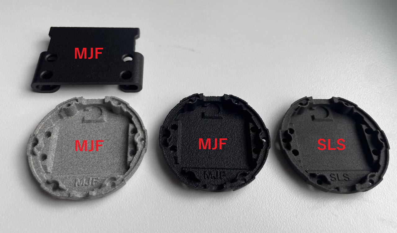

I solder the missing components and can begin to gradually bring each component to life (at the time of writing the article, I managed to get everything that lies on the I2C bus to work: display, charging controller, magnetometer). Plastic parts arrived in a separate parcel, this time in addition to MJF I ordered SLS, to compare print quality. In SLS, it is indeed slightly higher, but the surface is not smooth, feeling more like fine-grit sandpaper, so I will continue to use MJF.
Fig. 13. Printed parts by JLCPCB.

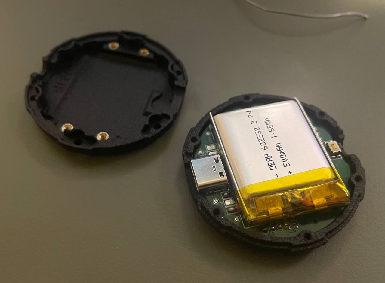

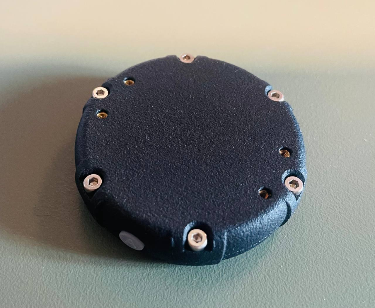

I assembled the first prototype to see how all the parts fit together:
Fig. 14. Tracker assembly, step 1.
Fig. 15. Tracker assembly, step 2.
Fig. 16. Tracker assembly, step 3.
Everything fits perfectly, there are only minor corrections for the next revision, such as reducing gaps. A few more photos of the assembled device:
Fig. 17. Assembled tracker.
Fig. 18. Tracker size comparison.
