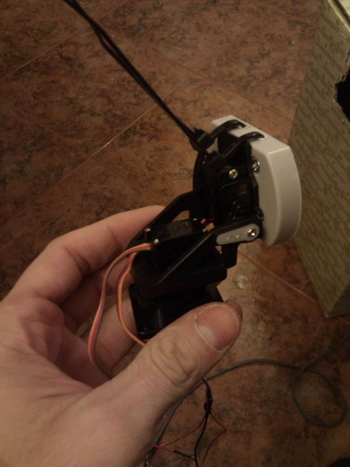

9. SERVOS
The servo used to move the Picam and make panoramas is this. In order to make it work, you have to install pi-blaster.
To move it I tried to use the python lib RPIO.PWM, but after every move, it caused small spins which caused continuous vibrations on the Picam. So I ended up writing directly to the device /dev/pi-blaster.
If you turn this servo beyond its limits, the servo will keep trying to move to the designated position. Also, if you turn it to a position, and something moves it (for example the wind on a very windy day, or a cat, bird...), the servo will try to move itself back to the designated position. Because of this it's important to release the PIN after moving it:
echo "17=0.2" > /dev/pi-blaster
echo "release 17" > /dev/pi-blaster
The power consumption of the Picam when the servo are runnig goes up to 1.2A. Normally it consumes 0.5A.
The Max, Mid and Min positions/values for these servos are these values:
max: 0.19
mid: 0.13
min: 0.05
If you only need one pin for the servo, specify it as argument:
sudo ./pi-blaster --gpio 25
As the servo is really small, I doubted that it could move the CS66d enclosure, which weights around 1Kg. But for my surprise, it moves it flawlessly. Moreover, the servo moves the Picam with such a force that after every move while taking panoramas, it needs to sleep for around 2 seconds to wait until the Picam stabilizes itself and stop moving.
At first I had no idea how to attach it to the enclosure. And I still had the idea to use 2 servos for make panoramas, so I tried different things:
But moving it up and down was two much for this servo. So less headaches: use only one servo.
