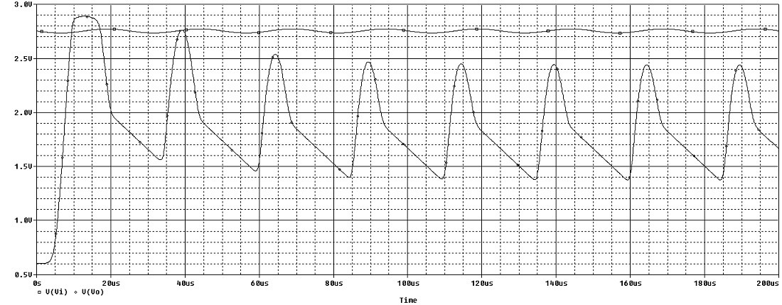

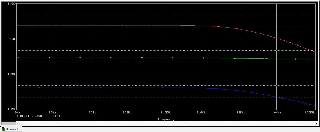

Step 2: Simulations
Simulations show that my design is correct:
Time Domain:
Output Current:
Frequency Spectrum:

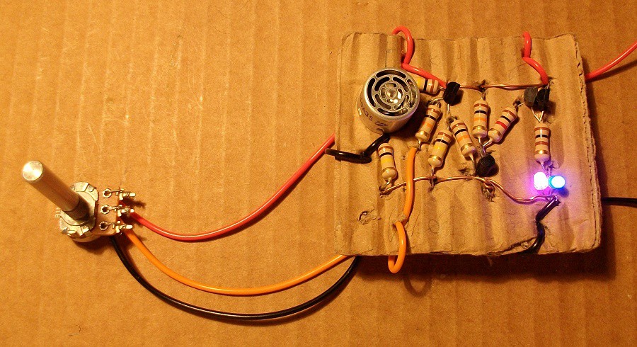

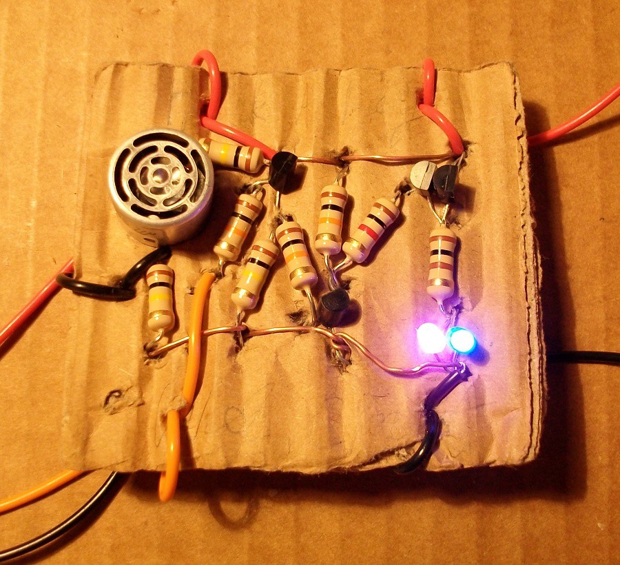

Step 3: Make the Circuit
You do not need to use the high power resistors that I used. I used 1 Watt resistors. You can use 1/4 Watt resistors. However, you got to admit that the circuit appears more professional with bigger resistors.
