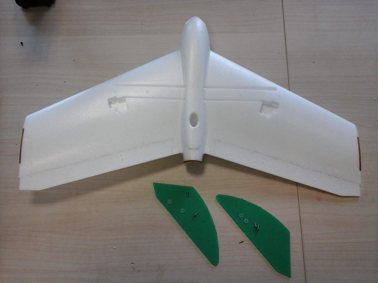

    Step 1
    Step 1: Assembling the frame.
    First of all we are going to attach the wings with the help of a screwdriver. We are using plastic washers to avoid breaking the wings because of the pressure.

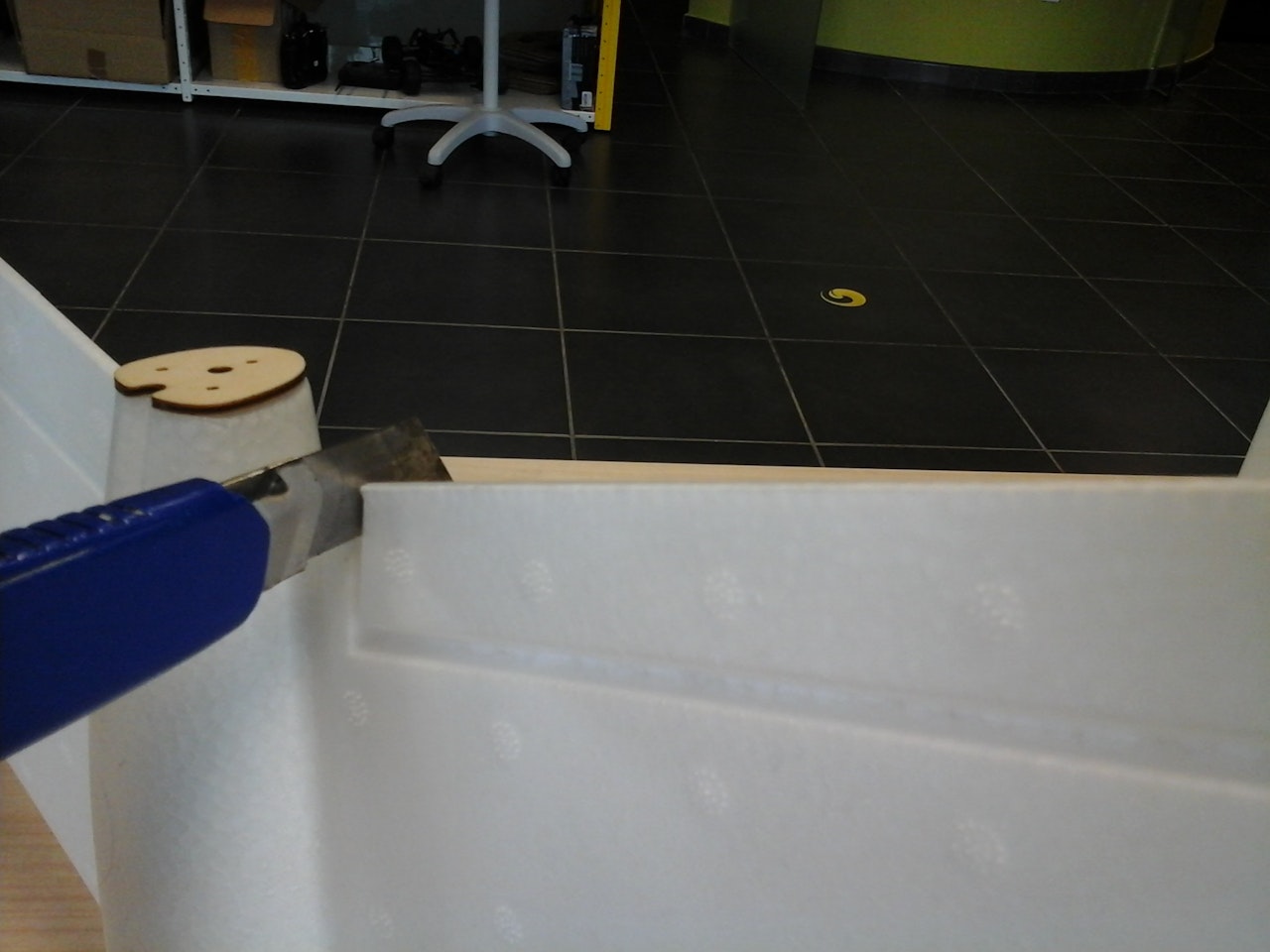

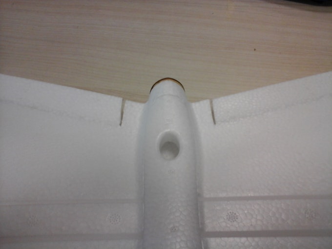

    Step 2
    Step 2: Cutting the frame.
    We are going to cut a piece of the plane wing with the help of a cutter to free it.

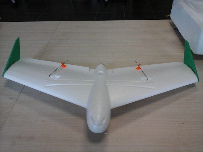

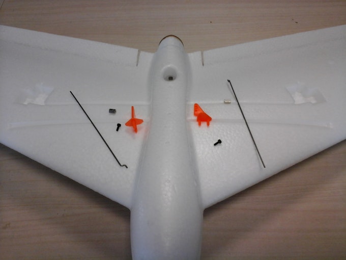

    Step 3
    Step 3: Mounting elevons mechanism.
    The next step consists on mounting the elevons mechanism for allow the wings moving up and down.
    We recommend to paste the orange piece to the wing with super glue.
