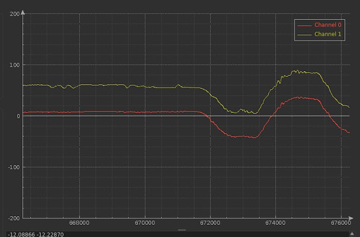

We use a simple architecture to visualize and test the SuperIMU:
The SuperIMU sends the raw acceleration/gyroscope rates to the microcontroller using the SPI port.
The microcontroller filter the raw data, and estimate the angles. It sends the angles values using the UART port for analysis purpose.
The UART port is connected to the computer to visualize the data using a serial to USB module.

TimeSampling
The target st to have a sampling rate of the estimated angles @1ms.That means we need to measure all the 13xIMU, make the filtering and the complementary estimation under the timeframe of 1ms.
To reach this target, we use a STM32F7 board with the possibility to use 6x SPI ports to distribute the data acquisition from the IMUs. But at first we will use only one SPI.
In 1xSPI configuration: the theoryAt 6Mhz SPI (of the STM32F7) one byte takes arround 1.3us on the SPI.To read the accel or gyro (3 axis) it takes 8x1.3us, around 12us.To read both accel and gyro it takes around 25us.To read all the 13xIMUs, it takes around 325us.The remaining 675us are used to filtering and estimation computation.
Experimentally, reading 3-axis accel data takes 35us, and gyro 34us.Which gives 70us per IMU.x13 it takes 910us for all the IMUs.It lets barely 90us for the filtering and estimation.Need to make some optimizations.

Step 11: Using UART to Plot Data
To visualize the output data, I'd like to use UART to be able to visualize it in the super amazing cool serial plotter : https://github.com/CieNTi/serial_port_plotter
The problem now is to convert Float to String.. to send it using UART to the Serial_Port_Plotter tool.
To do that I used the magical word 'Img in Ada as suggested here to convert Float to String. Then send the string byte by byte to the UART.
If you want to send one value: - send "$" - send float value - send ";"
If you want to send multiple values: - send "$" to start - send float value 1 - send space " " ... - send float value i - send space " " - send ";" to terminate
To be able to send an acceleration to the plotter, I used the following code:
     type FixedFloat is delta 0.00001 digits 18;
---     data_1B(0) := UInt8(36); -- '$'     UART_OUT.Transmit(data_1B,status);     for ch of FixedFloat(AccelRates(X))'Img loop        c := Character(ch);        data_1B(0) := Character'Pos(c);        UART_OUT.Transmit(data_1B,status);     end loop;     data_1B(0) := UInt8(59); -- ';'     UART_OUT.Transmit(data_1B,status);
The result is very satisfying, in the snapshot bellow I visualize the Accelerometer(X) value in real time:
After creating the driver, that data is correctly sent through UART port:
