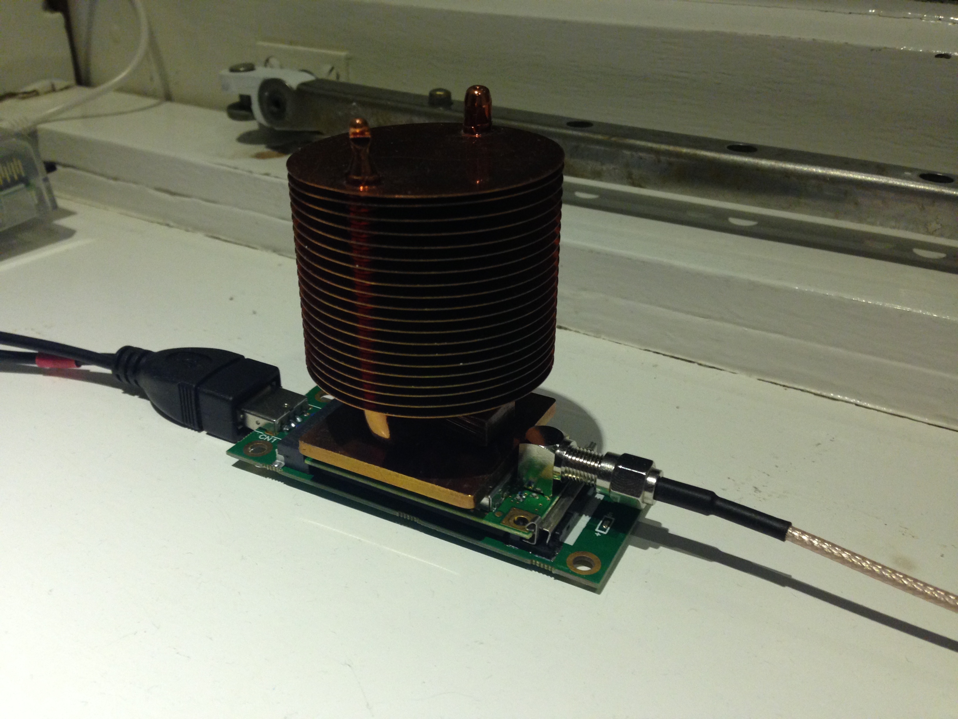

Thermal Solutions
Looking at the backside (see below) of Multitech’s updated mCard, suggests that the new version might have a better heat dissipation profile too.
The original version had the FT232H on (almost) the exact opposite side of the SX1301 - see the above board layout.
Under load, the metal cover on my DIY gateway would become too hot to touch and, under heavy load, felt like I could fry an egg on it!
The Things Network guys in Leiden went with a passive heatsink
...a very big heatsink!
Since the new version uses SPI only, there is room on the backside of the SX1301 for a heat dissipation pad.
My gateways tended to become unpredictably unreliable (worst of both worlds) when they got too hot - and I don’t think I was the only one.
Better cooling always made the “problem” disappear, so hopefully this improved board layout and chip placement will go some way to mitigate that issue somewhat.
