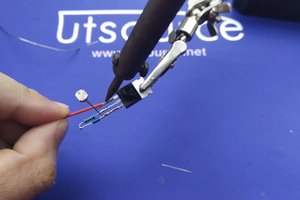

➢Step descriptions:
✦Step 1:-These are the components we are going to use.
✦Step 2:-If you are making single sideboard, you must insert 1 jumper.
✦Step 3:-Now transistors and ICs are connected to the board.
✦Step 4:-Now we have to apply solder on it.
✦Step 5:-Now we have to cut all the pins.
✦Step 6:-Solder the back pins.
✦Step 7:-Wash with thinner.'
✦Step 8:-Now let’s cut the pins of transistors and ics.
✦Step 9:-We have these 2 heat sink we will mount both, if you have bigger heat sink so you can add one.
✦Step 10:-Let’s make the positions.
✦Step 11:-We can see the cutting here, you can clean it with the help of bigger drill bit or file, otherwise it may short the transistors.
✦Step 12:-Now we have to apply compound.
✦Step 13:-After this we will apply mica.
✦Step 14:-Connect it with the heat sink.
✦Step 15:-Test the transistor and ics
✦Step 16:-Use 12-0-12 volt 14amp transformer and connect the wire.
✦Step 17:-Connect the speaker socket.
✦Step 18:-AUC socket, connect it as well.
✦Step 19:-Connect it to our colum.
✦Step 20:-Connect the AUX cable, let’s it as well with the phone.
✦Step 21:-Play the music, test it.
