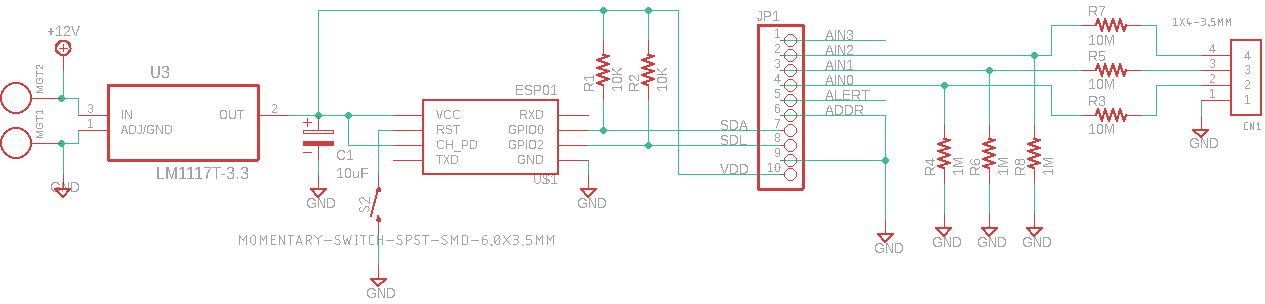

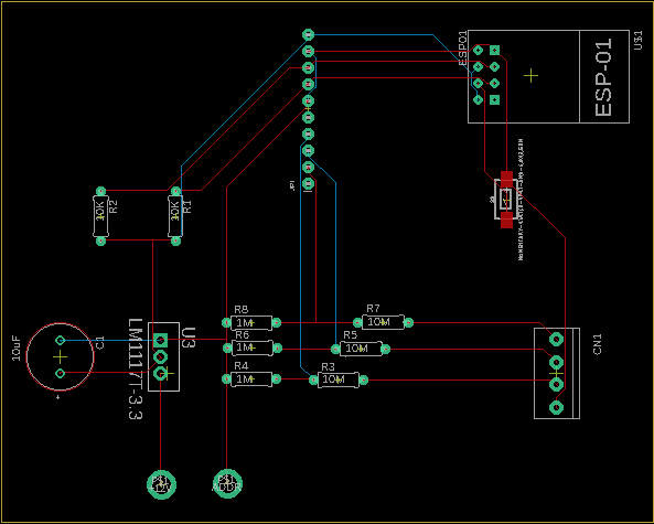

This project utilizes an ESP-01 and a ADS1115-4-Channel-16-Bit-I2C to read the voltage of 3 batteries in my RV.  A status email is sent daily with the battery voltages and if any of the batteries drops below 12.4 volts an alert email is sent.
