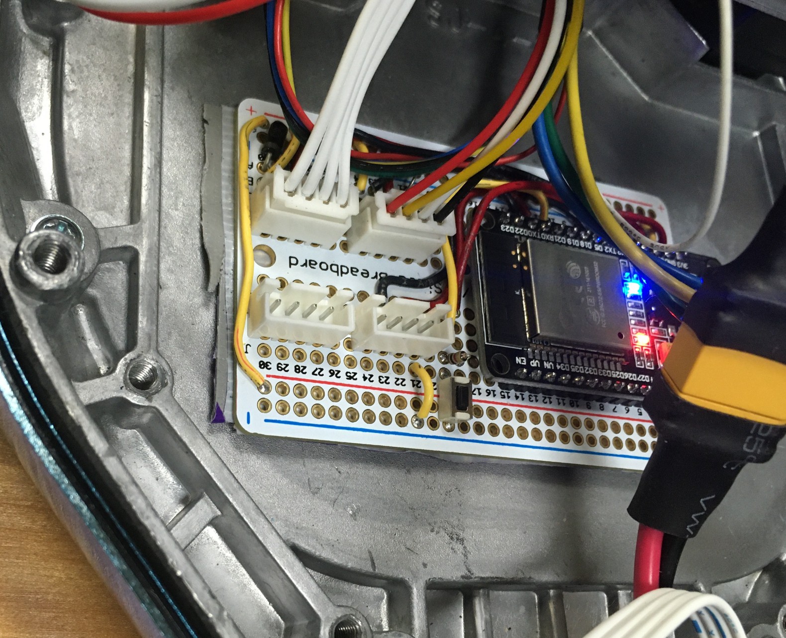

Whenever you develop a protocol, you typically need something to run at both ends to test that it works.  In my case my initial plan was to embed an ESP32 based processor into the hoverboard chassis to act as a "Human-Machine Interface" (HMI), so it made sense for me to work on this component simultaneously with the hoverboard firmware.
I grabbed an ESP32 DevKit 1 prototyping module and plugged it into a proto-board and then added some cable headers that matched the cable already being used by the Hoverboard.  Instead of a single cable running between the Master and Slave controllers, I needed to run a separate cable from each controller, so my prototype board had both a master and slave connecter.
The ESP32 it really small and capable with WiFi and Bluetooth, but the reason I chose it over it's little brother (the ESP8266) is that is comes with three UARTs in hardware.  One of these is usually dedicated to the download/diagnostics function, which leaves two that can be used to talk to the two motor controllers.  You can access these three ports easily with the ESP32-IDE, and with a bit of fiddling with the Arduino IDE.  I had just done a major project wit the ESP32-IDF so I used that.
The first HUGS command that I implemented was the SetPower command which just translated into PWM power values of +/- 1000 in the bldc.c code.  The new hoverboard firmware accepted the command from the HMI and then responded with the requested status data.
The code for the ESP32 was setup to read a potentiometer and convert the value into power values and send this to the Hoverboard.  This way I could get a feel for the performance of the hoverboard code and drive electronics simply be twiddling the pot.  I implemented ALL the different response codes, so the ESP was able to sequence through them and display the replies on a serial terminal on the PC, as part of the ESP32-IDF console.
I learned some interesting things while doing this initial testing.  Each of the motor controller boards are capable of shutting down their own 5.0V Power supply, but only the board that is connected to the power button can see the request for power on or off.  It must pass this information across to the other side via the serial port, so the HUGS interface has to be able to report a "power off" request up to the HMI so it could relay it to the other controller.  The obvious question then is how does the other side get turned on?  It turns out that the 5V supply form each controller is shared across the serial interface, so if either controller power up, it powers up the opposite side.  Thus BOTH sides must hold the power OFF for the electronics to be truly turned off.
