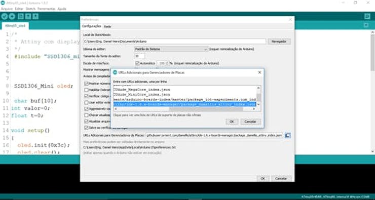

Step 1: Copy the URL below:
https://raw.githubusercontent.com/damellis/attiny/ide-1.6.x-boards-manager/package_damellis_attiny_index.json

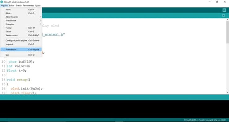

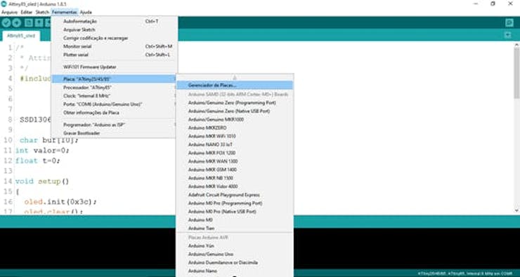

Step 2: Open the Arduino IDE click on Files -> Preferences as shown in figure 2
Step 3: After clicking on preferences it will open the screen of figure 3. In additional URLs, we paste the URL copied in step 1.

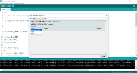

Step 4: Click ok and click Tools and boards and board manager as shown in figure 4.
Step 5: After clicking on board manager, the screen of figure 5 will open and we will type Attiny85.
Step 6: Select version 1.0.1 and click on install, wait for the process to complete, and click on close.
Step 7: Close the Arduino IDE and open it again to check if ATTiny 85 was installed correctly.

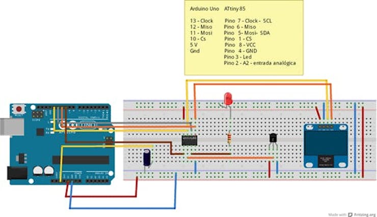

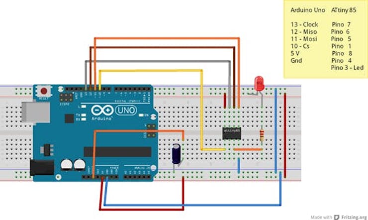

The installation of Attiny on the Arduino IDE has been completed, now we are going to perform the assembly on a protoboard to perform the recording of a sketch blink with Attiny85 first.

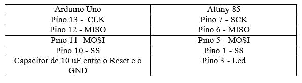

For recording the sketch in ATTiny 85 we will use the SPI communication of Arduino Uno and Attiny 85.
That's why we set up the recording circuit according to figure 7.
Pin 5 V of Arduino Uno goes to pin 8 of Attiny 85, GND pin of Arduino Uno goes to pin 4 of Attiny.
To prevent the Arduino reset while recording the Arduino, we place a 10 uF capacitor between the Arduino reset and the GND.
Table with Arduino Uno connections on Attiny 85.

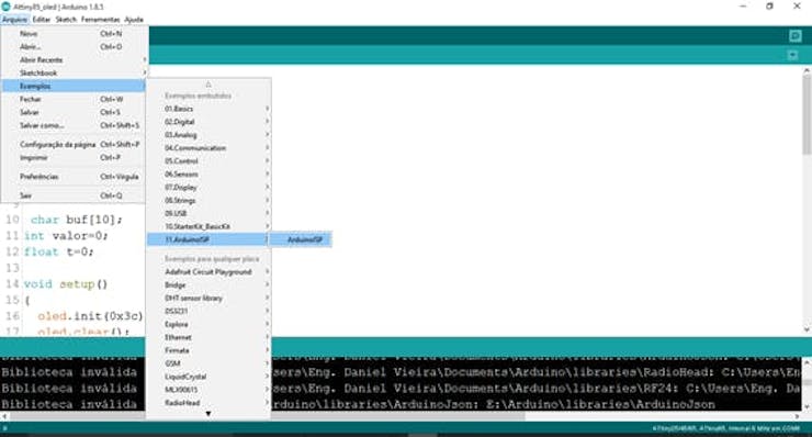

Sketch recording Arduino ISP in Arduino Uno

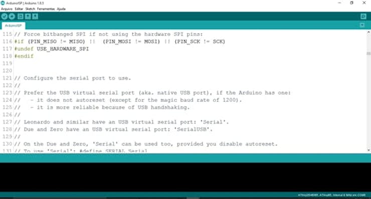

As previously mentioned, we will use Arduino Uno to record the sketch on ATTINY85 through SPI communication.
To do this we will first record the Arduino ISP sketch on the Arduino Uno so that we can use the Arduino Uno as an ISP recorder.
For this, we will follow the steps below as shown in figure 8.
For recording the Arduino ISP sketch on the Arduino Uno you can disconnect the capacitor from the reset pin.
1st: Click on Files -> Examples -> Arduino ISP -> Arduino ISP
2nd: Sketch Arduino ISP
3rd: We recorded Sketch on Arduino Uno.
In the recorded sketch we put the capacitor on the reset pin according to the schematic circuit of figure 7.

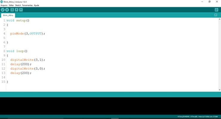

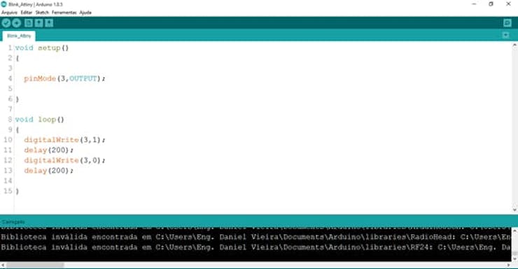

Writing the blink code on ATTINY85

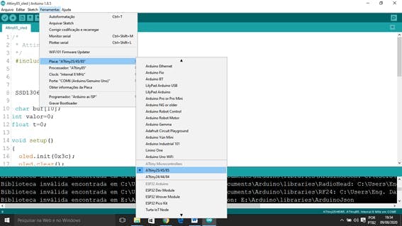

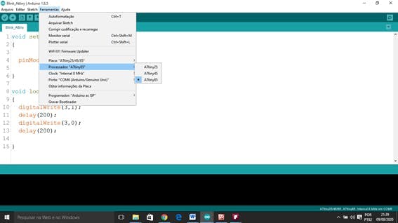

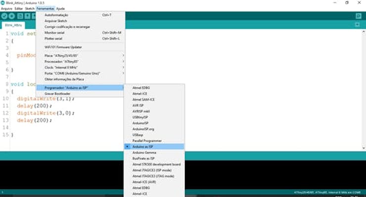

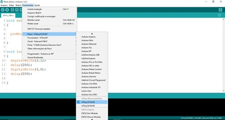

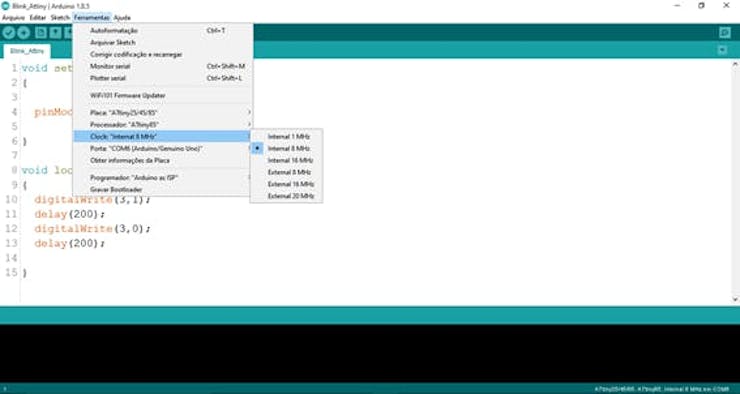

Write the code in the Arduino IDE and we will select some settings in the Arduino IDE as shown in figure 11.
In tools, we select the ATTINY85 board.
We can change the microcontroller clock to 8 MHZ or 1 MHz.
If we change the clock we have to record the bootloader for the clock selected in the options record bootloader.
In our example, we will use the internal clock of the ATTiny 85 microcontroller.
We select the port with which our Arduino Uno is connected.
The programmer selected Arduino as ISP.
Ready, we can perform the recording of ATTINY85 and thus flash an LED connected to pin 3.
After recording, the led will flash every 200 ms.

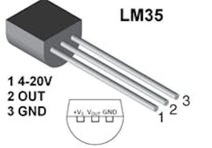

The sensor used for temperature measurement is the LM35, an analog temperature sensor that has a sensitivity of 10 mV every 1 ºC.
That is, for every 1 º that the temperature varies, the output voltage will vary 10 mV at its output.
Pin 1 of this sensor is the positive DC power
Pin 2 - Output signal
Pin 3 - GND negative supply.

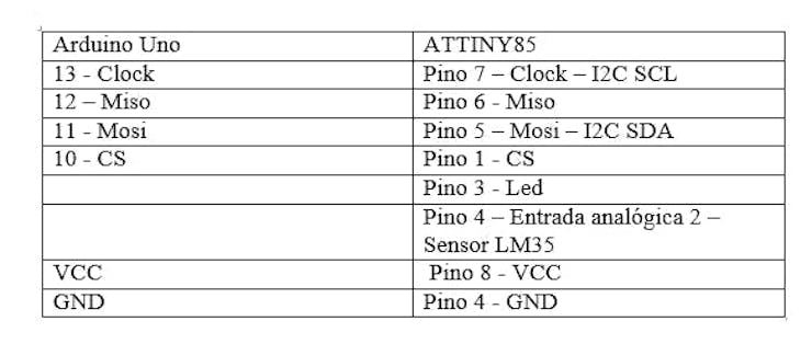

Table with ATTINY85 connections.
The ATTiny 85 pins share other peripherals as well, so pins 7 and 5 are not only SPI communication pins but also have I2C communication.
Not forgetting to put the capacitor on the reset pin and on the GND on the Arduino Uno.

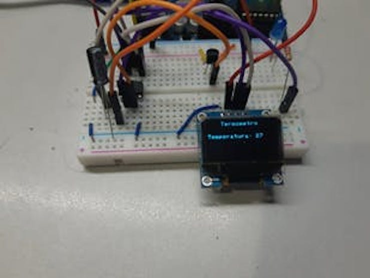

Results
Results
After programming the ATTINY85, we have the circuit in operation according to figure 18.
