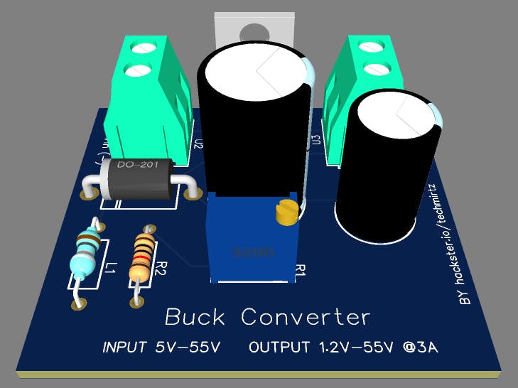

3D Representation of PCB
Follow the below steps to assemble the device at home easily:
