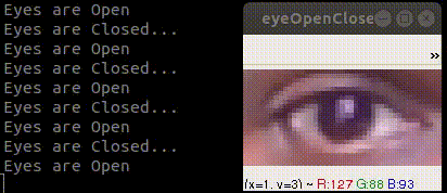

To detect eye winks, it's most efficient to monitor the change in white pixel count around the eye region. But it's not as reliable as monitoring the EAR (Eye Aspect Ratio). If the Eye Aspect Ratio rises and falls periodically then it's a real human, otherwise fake. The rise and fall can be detected by fitting a sigmoid or inverse sigmoid curve.
                                                            Identifying open vs closed eye based on the count of white pixels

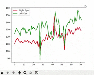

Instead, we can always use Deep Learning or ML techniques to classify an eye image as open or closed. But it's advisable, in the interest of efficiency, to use a numerical solution when you code for edge devices. See how the spread of non-zero pixels in the histogram takes a sudden dip when an eye is closed.
                                                                                   Histogram Spread during Left Eye Wink
We have used a parametric curve fit algorithm to fit a sigmoid or inverse sigmoid function at the tail end of the above curve to detect eye open or close events. The person is a real human if any such event occurred.
                                                 Inverse Sigmoid Curve Fitting: Left and Right Eye Wink
