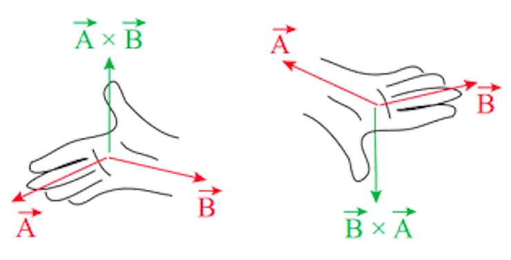

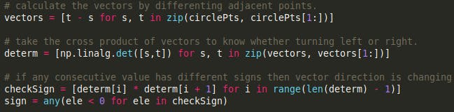

ii) Concavity Estimation using Vector Algebra If all the vectors in the point cloud is concave, then it represents circular motion.
  • Compute the vectors by differencing adjacent points.
  • Compute vector length using np.linalg.norm
  • Exclude the outlier vectors by defining boundary distribution
  • If the distance between points < threshold, then ignore the motion
  • Take the cross product of vectors to detect left or right turns.
  • If any consecutive value has a different sign, then the direction is changing. Hence, compute a rolling multiplication.
  • Find out the location of direction change (where ever indices are negative)
  • Compute the variance of negative indices
  • If all rolling multiplication values > 0, then motion is circular
  • If the variance of negative indices > threshold, then motion is non-circular
  • If % of negative values > threshold, then motion is non-circular
  • Based on the 3 conditions above, the circular gesture is detected.
From the experiments, it became clear that we can use Object Color Masking (to detect an object) and use efficient algebra-based concavity estimation (to detect a gesture). If the object is far, then only a small circle would be seen. So we need to scale up the vectors based on object depth, not to miss the gesture. For the purpose of the demo, we will deploy these algorithms on an RPi with a camera and see how it performs.  Now let's see the gesture detection mathematical hack as code.
# loop over the set of tracked points
	for i in range(1, len(pts)):
		# if either of the tracked points are None, ignore them
		if pts[i - 1] is None or pts[i] is None:
			continue
		# otherwise, compute the thickness of the line and draw the connecting lines
		thickness = int(np.sqrt(args["buffer"] / float(i + 1)) * 2.5)
		cv2.line(frame, pts[i - 1], pts[i], (0, 0, 255), thickness)
	isCirclePts = [p for p in pts if p is not None]
	if (len(isCirclePts) > 30):
		vectors = [np.subtract(t, s) for s, t in
			   		    zip(isCirclePts, isCirclePts[1:])]
		vectors = [vector for vector in vectors
			   			if np.linalg.norm(vector) > 5]
                # To find concavity, check vector direction using Right Hand rule
		determ = [np.linalg.det([s, t])
			                  for s, t in zip (vectors, vectors[1:])]
		directionChange = [determ[i] * determ[i + 1]
				                for i in range (len(determ) - 1)]
		# when the movement of the object is
		# insignificant, consider it stationary
		if len(directionChange) < 10:
			alarmTriggered = False
			continue
