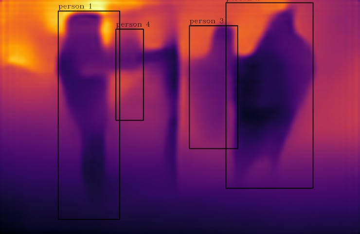

b) Fuse the disparity map with the object detection output, similar to visual sensor fusion. More concretely, find the depth of those pixels inside each object bounding box to compute the median to estimate the object depth.
c) Find the centroid of each object bounding box and map the corresponding depth to the object.

Disparity Map - Object Detection Fusion:
                                                 Only the depth info inside bounding boxes are considered for estimation
