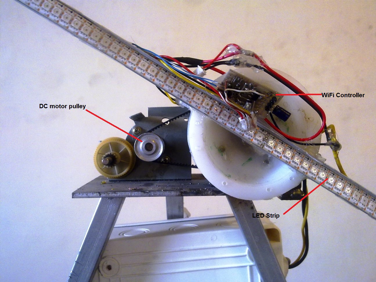

in this project 1 meter of 144 APA102 LED strip used to create motion effect and full color image. each image converted to 200 lines of strip by following java code

after files pixelized then is ready to upload to the Wifi Controller. in the controller code each file read as per pre defined scenario and will display in the LED strip line by line . to keep POV display fix, hal sensor has been used to check whether new rotation completed. we can display each frame in the every beginning the rotation. more detail available in the following code

how to build POV
At first I need the structure to mount POV hub, making the metal or non metal structure is matter of what you have in hands. You can make it with any available material to install it on a wall or add legs to stand alone. My friend makes the simple tripod and mounts the timing belt mechanism to reduce DC motor RPM around 500.
Ideal hub RPM is around 800 and with this RPM each revolution took about 120 ms. my POV has two branches so fps equal around 16 which is little far from ideal 25 fps but the effect quality still good with this setting. My next project will be making POV to show animation and in that case I should use faster motor but let’s put it aside for now.
In the next step piece of PVC cylinder Milled to hold the LED bar.
To connect the hub with pulley shaft one M10 bolt has been bolted to back of PCV part
Two Cupper ring installed on pulley shaft to transmission 5 volts DC to the board and LED strip
For safety power switching installed in sealed plastic box
