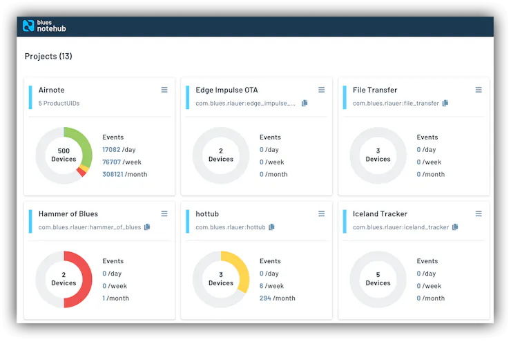

Next up, we can set up a new (free) account on Notehub.io and create our first Notehub project.
This Notehub project is where we will see incoming data from the Notecard, and enable us to send SMS messages with Twilio:

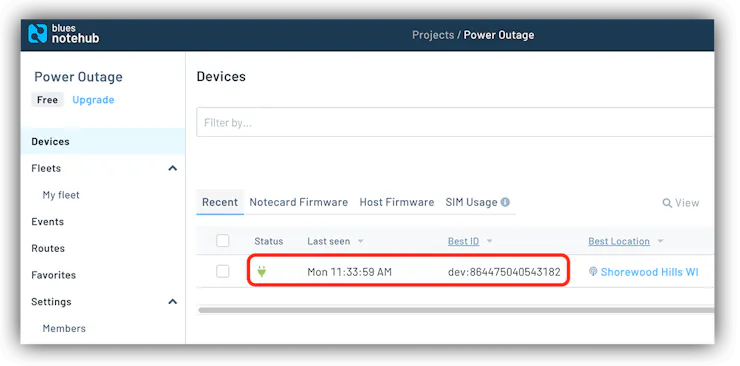

We can then quickly test out the cellular connection by using the hub.sync API, like so:
{"req": "hub.sync"}
In mere seconds, we can return to our Notehub project and see that the Notecard has successfully made a cellular connection:

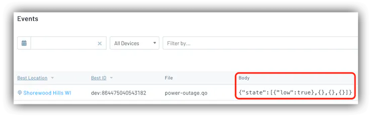

Simply unplug the micro USB cable from the Notecarrier-A. The LiPo battery will immediately become the active power source for the Notecard and a state change on AUX1 will be registered. You may notice the Notecard's green LED light up, letting you know that it's communicating with the cloud and sending a Note to Notehub:
This is great! 👍 In the provided JSON, we're seeing the AUX1 pin state in the array is "low", meaning USB power has been lost:
{"state":[{"low":true},{},{},{}]}
We can also plug the Notecarrier back in to see what a state change event looks like when power is restored:
{"power":true,"state":[{"high":true},{},{},{}]}

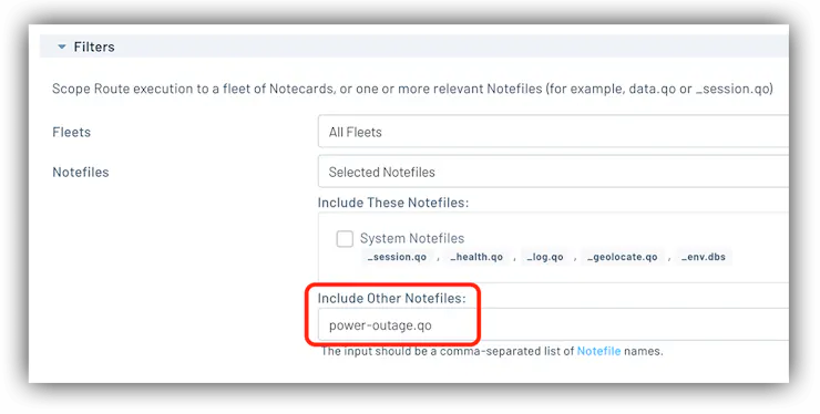

First, let's make sure we only get notified when those power-outage.qo events are sent to Notehub. To do so, make sure to enter power-outage.qo in the field provided when configuring the Notehub route:

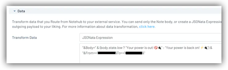

Second, Notehub allows you to use JSONata to transform JSON on the fly. This is outlined in the Twilio guide above, and I'm going to include the JSONata expression that I used:
"&Body=" & (body.state.low ? "Your power is out! 🚫🔌" : "Your power is back on! ⚡🔌") & "&From=+15551234567&To=+15551234567&"
The Body is the body of the text message (using a ternary operator in JSONata to determine which short message to send). From and To are my Twilio phone number and personal phone number, respectively.
This is applied in the Data section of the Notehub route:

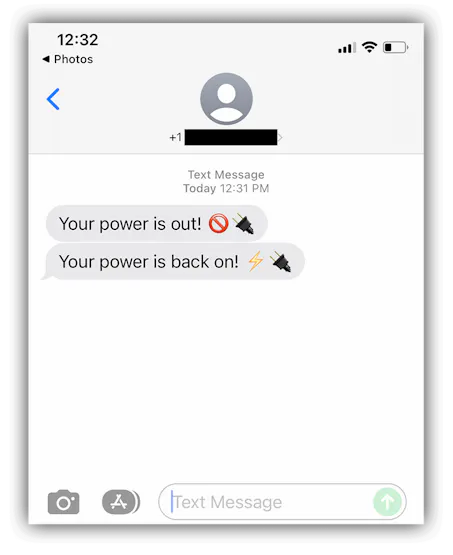

With the Notehub route configured, it's time to again test our setup and this time we should now get a text message within moments of disconnecting AND reconnecting USB power from the Notecarrier:
Great Success! 🎉
