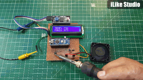

Using the same idea of reading temperature, we can program Arduino to generate a PWM signal. Which then trigger the switching transistor and hence control the fan and fan speed.
Components required:
Circuit diagram:
You can find 2 circuit diagrams here, because most of the students don’t want to use 12c protocol with this. So in the first circuit you can find direct connection of screen with Arduino. The program can be downloaded from here.
The second one is the modified schematics, which use 4 wire 12C protocol to display values on the screen. This will reduce the overall connection and a better method to make a communication between microcontroller and screen.
Here in the circuit, fan speed is controlled using 2n2222 transistor. You can also use dedicated motor controllers but this project is designed according to the consuming current of a CPU fan. From the D11 pin of the Arduino a PWM signal through a 1k resistor is given to base of the switching transistor.

Working:
The temperature controller is working quite fine. As I make the contact of lm35 with heated solder Iron the fan speed is increased to 90% and temperature can be seen respectively to it. Don't forget to claim coupons of $54 from JLCPCB
