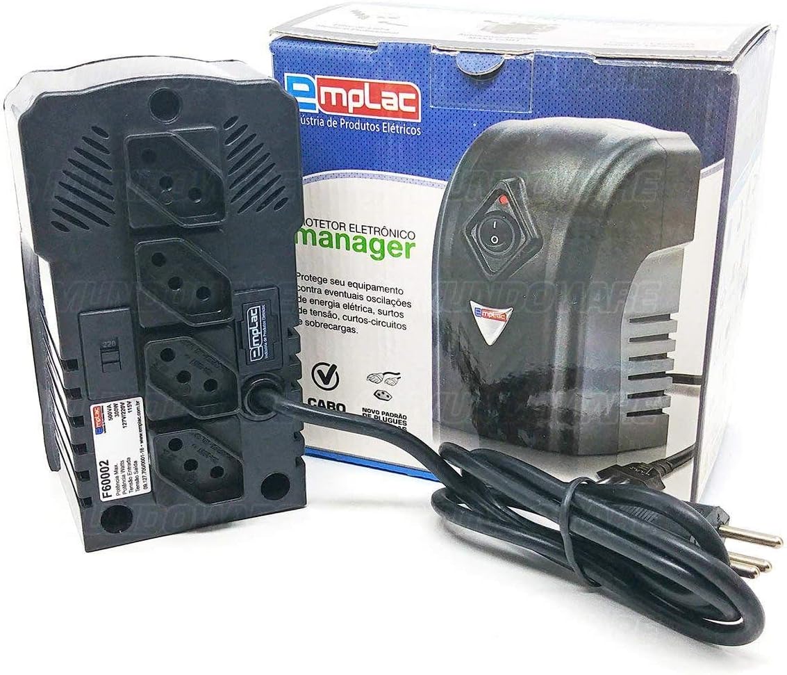

Well, I made up my mind: no unproven designs like the electromagnets made out of electrical transformers sheets.
Electronic protectors have one of these inside themselves, and I found a couple of broken ones in my house.
I took like, two hours and almost bent all of them by simply taking then apart. These are so thin that sometimes they bent by simply falling on the ground.
Still usable tho, but I don't trust myself to build an entire electric motor with high efficiency and power.
I mean... I think I could build one, but a good one? I don't think so.
