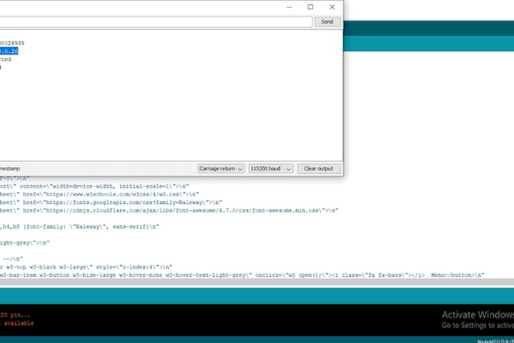

After uploading the sketch, open the Serial Monitor at 115200 baud and press the RESET button on the ESP8266. If everything is fine, it will show the “HTTP server started” message.
