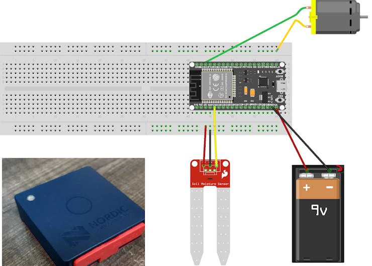

Connect the soil moisture sensor and water pump to the nodemcu as shown below. The main goal of this project is to implement a cost-effective and efficient solution for watering our plants automatically using IoT that uses sensors, Wi-Fi-enabled microcontrollers, and cloud systems. This can be done by sending the soil moisture data to the cloud to be accessed anywhere and anytime. A smartphone or tablet application is also provided to automate the process of watering plants. This device can measure soil humidity/moisture in percentage (%). When the soil is wet, it will have a higher resistance between AO and GND pins, if it is dry it will have lower resistance between AO and GND pins. A TinyML model is generated to water the plants automatically.
Connections:
NodeMCU ------------------------------------- Soil Moisture Sensor
VCC -> Vcc
GND -> Ground
IO32 -> Signal
NodeMCU ------------------------------------- Water pump
VCC -> Vcc
IO22 -> Signal
