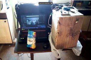

Creating & Deploying the Edge Impulse Model
To create an impulse function, add an Image processing block with a 48x48 image size. Use transfer learning to fine-tune a pre-trained image classification model on your data and save the impulse. Set colour depth to RGB, and generate features to create feature maps. Set training cycles to 80 and use MobileNetV2 96x96 0.35 with 16 neurons as the NN model. Start training and wait a few minutes for the process to complete. After training, find the model's performance and confusion matrix. We achieved a 96% accuracy, with flash usage of 579.4K.
Build firmware from the deployment tab. From the folder and flash it to the board. Run the following Python script to run the classification.

Classification Output
Now the bees can be counted from a new image frame, run through the FOMO object recognition model, and log the bee count hourly. We will be integrating the bee count with the Arduino MKR in the next blog. Thanks for keeping up!
