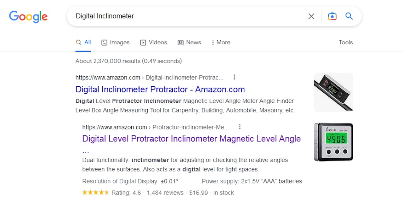

The project is also about designing a real product by yourself, this product is similar to another on the market as the search engines showed.
The project is stand-alone device, inclinometer and display built into the same product.

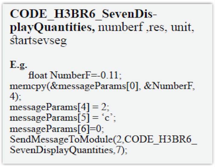

3. 6 Digit Seven Segment (H3BR6x):
H3BR6x is a 6 digit seven segment interface module based on STM32G0 MCU.

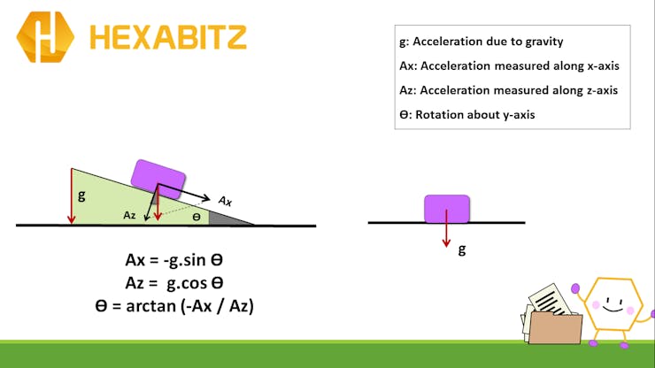

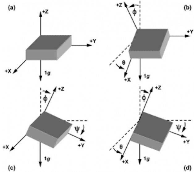

Measure Tilt Angle Using Accelerometer:
The H0BR4x consist of 3-axis Accelerometer with Micro Electro Mechanical (MEMs) technology. It used to detect the angle of tilt or inclination along the X, Y, and Z axes as shown in the below figures.
https://hackster.imgix.net/uploads/attachments/1518171/image_hdG8rNF98y.png?auto=compress%2Cformat&w=740&h=555&fit=maxhttps://hackster.imgix.net/uploads/attachments/1518172/hnjghjg_Hwy1nV9GXR.png?auto=compress%2Cformat&w=740&h=555&fit=max

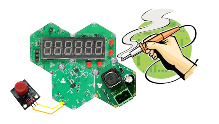

1) Plan the array and assemble the hardware:
We prepare the project components and plan our array design by aligning modules side-by-side. Then we solder the modules together using Hexabitz Fixture.
https://hackster.imgix.net/uploads/attachments/1518191/dfgdfgdsdfsfsdfdsf_HXA9pOvy9Z.png?auto=compress%2Cformat&w=740&h=555&fit=max

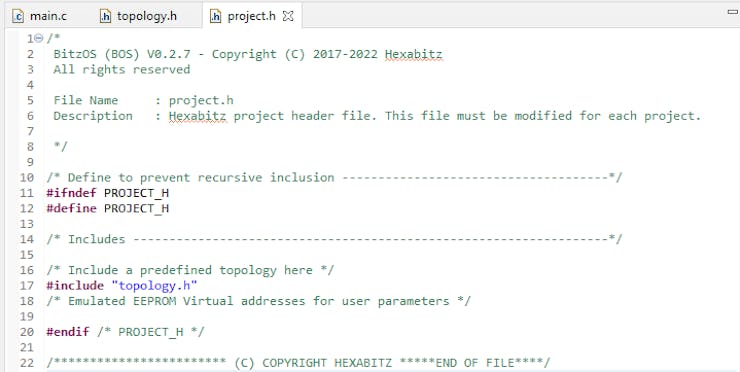

Then go to project.h as shown in the photo below and UN-comment the header.
https://hackster.imgix.net/uploads/attachments/1518193/image_hUvRImEU8u.png?auto=compress%2Cformat&w=740&h=555&fit=max

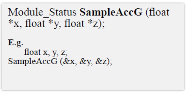

Then we obtain the filtered and calibrated values of the accelerometer in units of g using the following API from the H0BR40 factsheet:
https://hackster.imgix.net/uploads/attachments/1518226/image_PKEwvzXPVJ.png?auto=compress%2Cformat&w=740&h=555&fit=max

while(1){        SampleAccG (&x, &y, &z);        if (button1 == 0){            ang2 = (atan2(x,z))* 57.3;
            memcpy(&messageParams[0], &ang2, 4);
            messageParams[4] = 2;
            messageParams[5] = 'd';
            messageParams[6]=0;
            SendMessageToModule(2,CODE_H3BR6_SevenDisplayQuantities,7);    }        if (button1 == 1){            ang2 = atan2(x,z);            memcpy(&messageParams[0], &ang2, 4);            messageParams[4] = 2;            messageParams[5] = 'r';            messageParams[6]=0;            SendMessageToModule(2,CODE_H3BR6_SevenDisplayQuantities,7);    }

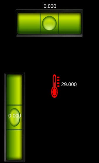

In the future, we are going to build a Digital Inclinometer which can be monitored using an Android application and H23R3(BlueNRG-M2 BLE 5) module 🙂📲https://hackster.imgix.net/uploads/attachments/1518235/1667312783083_NYFCthBsuy.jpg?auto=compress%2Cformat&w=740&h=555&fit=maxThe reason for planning to using a remote display like a mobile phone is that we can monitor the values from IMU without having to look at the hardware, this would come very handy when the IMU is placed on a drone or some other inaccessible locations[4].

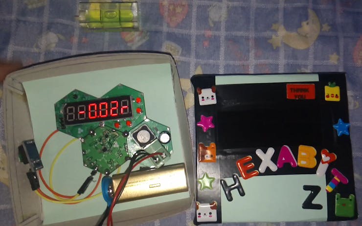

3) Test the System 📉 🧐 📐 🤓 ☑️
https://hackster.imgix.net/uploads/attachments/1518241/rdgydrgtdr_HFYt0hp29m.PNG?auto=compress%2Cformat&w=740&h=555&fit=maxhttps://hackster.imgix.net/uploads/attachments/1518240/dsadadadada_ODr2Hu1Sed.PNG?auto=compress%2Cformat&w=740&h=555&fit=maxYou can use DC-DC power module (H03R0) with 9V battery to power your project. Note that it's better to write the code using power from USB cable connection without DC-DC power module (to avoid power confusion and reset states). Once done, you can insert the batteries and then remove the USB cable.https://hackster.imgix.net/uploads/attachments/1518260/screenshot_-_HX6K1iwSq1.png?auto=compress%2Cformat&w=740&h=555&fit=max

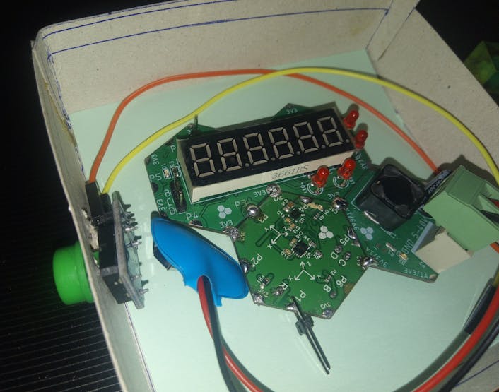

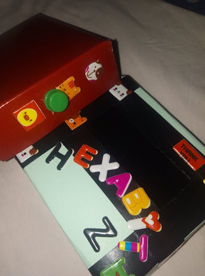

I recycled a paper box to enclosure inclinometer, Because I care to the UN's Sustainable Development Goals (SDGs).
https://hackster.imgix.net/uploads/attachments/1518259/img_20221103_185557_YktZWueZQT.jpg?auto=compress%2Cformat&w=740&h=555&fit=maxhttps://hackster.imgix.net/uploads/attachments/1518257/img_20221103_182453_Gm57N89WQy.jpg?auto=compress%2Cformat&w=740&h=555&fit=max
https://hackster.imgix.net/uploads/attachments/1518256/img_20221104_100323_tLY4SaW6MN.jpg?auto=compress%2Cformat&w=740&h=555&fit=maxYou can now use your project to make perfect shelves.
https://hackster.imgix.net/uploads/attachments/1518254/fdsfsdf_bShiBSXKlp.PNG?auto=compress%2Cformat&w=740&h=555&fit=max
https://hackster.imgix.net/uploads/attachments/1518253/dsdsdadsd_1PentsGlRW.PNG?auto=compress%2Cformat&w=740&h=555&fit=maxhttps://hackster.imgix.net/uploads/attachments/1518258/img_20221103_182502_Itp2vElO0r.jpg?auto=compress%2Cformat&w=740&h=555&fit=maxHappy Doing It Yourself 😊
