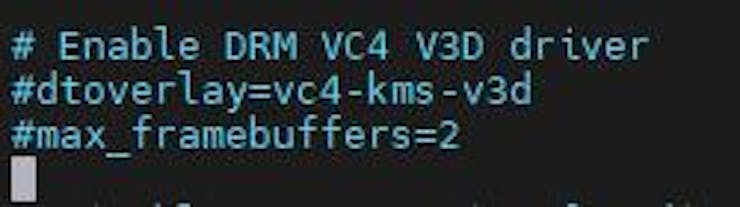

2. Remove the conflicting DRMVC4 statement, type:
sudo nano /boot/config.txt
Delete this section:
CTRL X to exit, Y to save

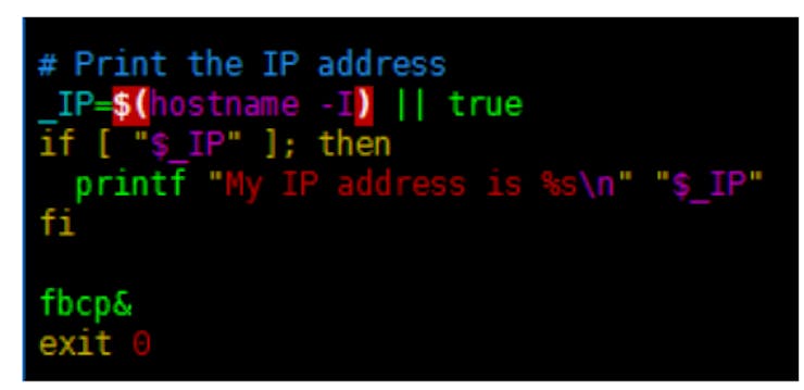

5. Setup this functionality to start automatically when you boot your Pi, type:
sudo cp ~/Waveshare_fbcp/build/fbcp /usr/local/bin/fbcp
sudo nano /etc/rc.local
Add fbcp& before exit 0.
Important: You must add "&" to run in the background. Otherwise, the system may not be able to start.
