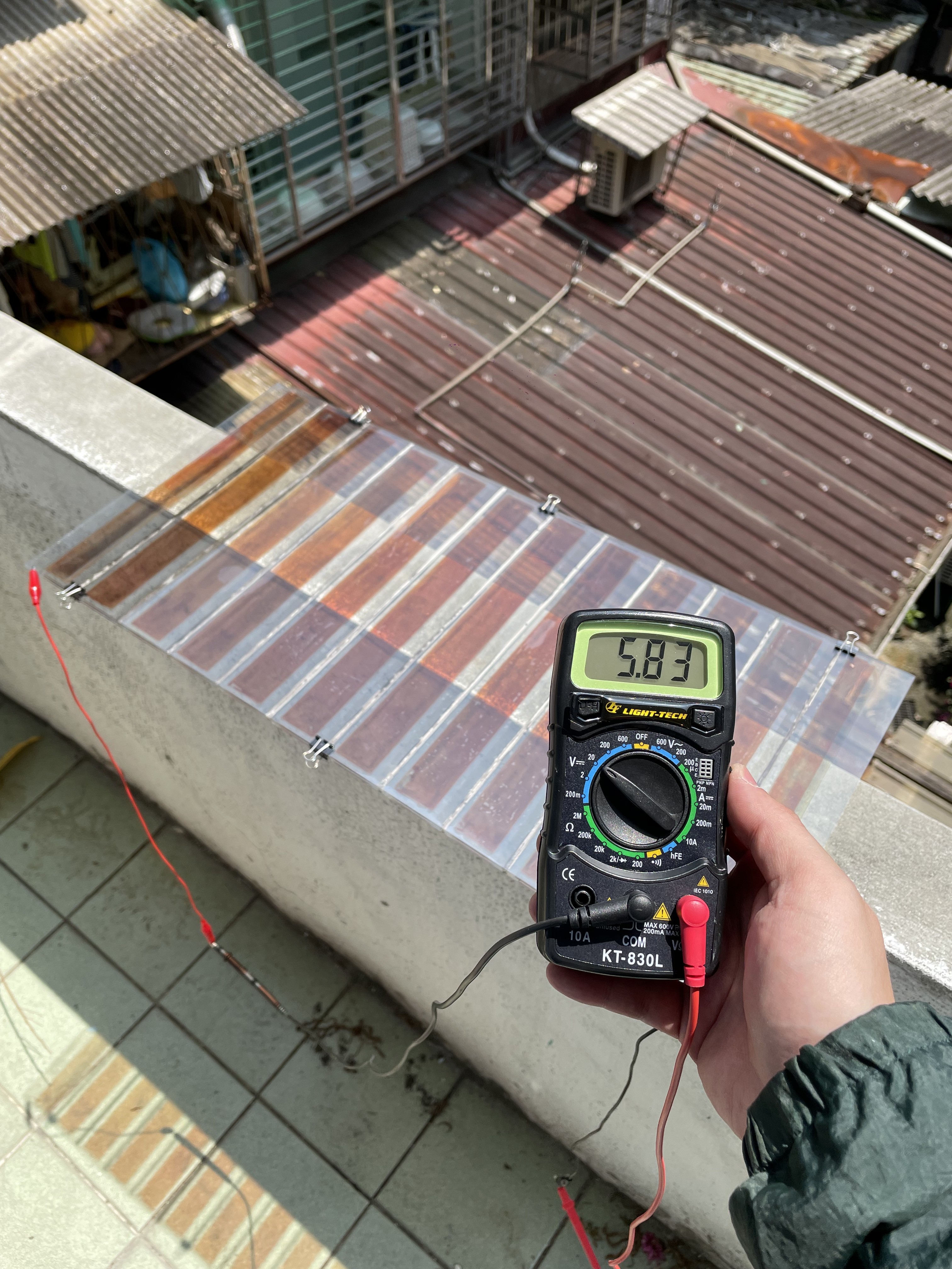

2.1 Measurement
This measurement did not take the participation of the solar simulator but only with nature sunlight at noon in Taiwan. The open circuit voltage and open circuit current are measured as 5.8V and 51mA respectively.
Voc and Jsc measurement of the board.
