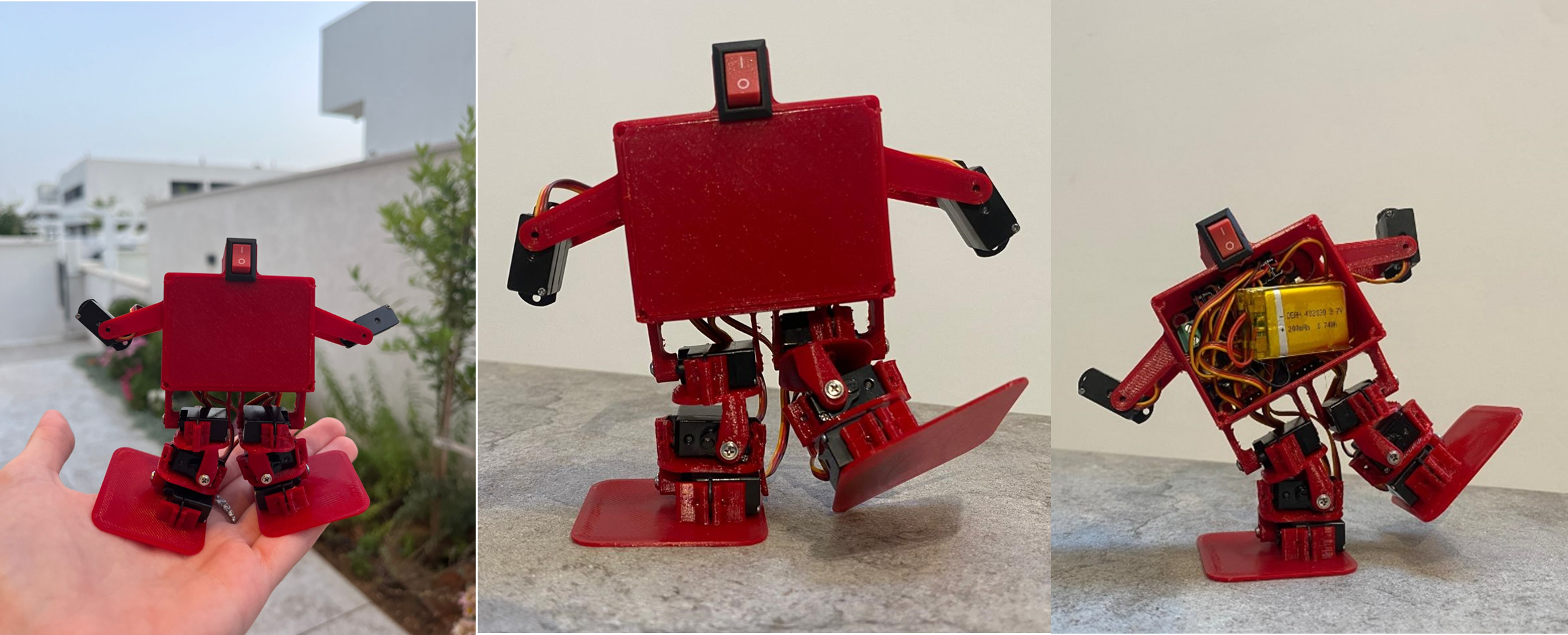

After weeks of hard work and countless iterations, I proudly present my final creation: Tiny Titan. Standing at just 95mm high, Tiny Titan is a marvel of miniaturization, representing the culmination of countless hours of design, experimentation, and refinement.
![](https://cdn.hackaday.io/images/6272501716422773603.png)
Figure 5: Tiny Titan final result
