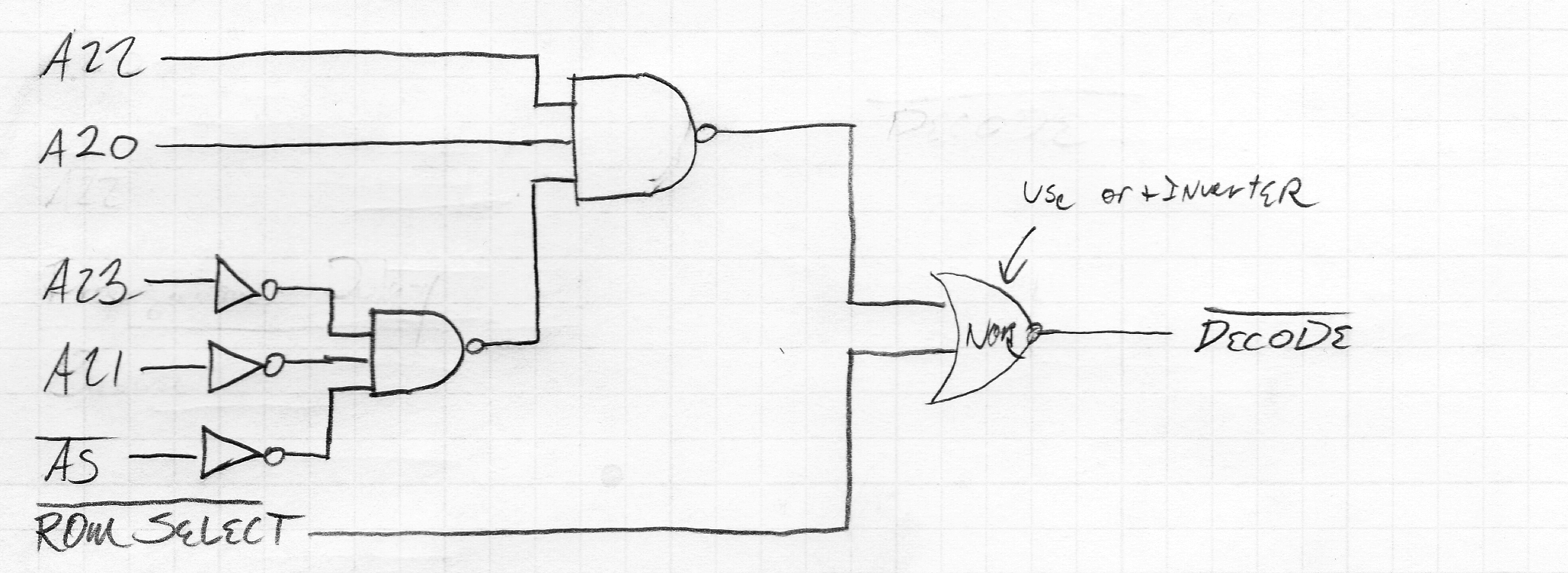

ROM Decoding
According to the memory map I have in my notebook, the 64kB of ROM will be decoded at $500000 through $50FFFF. This means the ROM is selected whenever address lines 22 and 20 are high, and lines 23 and 21 are low. A three-input NAND gate (74ls10) and a few inverters are all that are needed to enable the RAM.
Of course, I'll also need to include the /AS line and the /ROMSELECT line. Easily done.

lennart.lindell wrote 02/18/2014 at 20:59 point
Connect /AS to an active low enable, The same with A23. Then let A22, A21 and A20 go to A2, A1 and A0 on the 74138. Then you have decoded $000000 to $7FFFFF in 8 parts. The /boot is needed on the first RAM only.
Benchoff wrote 02/20/2014 at 22:45 point
Niiice. Good thing I haven't started wrapping the RAM up yet. I'll update my notebook.
